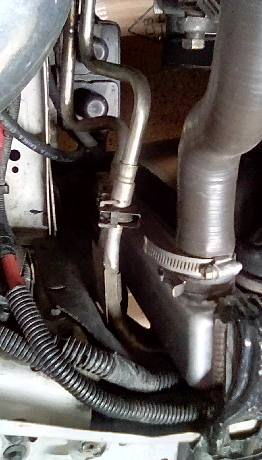

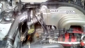

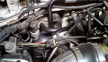

I haven’t had AC on my car in 20 years. I’m putting it back. I forgot the exact routing down the pass side of the car. Since I filled holes, I want to drill any new holes now before the engine is in.
anyone with the ac lines still in place care to snap a few pics of the line running down the pass frame rail to the connection at the condenser?

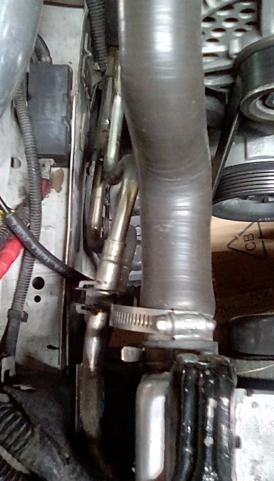

Sorry Mike this is the only one I have on my phone. The liquid line just lays in the frame recess all the way and isn't connected. It won't move. I can get the forward shot tomorrow if that's what you need?

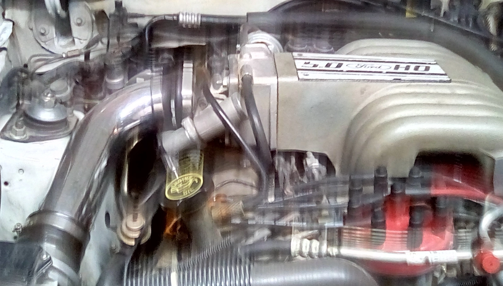

Thanks, that’s actually a pretty helpful shot right there. I just need to see what the two lines do under the alternator if you or anyone else has a shot of that area.

They just turn straight forward. If nobody posts one I'll get one tomorrow.... Now to remember to do it...

Ok here ya go

Awesome thanks! That’s showed me what I needed to see!
