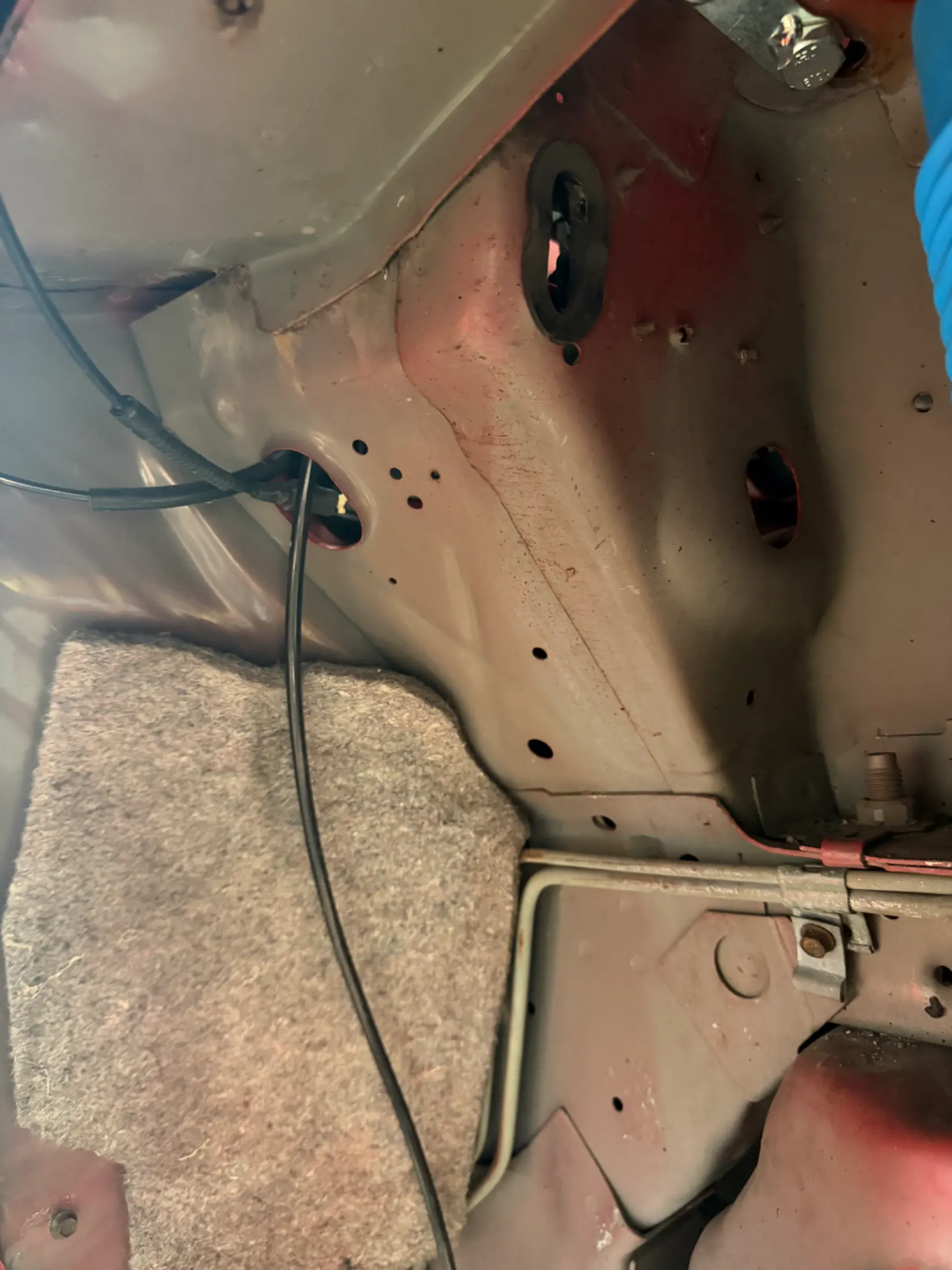

Hi all!

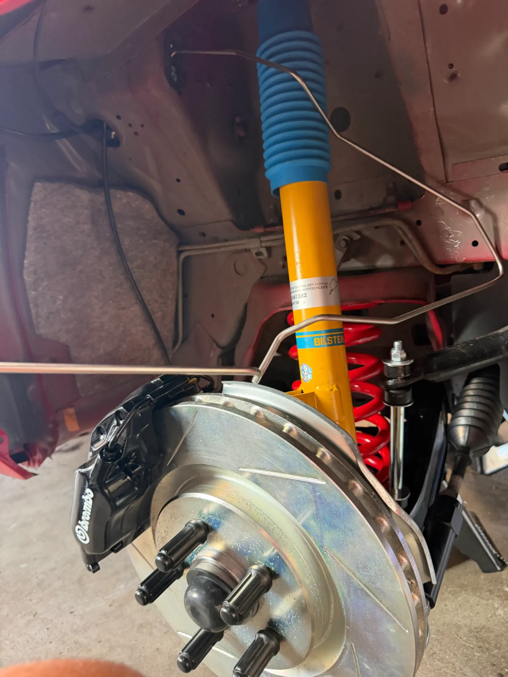

I’m replacing my 1993 front brake hard line (passenger side line to MC) and having a difficult time routing the Classic Tube pre bent line through the wheel well and into the engine bay.
Should I feed the tube from the engine bay down into the wheel well or start from the wheel well?
Any advice you might have in getting this tube in place is greatly appreciated!!

I just put the passenger brake line back in my son's car a couple months ago. I fed the line from the engine bay down through the hole you pictured. The bigger challenge I found was routing it under/around the brake booster (booster and MC were already installed in the car). I had the engine out so that made it easier as well. Not sure how disassembled your car is at this point.
If you have to bend the line slightly to get things to work, its not the end of the world, just bend carefully so as to not kink the line.

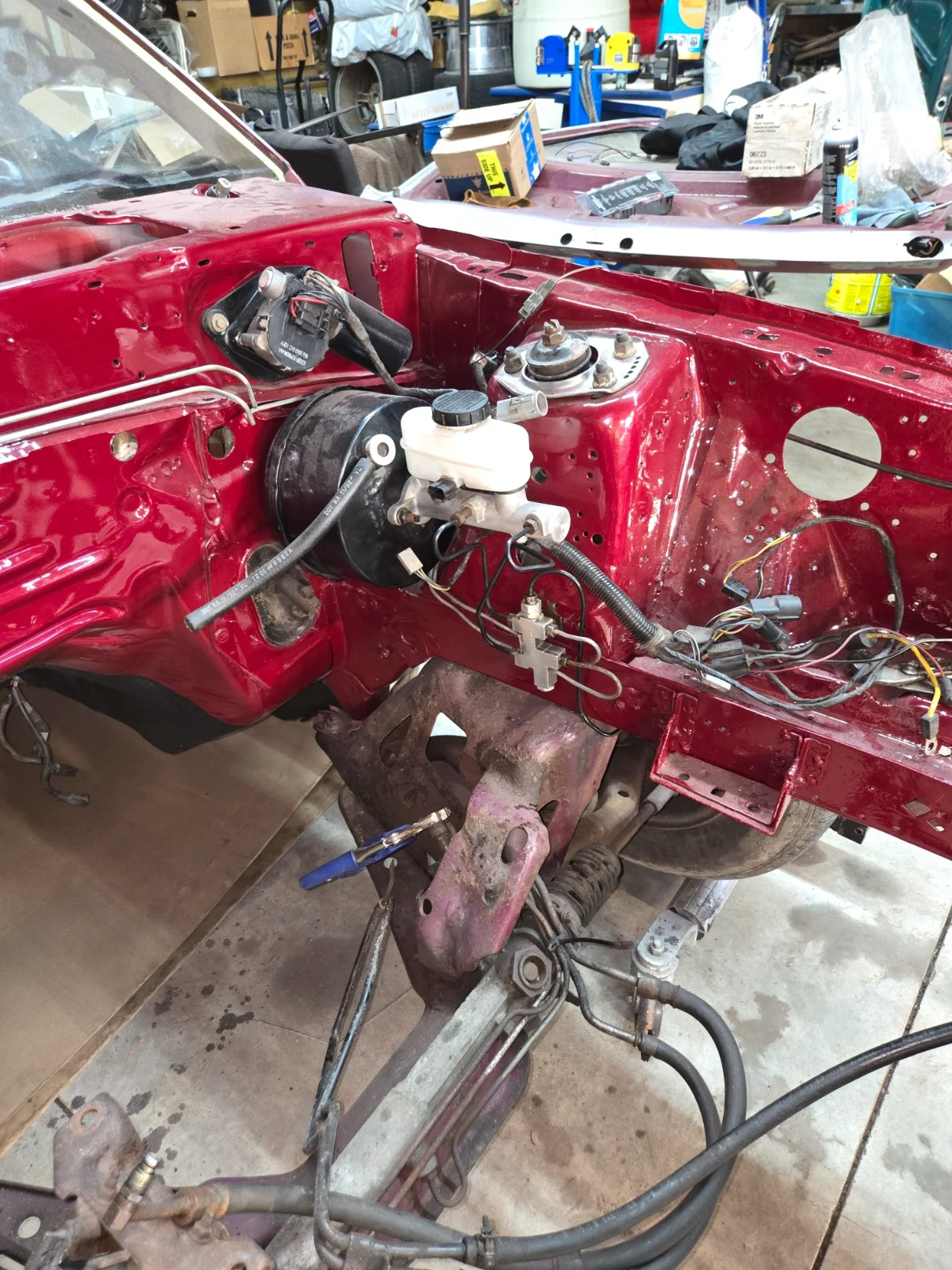

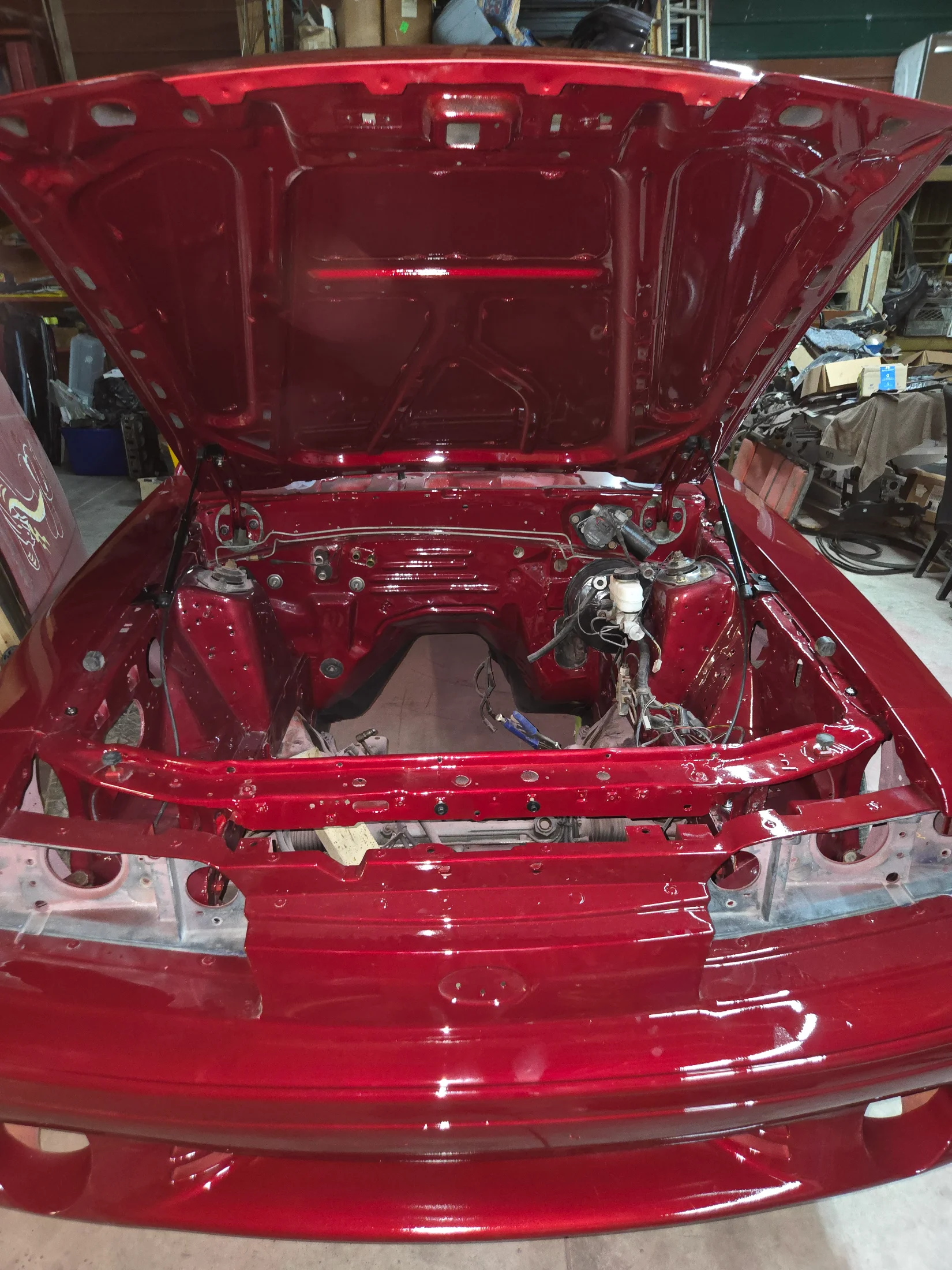

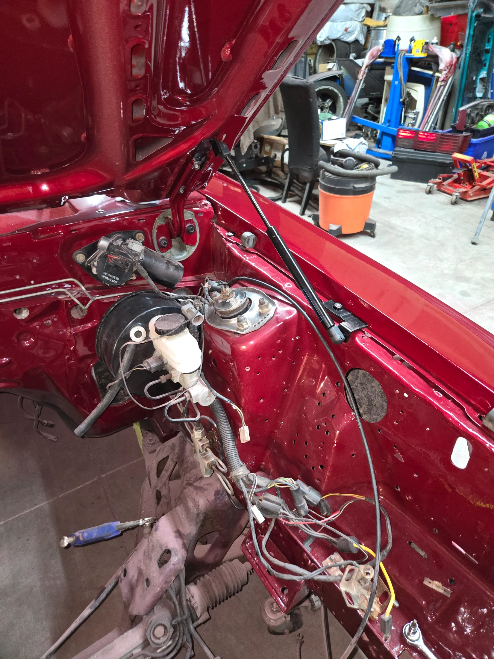

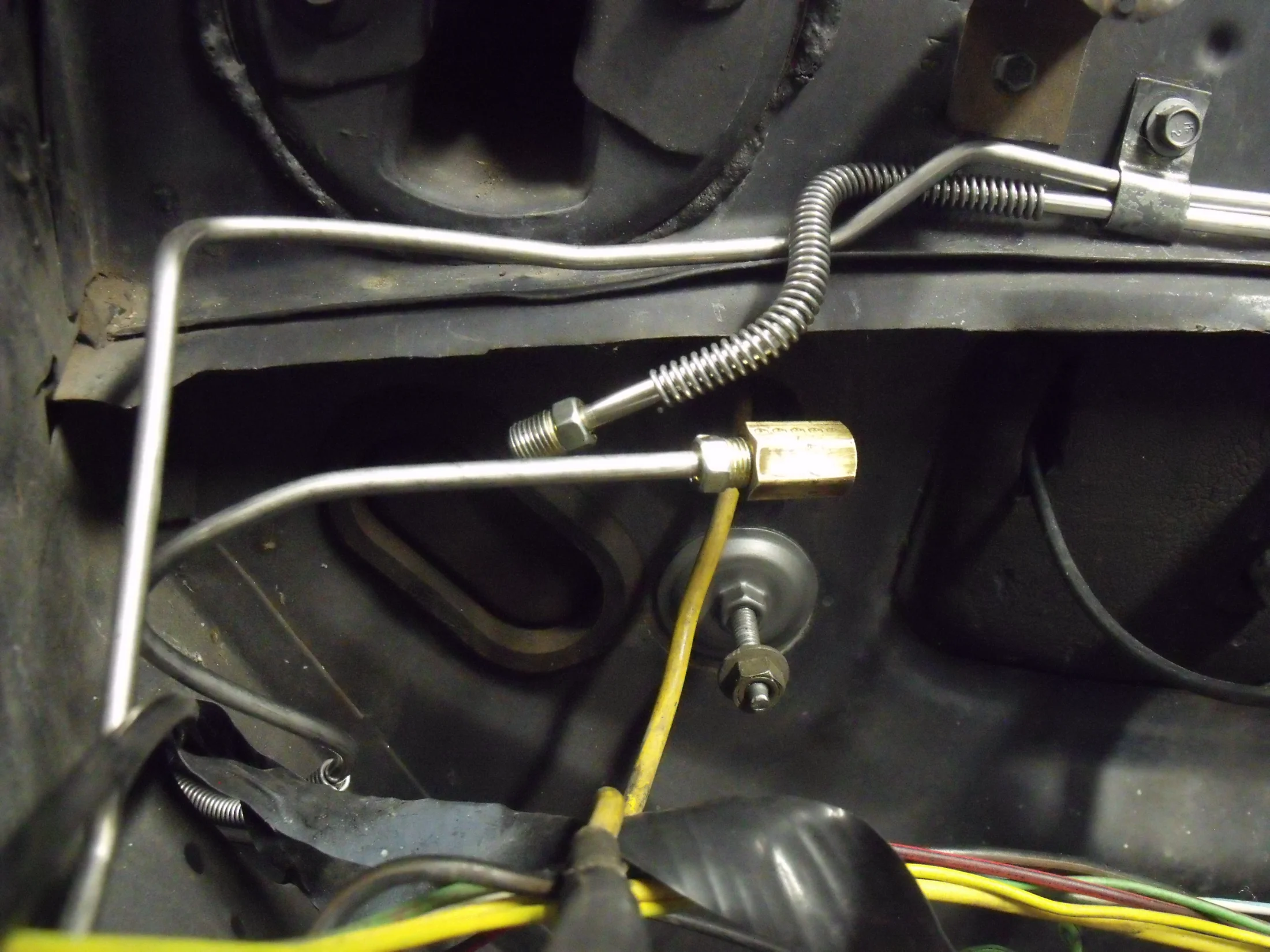

I don't remember exactly which way I did it, but looking at how the line goes over the booster and back under the MC to get to the prop valve my thought is to slide/hook the driver side down in between the MC/booster and inner panel on driver side until it comes out underneath. Then lay the line down across the engine bay and route the passenger side through the hole down to the brake hose mount (some bending here may be required).
See how the line goes over the booster and comes out under the MC

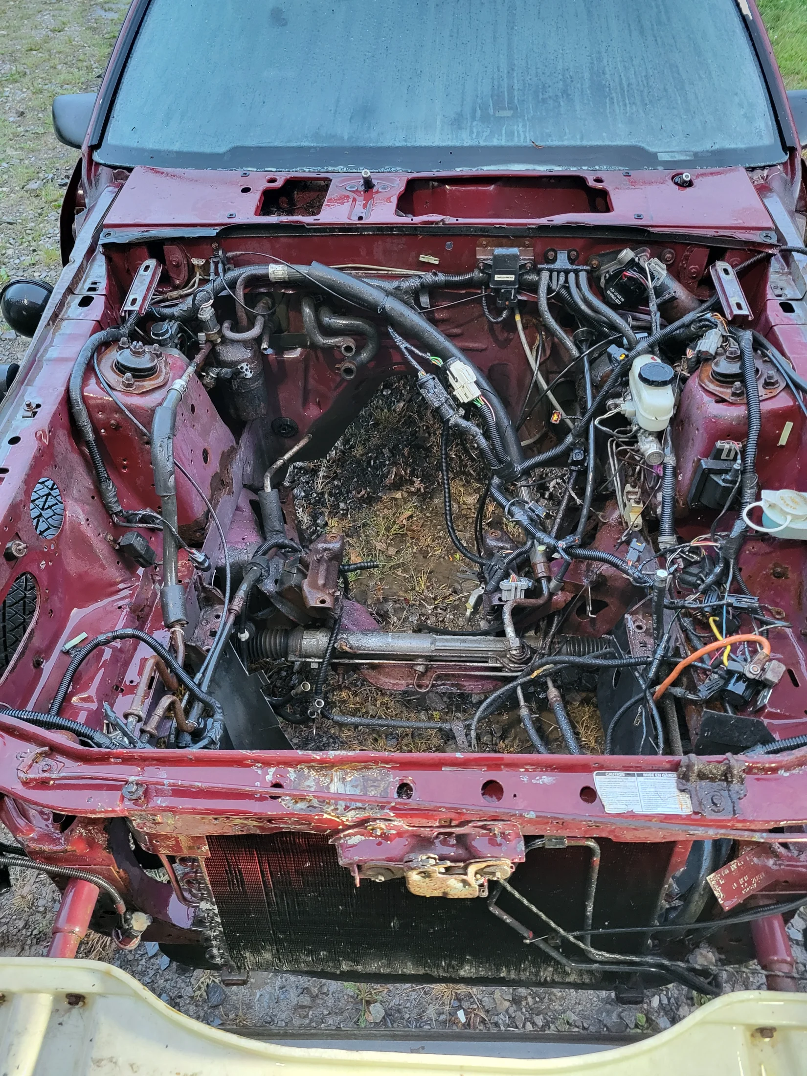

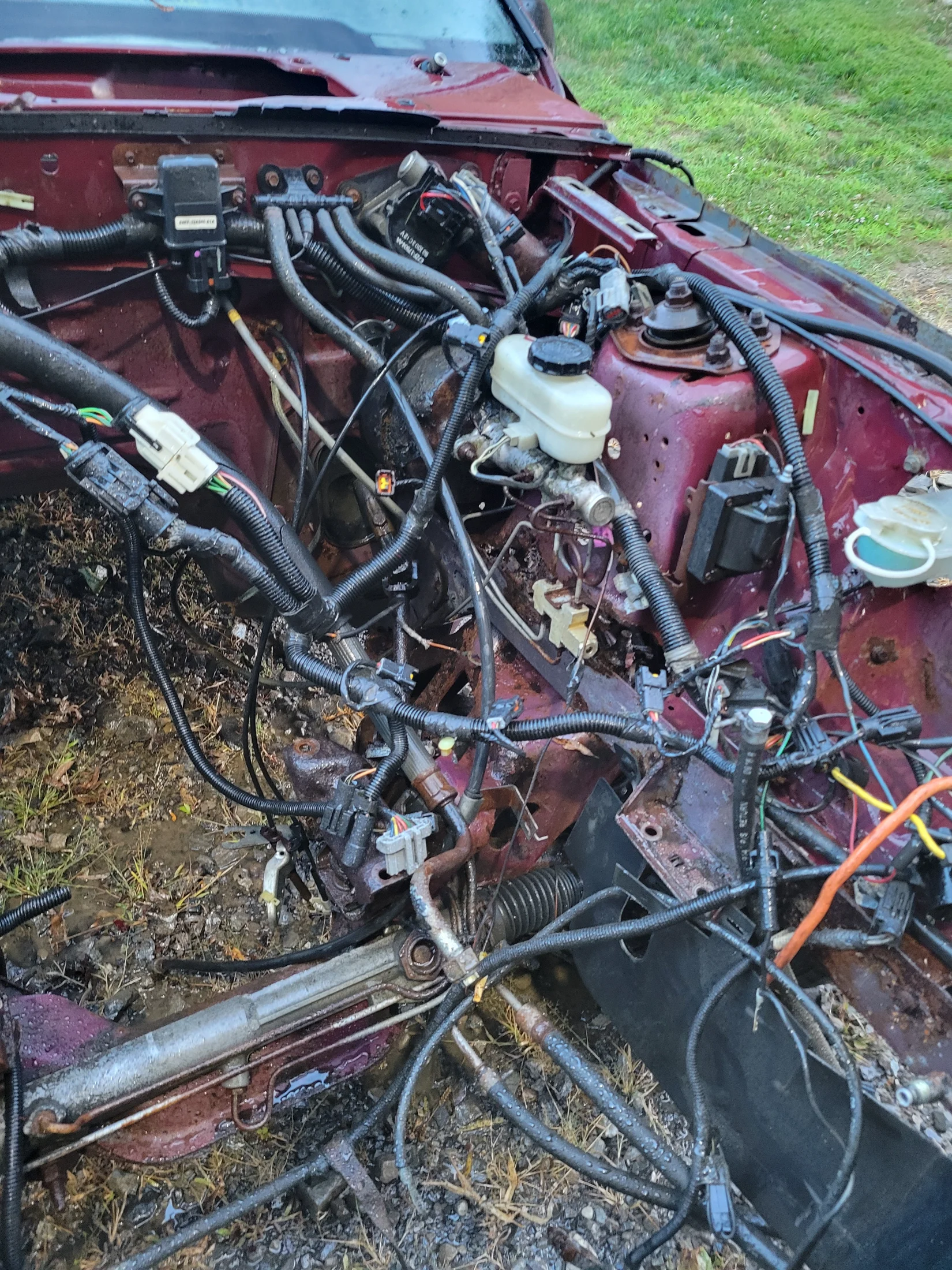

Pics from before disassembly...

Awesome detail, thank you for providing these pics. I was able to get all the lines routed! Some bending required at the passenger side for sure!
