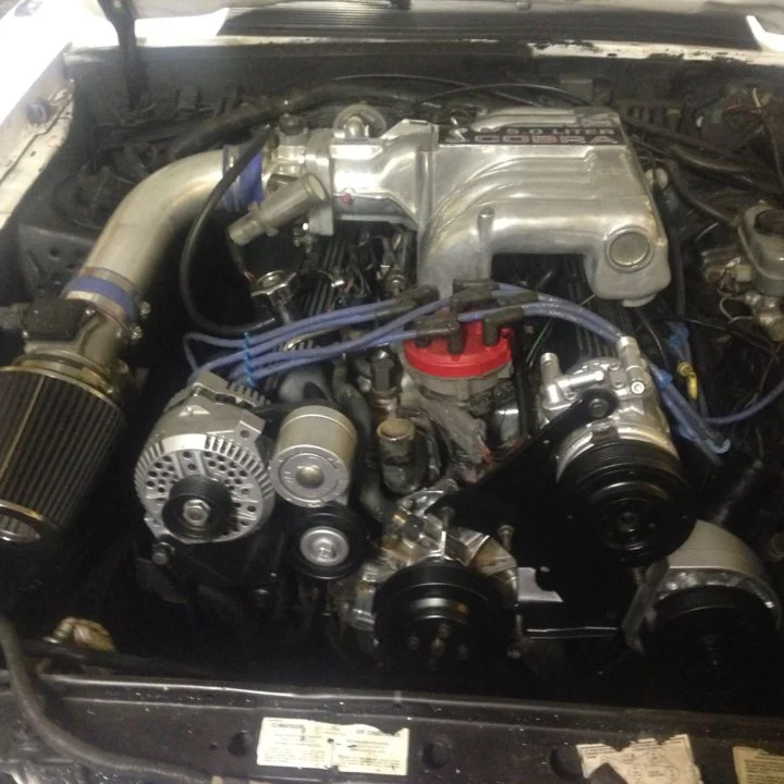

Ok, chasing down a leak in my ac system. The two lines that go into the compressor with the big nuts, do those have o rings or simply pressure fit? Thanks!
Right now checking for leaks is not really an option. Everything was coated in grime from the previous owner so I actually have all the accessories and brackets pulled along with the ac system To get cleaned/painted. I'm replacing all the o rings while I have it apart. The fittings on the compressor it's self, I think they are called manifold fittings. I know they have the 2 o rings between them and the compressor, but what kinda deal is used on the hoses? I don't see where a o ring would go.
There should be lips on both lines that plug into the compressor manifolds. The o-rings are in between that lip and the manifold.
Here is the oring kit for the compressor (front parts). Compressor Shaft Seal Kit
Can you take a picture to make sure we're referring to the same thing?
On top on the compressor.. The two lines that have the large nuts, one goes to the dryer, one goes to the condenser. What lips/rings/seals go there.
Not looking at the front of the compressor yet.
If you do, they're not all equal. The reman I bought leaked right after a year. It was also shimmed incorrectly. Costly/time consuming when you have to redo an ac system twice.
Take it to an ac shop and get a few quotes. See how that compares to doing it yourself or taking chances with a reman. You need to replace the dryer and orfice line too. Plus a flush to cover your ass for warranty. Where are ypu located?
