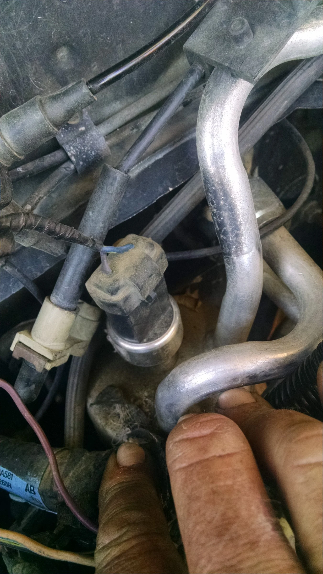

The accumulator on the pass firewall has a pressure switch on it that you can unplug and jump out. This will fool the compressor into engaging when you turn the A/C on. This should allow you to charge the system.

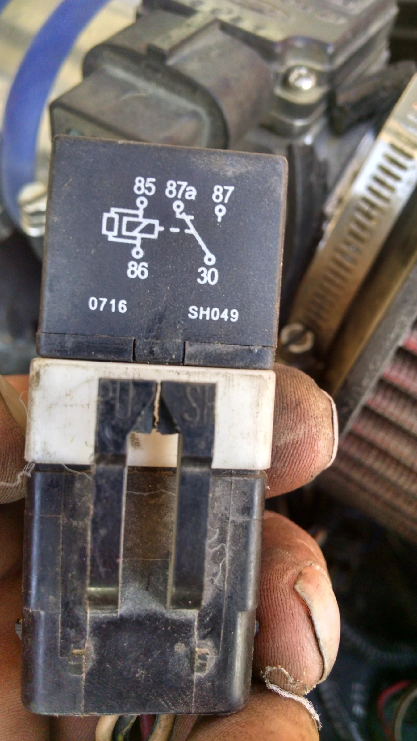

I have an 88 Ford Mustang with 92 upgrade
I tried to charge the air conditioning and couldn't get the compressor to come on
not the first time down this road I quickly pulled the low pressure switch and jumped it with a paperclip
The low pressure switch is mounted on the passenger side firewall if you trace the air conditioning lines back to that side you'll most likely find a switch with a couple of wires
When I jump the wires it would only come on for about 10 seconds on further inspection of the relay that runs the AC I discovered the previous owner had the wrong relay in it my car requires a relay that switches power from 87 to 87a on the relay wiring
