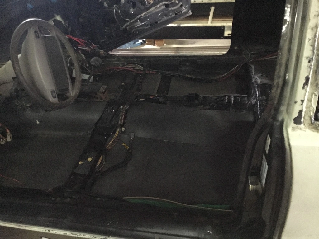

I did my car, floor, firewall, roof, doors, trunk, dash, center console. I have a serious sound system though, and I had zero concern about added weight. It made a huge difference. Road noise was reduced, random vibration noises nearly stopped, also a very noticeable reduction on the amount of heat I would feel through the trans tunnel on a hot day.

I did a previous car with stinger roadkill. It was my DD for a while and was so noisy inside you couldn’t even talk on the phone.
The installation of the deadened was such a massive change that it forced me to start chasing small squeaks and rattles inside the car because it was so quiet. It was amazing.

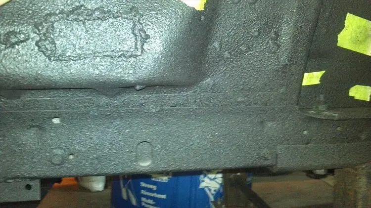

In the scenario of just simply "better" you can run a good sounddeadener with just 25% coverage, and achieve way better results than stock. It's just how you place the tiles and padding. My interior is overkill as I'm also a audiophile, and want my times in this car to be pure enjoyment. So yeah I went way overboard than I needed too. If you have the time, and spare change, do atleast a Por15 coating underneath. Then add a MLV(anyone of choice) with the mass backed carpet. It will be leaps and bounds better than stock. You'll thank yourself later. Post up which ever way you go. Would definiitely like to see the results.
