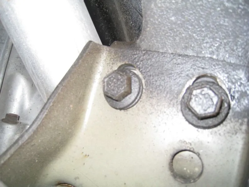

I looked at the bolts in the K-member and it was obvious it moved.
The rear holes in the K-member are slotted and it was pushed back all the way on
the passenger side and pushed all the way up on the driver side.
Tomorrow I will try squaring up the K-member.
Over here in Bahrain, the mechanics are somewhat shaddy, most of them do an alignment without a computer. After I think I have everything set right, I'll find a place that does use a computerized alignment.

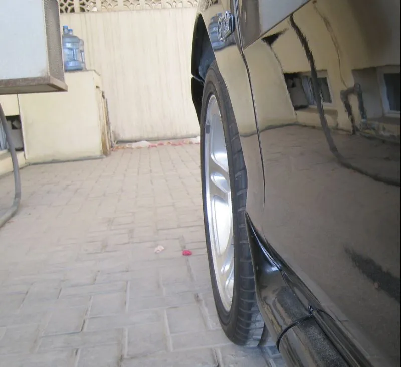

I added a pic of the K-member bolt on the passenger side, and a pic of most of the damage

is the tire still sitting like it is in that pic?????????????
that is at least 3* negative camber!!

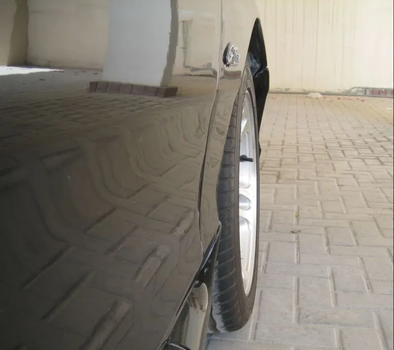

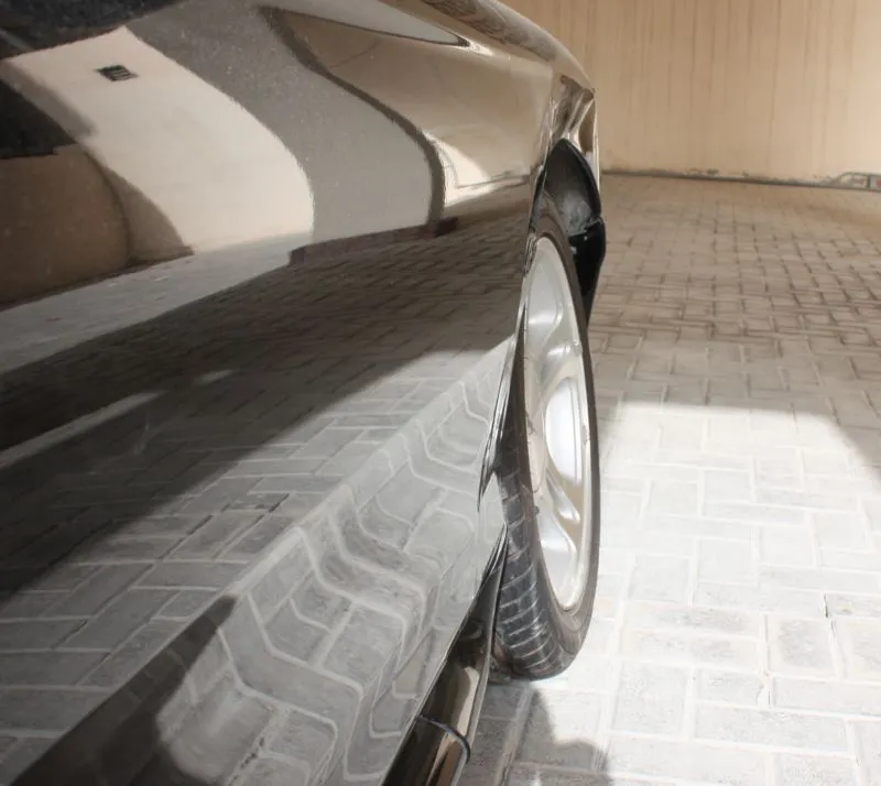

The wheel isn't that bad right now. They tried to adjust the alignment and that's the best they could do. I actually won some of the BBK Gripp caster camber plates on Ebay, they are used but look fine. I probably won't see those for 10 days though, I am living in the Middle East right now. I'm also looking at buying a caster/camber gauge.

I'll take a pic of the way the wheel sits now.
I managed to push the K-member on the passenger side up maybe 4 or 5 mm.
I haven't drove it yet though. I wanted to push the driver side back some, but I couldn't find a
place to wedge a pry bar in. It's only easy to move it forward. On the driver side I can see the slots for the 2 rear K-member bolts, and the K-member is as forward as it can possible get.

wheel looks better. just post or PM me the specs after it's finished
