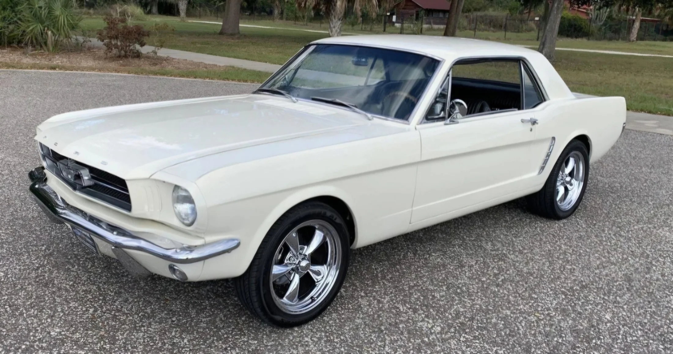

I've watched a few videos on camber and caster. I don't have it fully absorbed in my brain yet, seems a bit confusing for now, but I'm trying to learn as much as I can. I've always been one of those people that learns as I go. I don't have any mechanic schooling, just what I've been able to teach myself over the years. My Mustang is a true 1964.5 (build date 6/20/1964) The previous owner spent 6 years restoring it, nut and bolt. He even used to wax the undercarriage. However, since I live in Clearwater Florida, the heat dried out the ball joint boots over the years, which is why I had to replace them. Here is a photo of it.

Sweet, love the wheels. Mine was white too, had AC and some gauges
Didn't care or know much at the time and like a dumb arse, I wrecked it
Made out alright though, sold it to a guy "Mustang Andy" a local collector
Told me the gauges were worth more than the car at the time, that and the AC
