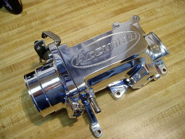

Hey Go With the Accufab products they are much more attractive and most of all better flowing (more CFM's) than C and L. I have the Accufab plentum with the 70mm TB and they are nice products. I have just read in MM and FF the July of 2004 edition, the article on Upper intake plentum and TB swaps, and that the Accufab plentum and 70mm TB have the most gains on a N/A 4.6. My only advice when installing is make sure all the hoses are tight after your done!

if you're getting the accufab....get the 70mm...they make a little more power on a bolt-on GT....the install was pretty easy...my tb and plenum came together so all i had to do was remove the stockers and replace with the accufab unit...20-30 min install...and it looks pretty good too...

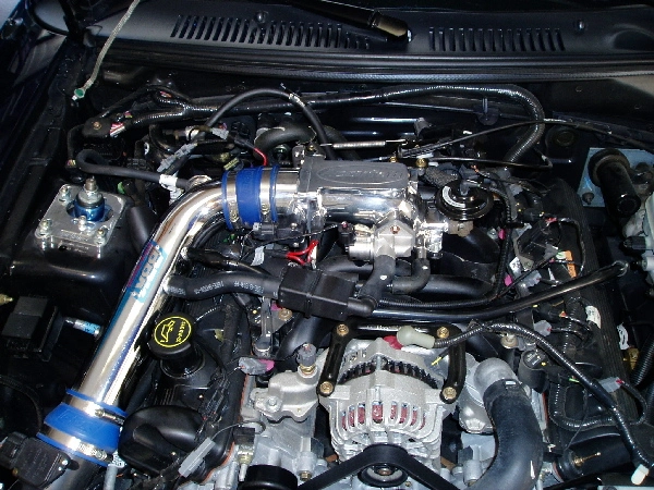

Check out mustangtuning.com they have good prices and free shipping this where I got mine from. Sometimes they will give you a discouont if you mention stangnet in the coupon code. I love the look and performance of my Accufab TB and Plenum take a look at my pics. :nice:
