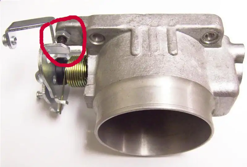

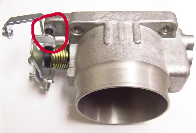

Hey guys,
I FINALLY got around to installing the TB & plenum again. It turns out the initial problem was a vacuum leak somewhere. I also adjusting the idle set screw so it is backed out 100% all the way. This fixed how long it took for the rpm to drop back down to idle (it no longer hangs). On the first install, I had it adjusted forward maybe 25%.
(not my image, but for those that don't know what I'm talking about).
I notice a small power improvement too. When I punched it from a roll in first gear before the install, the tires would just slip alittle. Now, the tires slip alot more (same tires, worn the same amount) almost like reving up in neutral and 2nd gear pulls harder too. I didn't notice much improvement on the throttle response which most people claim is improved significantly.
Hope that helps for anyone in the future if they search this thread.
Thanks guys!
