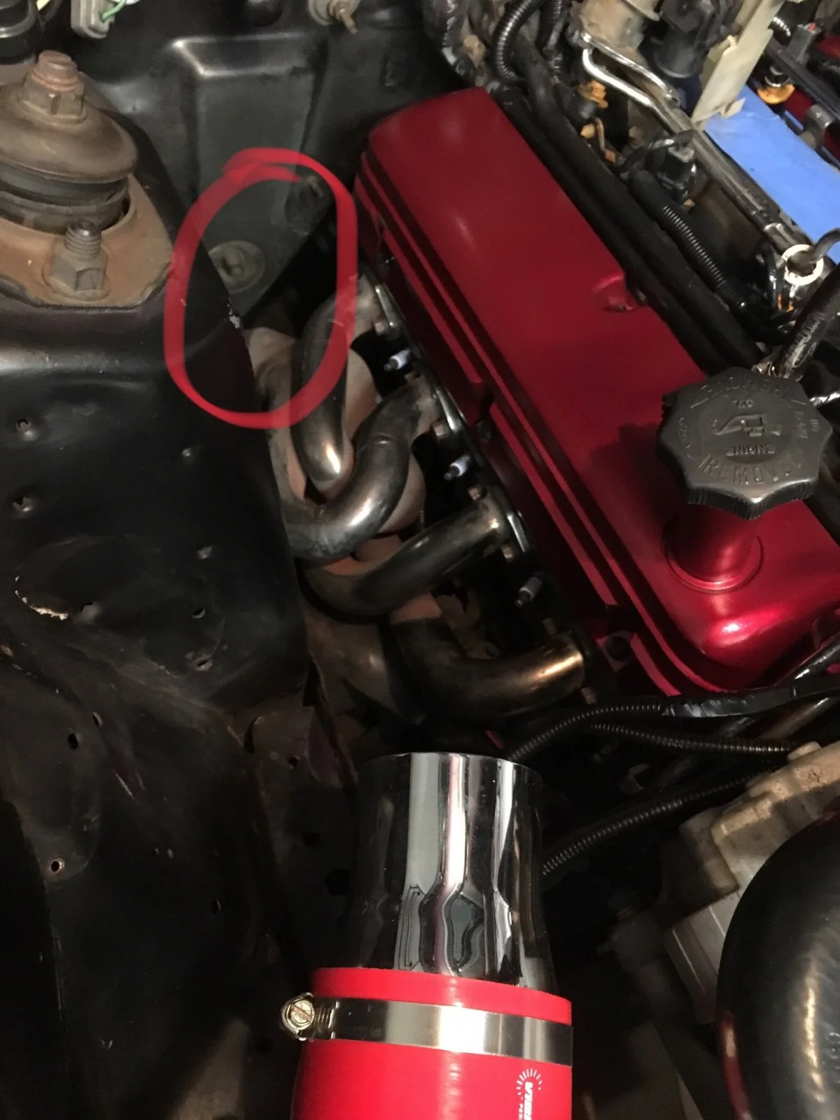

Would any one have a diagram or pic of where its located all ive managed to do so far is scrape up my hand feeling around for it

Here’s a pic of the drain. My AC and smog are gone, so it’s easy to see here, but this should get you in the right spot.

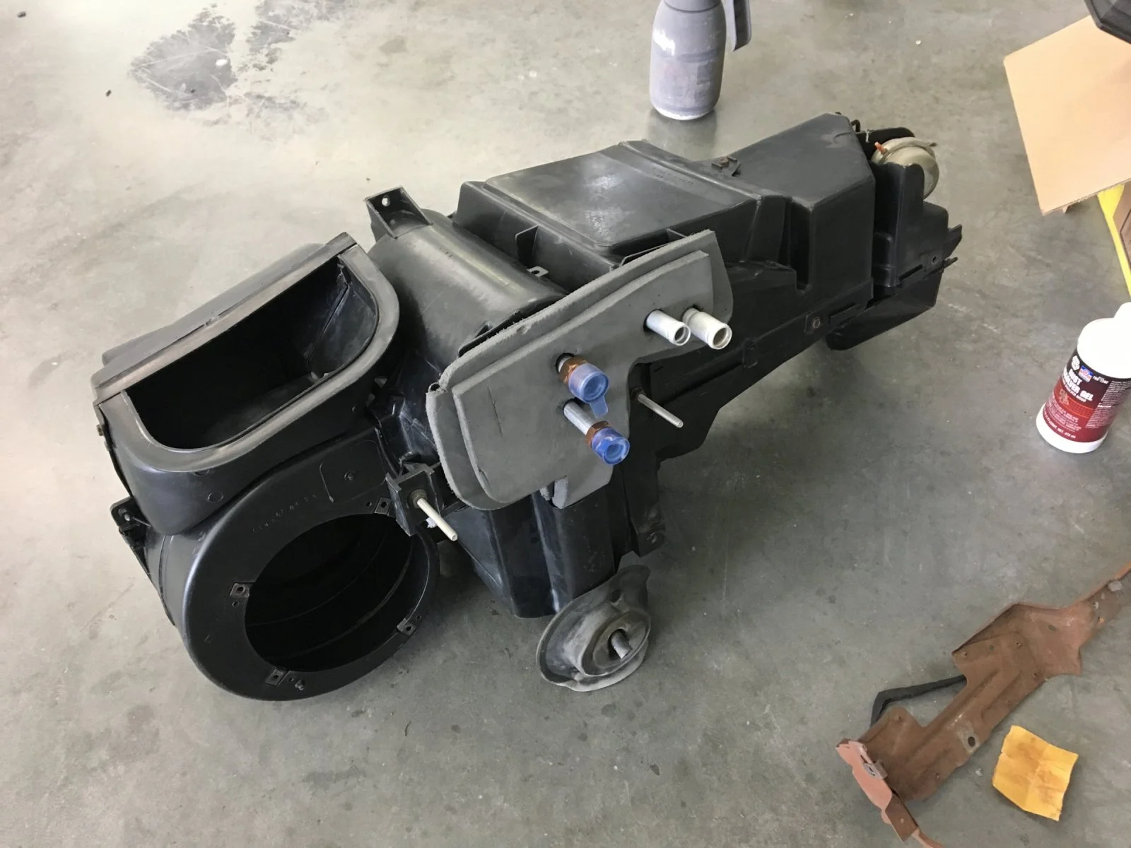

Good lord it took me a long time to find this picture from when i redid my hvac box.
you can see the drain tube below the inlet of the ac condenser.
