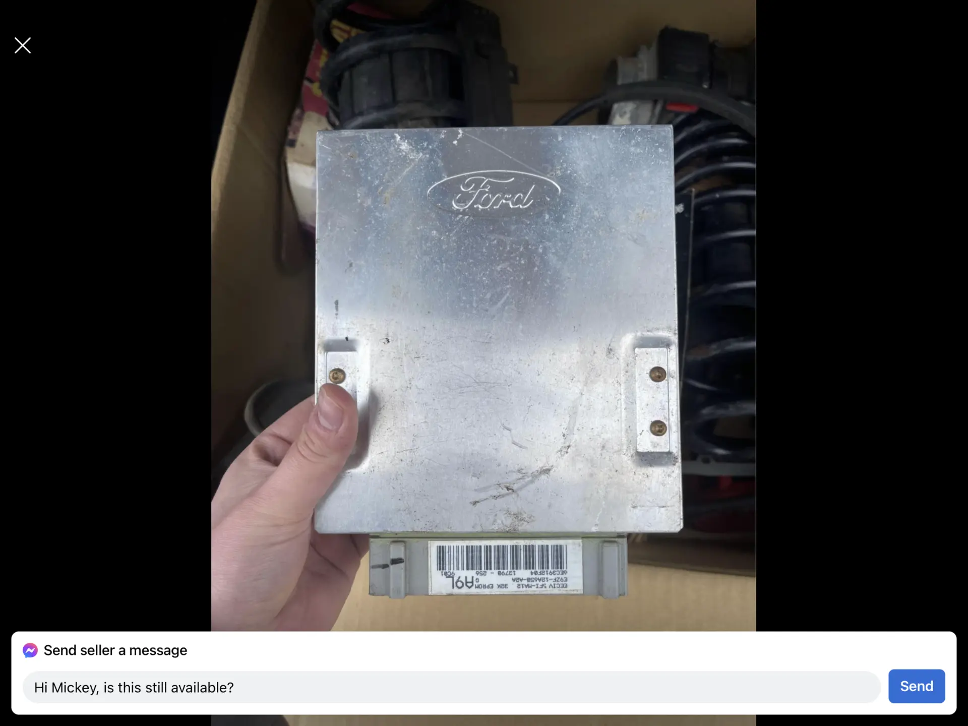

I’d love to do a cam too, but it seems as soon as I bought this, the cheap A9L supply vanished, and now it’s $500 for one that may not even work right.
Then there’s the aftermarket ECU, which is a possibility. Who knows.

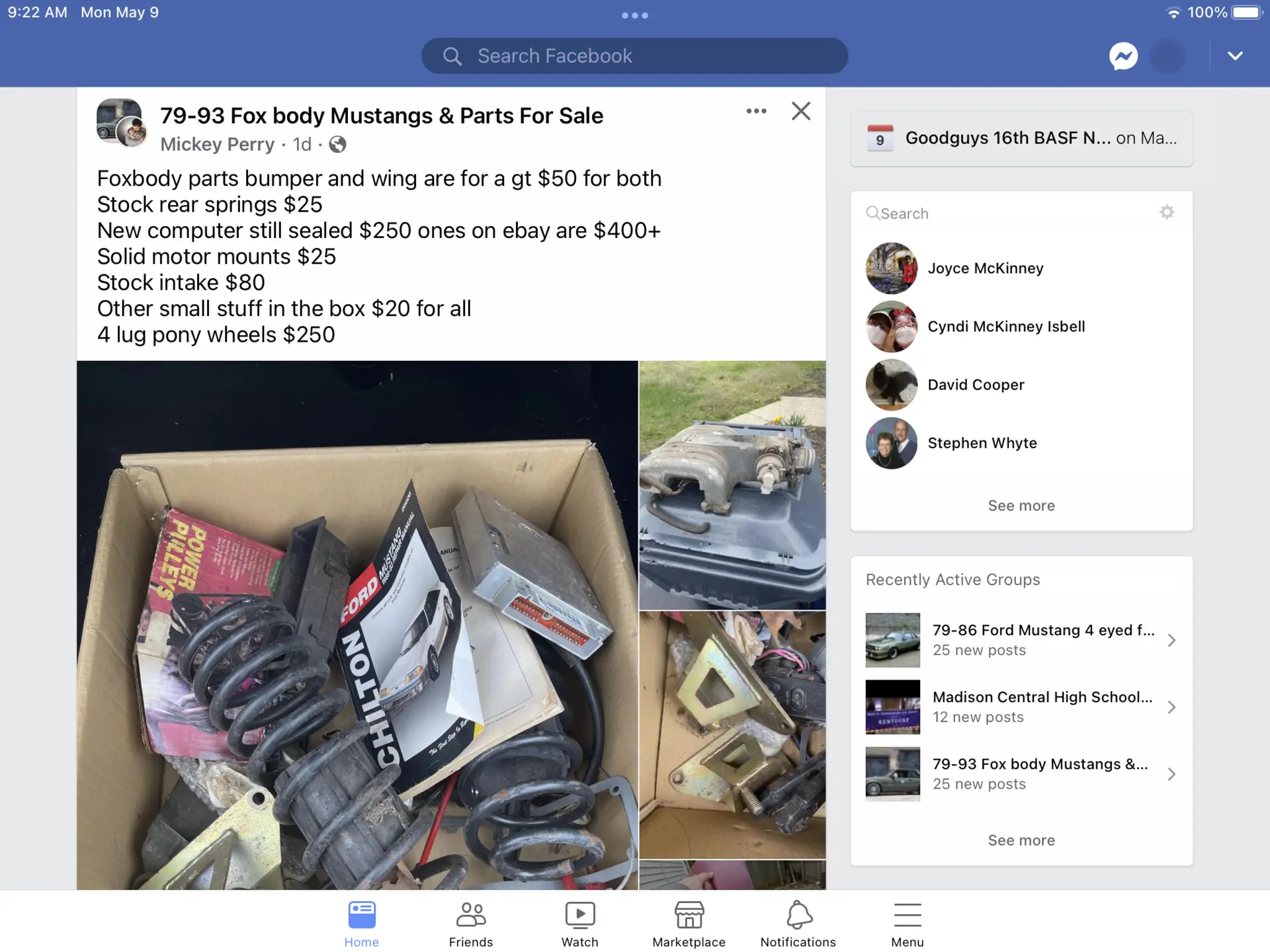

this is on a Mustang site today:
