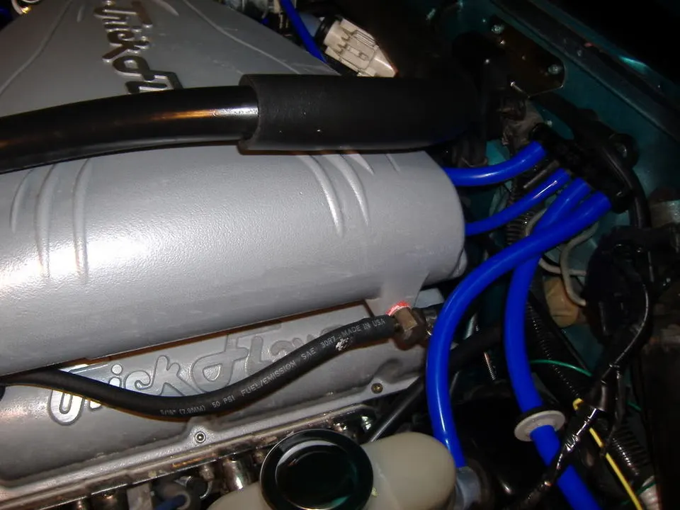

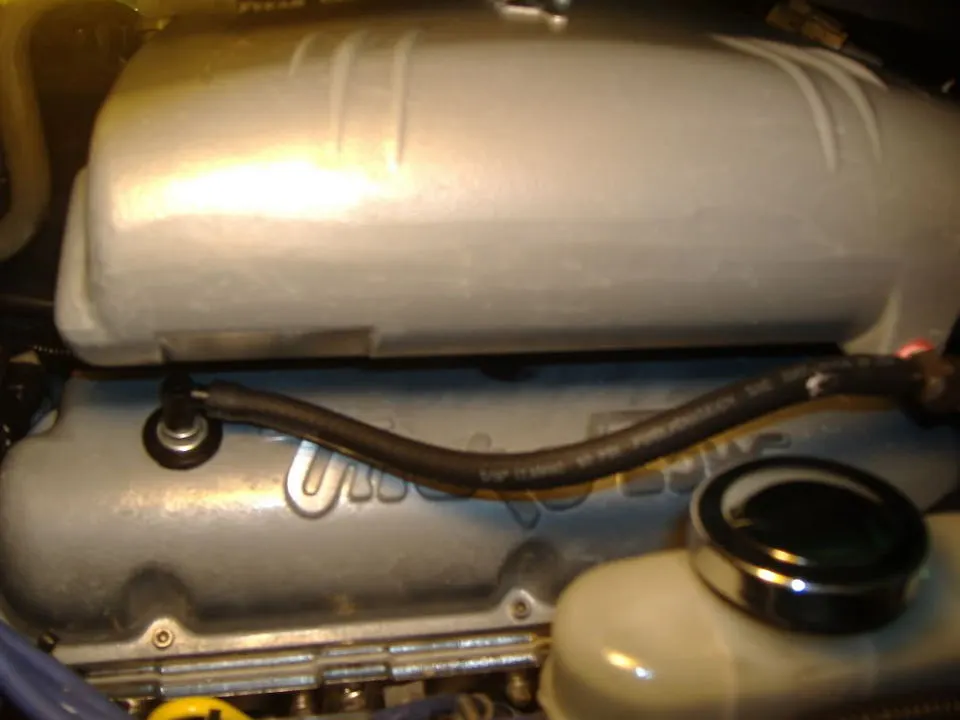

Heres the setup that i went with. Hope this helps someone.

Just did it today so we will have to wait and see if it makes any difference with the spacer getting soaked with oil. I'll keep everyone informed. I didn't put a baffle under the second PCV valve i probably should have, but we will wait and see what happens. In a few days, I'll check the hose to see if theres any oil in it. Thanks for the compliment.

Daddystang - Sooner or later you will probably see that you need a baffle under the second PCV. I added a second PCV and at first it was sucking up more than it did before I added it. I then added a baffle and that lowered the consumption, but I still am sucking up too much oil somehow. :bang: I have mine setup exactly like yours.
Good Luck, hopefully it does the trick for you!
