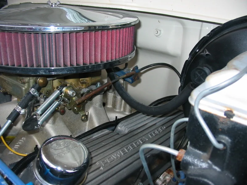

C cptam1 New Member Dec 27, 2005 32 0 0 Ft Riley Ks Feb 9, 2006 #1 Feb 9, 2006 #1 How do yo adjust the throttle cable on a 69 mustang 351 4v (cleavand)?
C cptam1 New Member Dec 27, 2005 32 0 0 Ft Riley Ks Feb 10, 2006 #2 Feb 10, 2006 #2 oh yea forgot, 351 4v 650 cfm holley dbl pumper carb with a spacer.
302 coupe Founding Member Mar 2, 2000 1,952 3 36 Macon, Ga. Feb 10, 2006 #3 Feb 10, 2006 #3 I still owe you some pics of this don't I? I'll see what I can do tonite after work.

C cptam1 New Member Dec 27, 2005 32 0 0 Ft Riley Ks Feb 10, 2006 #5 Feb 10, 2006 #5 the heim wont work, at some point you have to have a complete linkage. I dont. I would have to fab from the pedal to the carb.

C cptam1 New Member Dec 27, 2005 32 0 0 Ft Riley Ks Feb 11, 2006 #6 Feb 11, 2006 #6 i figured it out once i put on the throttle guide from Holley. Now the witch wont start.

302 coupe Founding Member Mar 2, 2000 1,952 3 36 Macon, Ga. Feb 13, 2006 #8 Feb 13, 2006 #8 probably a little late but here's a pic of my setup. Attachments throttle.webp 81.6 KB · Views: 668
