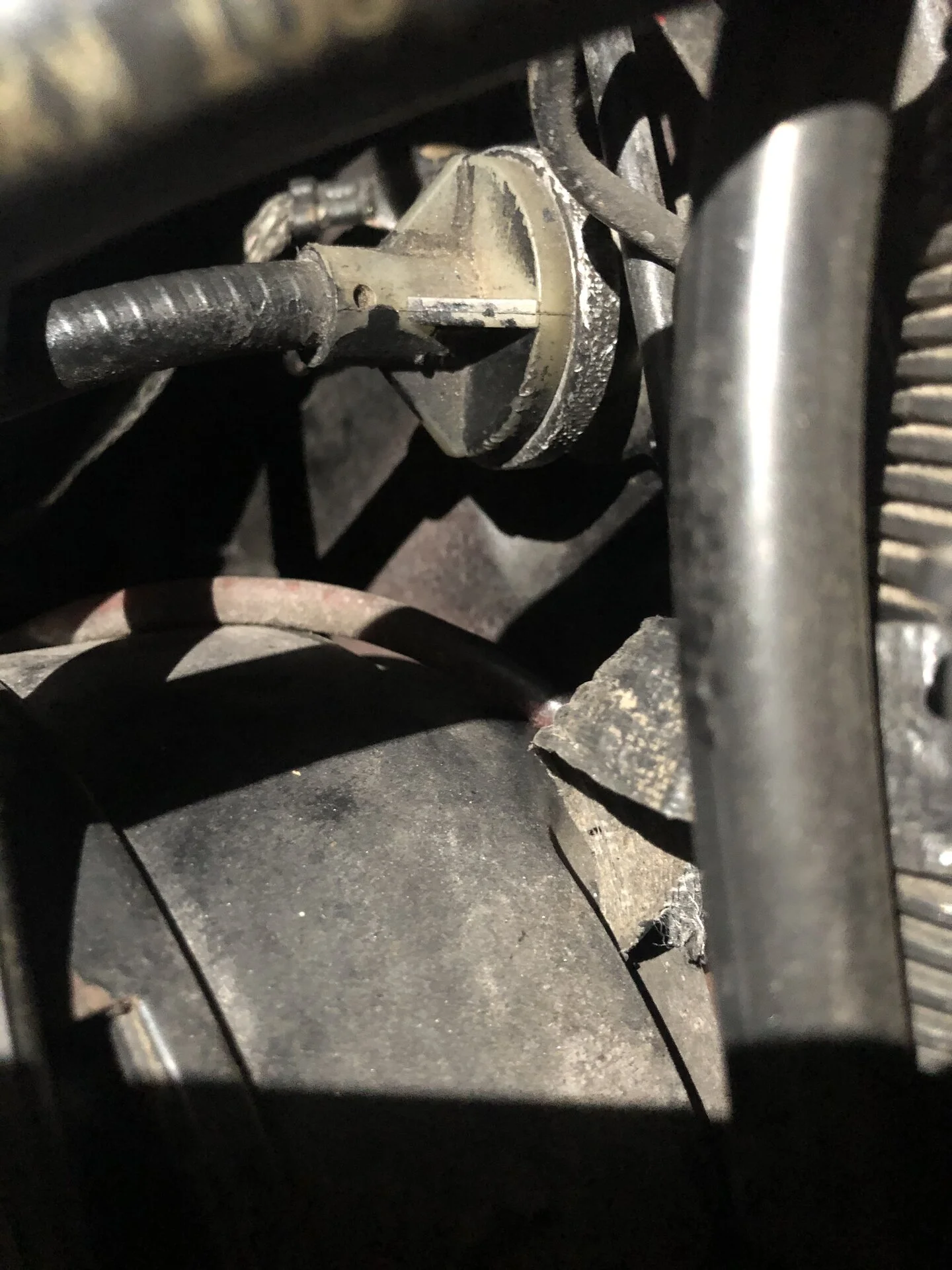

Hello all. I’ve been having some problems with my clutch ever since I got the car. I’ve been focusing on getting the car running right before I ever messed with that. So now that it’s running ok it’s time to address the clutch. To start off with it’s a very heavy clutch. I’ve been told that it’s a centerforce by the guy who sold it to me but who knows. It also has absolutely no slack in the pedal whatsoever and It doesn’t seem to engage/disengage all the way. When I let off the pedal entirely and floor the car I get a bad clutch smell and when I slam it to the floor it seems just barely enough to even shift.
My question is is do you all know if the cable I have (at the firewall)is adjustable or not? Here’s a picture for reference
The metal ring in the picture spins. Anyone have any ideas on what could be the issue with my clutch?
I say no adjustable on the firewall...You are going to have to safely get under, and adjust. Make sure you have jackstands, or something big and strong under it. Sounds to me like you need a new clutch, but give adjustment a try
That is a firewall adjuster.. If you turn it clockwise you will loosen the cable more. If you turn it counter clockwise your tightening up the cable. In your case it sounds like your cable is out of adjustment and way too tight. I would screw the adjuster in a few turns (clockwise) put car in gear and slowly let up the clutch and see if it is any better with disengaging.. Then do it some more and try again until you get it where you want it.
OK...I would like my clutch to engage a little higher off the firewall. Do I tighten (counterclockwise) or loosen (clockwise)?
Counter-clockwise stretches the cable within the housing (making it tighter) causing the throwout bearing to seat against the fingers of the pressure plate.

That actually appears to be an adjuster at the firewall, can you spin it till it is against the wall? Look to see if there is an aftermarket quadrant.

Glad you found that. I adjusted my cable but it didn’t really make a difference. I got someone to push in the clutch pedal and saw my firewall was flexing. It wasn’t much but it’s cause for concern
