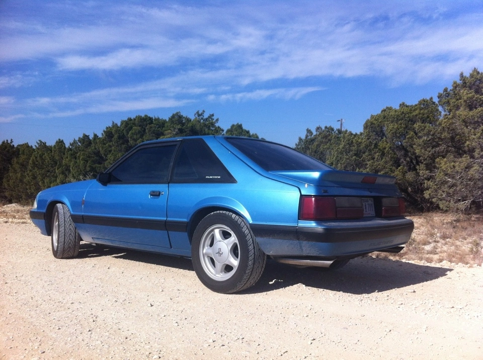

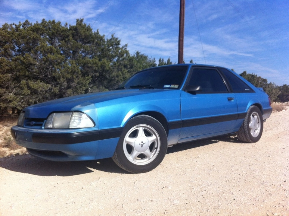

I've got a 1992 2.3T Fox that has Ford Racing springs, and is in bad need of alignment after new ball joints. I have a set of MM CC plates sitting in the box that I've never had time to get around to doing. From what I've been told, there's really no advantage to them Other than alignment range. And since TNT car isn't slammed and I don't have coil overs, I probably shouldn't have any issues. So other than that, any other reason to install them? I have a vibration above 75mph but I'm Sure that's due to tire wear or balance, or something else. I'm debating just unloading them and putting the money elsewhere in the car. here's some pics for height reference
