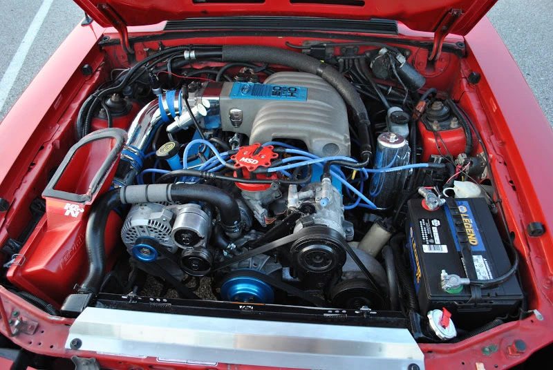

Hi guys,
I recently purchased a 91 GT with a fair number of mods already installed. I've been running into issues with the car running hot and have already swapped the t-stat with a 180* model and replaced with fresh coolant and Water Wetter, but that doesn't seem to be helping. The radiator appears to be the original and looks pretty banged up on the front side, and possibly leaking near the radiator cap, so I was thinking about replacing it. The previous owner had installed Mishimoto electric fans wired to a manual switch and has the A/C on a manual switch which I have been forced to leave off to keep temps down. He also installed a stainless overflow cannister.
I was thinking about replacing the radiator and maybe going ahead and upgrading to an Edelbrock high volume water pump. Was looking at the Mishimoto radiator but I've seen some complaints here and there along with praise. So, I was hoping to get some opinion for you guys. I'm an admitted novice under the hood and am just learning and definitely appreciate any advice.

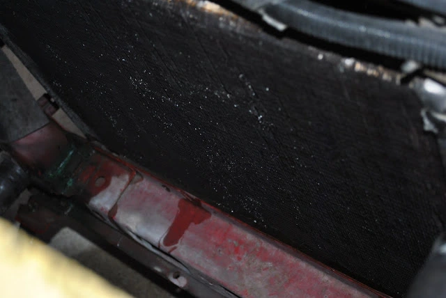

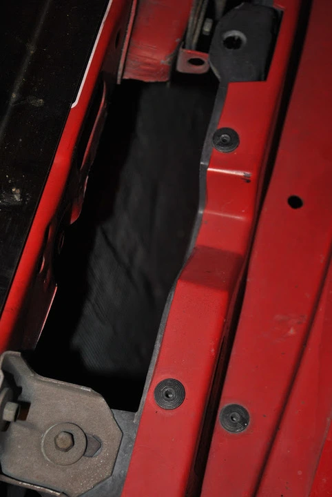

I pulled the radiator yesterday and discovered that my stang at one time had been an AOD and still had transmission cooler lines attached and crimped somewhere back behind the oil pan. All that's gone now and I am waiting on the new radiator to be delivered on Monday. After getting the radiator out, I noticed the AC condenser is really beat up and is actually what I was mistakenly thinking was the radiator when I was looking from under the front bumper. This makes me wonder if it is basically blocking the radiator from getting good airflow?
Back side of condenser
Tough to tell in this pic but there are massive areas where the fins are layed flat.
Questions... Would this affect the cooling ability of my car? I've only used the A/C once since I got the car and it works, but the temps definitely rose about a notch on the temp gauge.
Would it be worth looking in to a replacement condenser or can the fin damage be repaired similar to a radiator? I'm not opposed to just installing the new radiator and crossing my fingers that my cooling issues are solved, but if there is a better option now that I have everything taken apart, I would like to know.

Yes, that condenser may be an problem if it's blocking air to the radiator. You can use a comb or even a special tool for straightening the fins. It also causes issues in the A/C system and it won't cool well with that condenser like that.

I bought a condenser fin straightening tool from NAPA today to try and get the condenser in better shape. I'm also going to get some coil cleaner spray to get all the gunk out of there. Got a new Mishimoto radiator in the mail from American Muscle that should get here on Monday. And lastly got the air deflector and mounting hardware ordered from LRS today. So *hopefully* when I get all this in I will see a big improvement and can get the car where it belongs.. on the road.

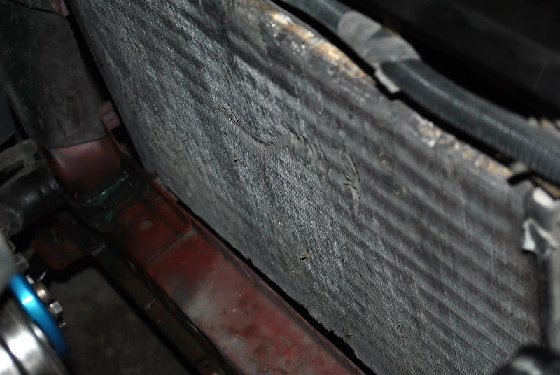

Wanted to post an update. I worked the A/C condenser over with the fin straightener tool I picked up and then used some WEB Coil Cleaner on it with a thorough rinsing afterward.
Before:
After cleaning:

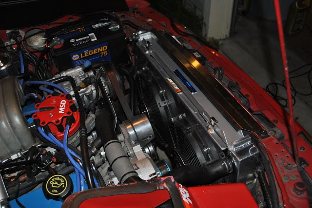

Popped in a new Mishimoto radiator tonight and hooked up the electric fans and it seems to be running spot on. Let it warm up and topped off after the t-stat kicked in and then took it out for a spin. I probably took it about 10 miles or so and even turned the A/C unit on (nice and cold) for the second time since owning it. Temps never got over the first hashmark. For 90% of the time the temp gauge sat just under the first hash.. after running through a drive thru and sitting at idle for about 5 minutes, it crept up to right at the 1/4 mark. 2 weeks ago doing the same drive I would have been easily up over 1/2 and starting to creep to the 3/4 mark, all the while the interior would be getting hotter under the dash. So fingers crossed... I think this may be a done deal. If everything stays as is, I will swap out the manual fan switch for a good controller like that Spal unit a few of you have mentioned.
Here's a pic of everything back together:
Definitely appreciate all the advice from you guys. That's by far the most major underhood work I've ever done and it's sweet to know I did it on my own!
