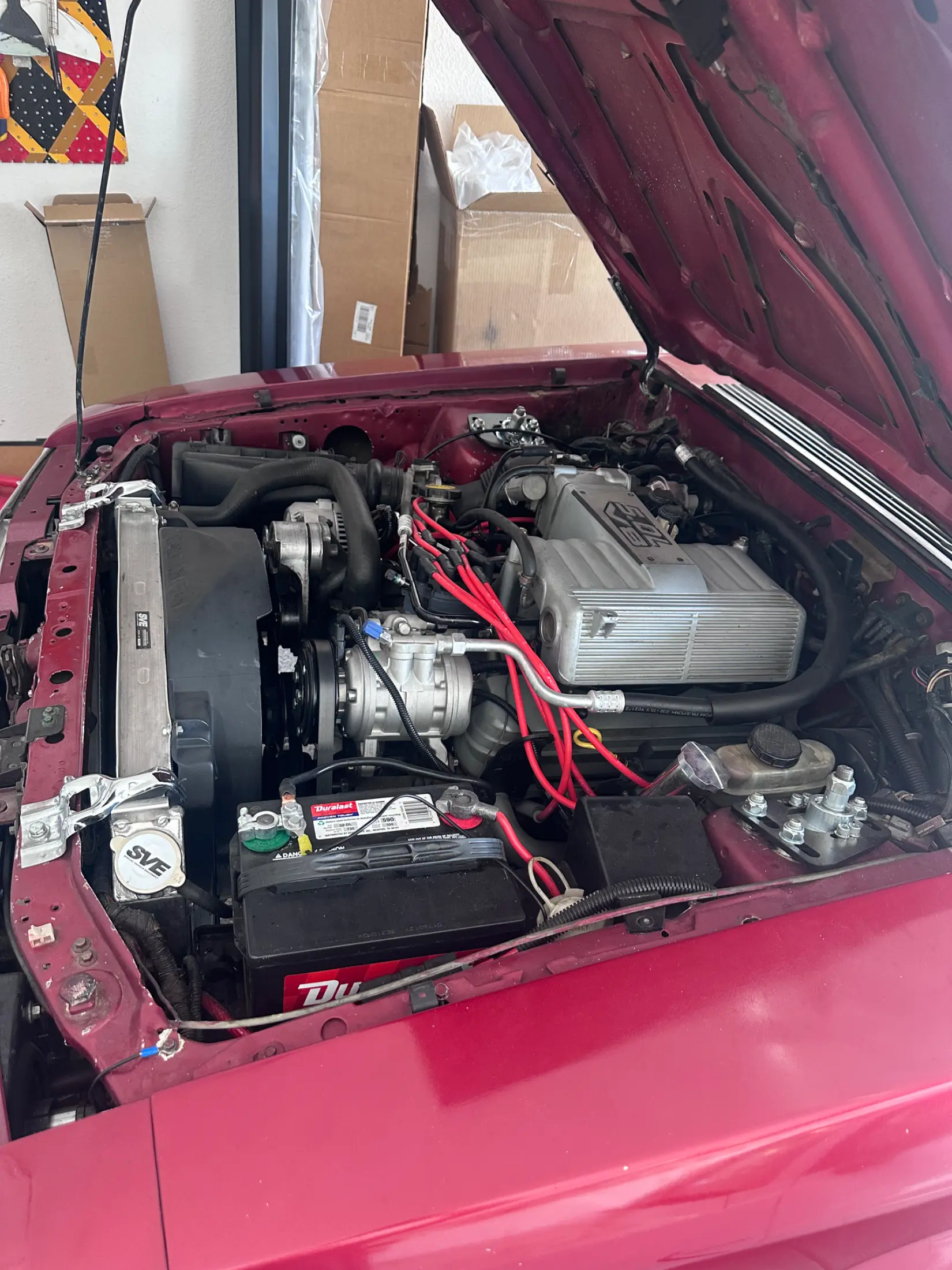

Well,
The issue appears to be fixed now. I burped the system again, but I noticed I had placed the coolant tank hose in the wrong place so it was getting air. ( I have an aftermarket coolant tank, see pic). Once I burped the system, the gauge now stays at about 1/4 right about the letter A. I also had a couple of small leaks around the water pump that I fixed by putting RTV for now.
I still plan on installing gauges that’s a must but at least the car is drivable.
I’m going to take it for a drive hopefully it doesn’t surprise me again lol.
Thanks again for all of your input. You guys know your stuff.
