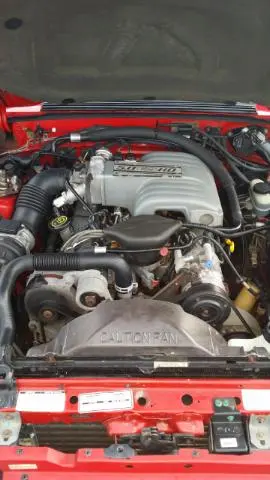

engine bay looks like stock. that I would say is good since it was treat well from the picture. seat covers are readily available door panel map pockets sag you could pull the panels and take them off by clips on back of panel just recover with carpet. If you know a good mechanic have them check it out, also what madspeed said check out VIN via a service...

I wouldn't worry too much about the CC plates, i see them as a bonus. You can see a glimpse of them in the picture.
