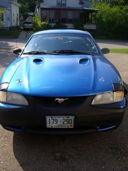

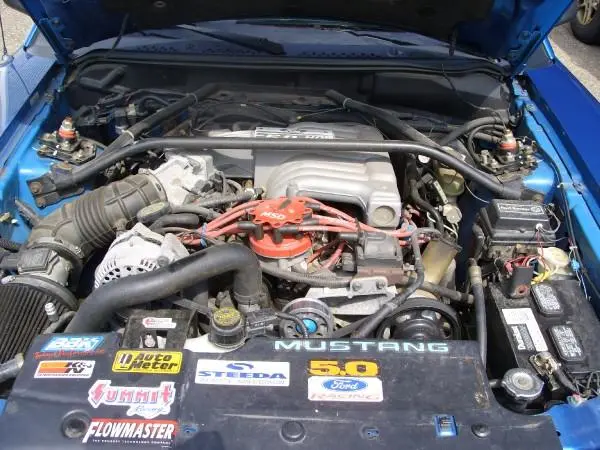

Here is what my GT looks like. I know it needs an engine cleaning, the reason it was given to me was because my dad couldn't take care of it anymore like he wanted to(he can't stand for longer than 5 mins). Also a tip for engine cleaner would be great too!

It depends totally on your budget and if you are paying to have the work done.
The least expensive option will be nitrous, which safely you could get all supporting hardware and a tune for $1,000 or less that will put you in the twelves safely with a stock motor.
The other school of though is the naturally aspirated, which means all engine no power adders. No blower, nitrous or turbo. The most common route is Heads, cam and intake manifold coupled with other boltons such as headers, mid pipe and cat back exhaust. If you are google savvy just type in Trick Flow and Eddlebrock to get some of the most common top end kits I am mentioning. All this will run you in between 2k-3k depending on which parts you choose, but that doesnt include labor. Its pricey, but this hobby is. Also you dont have to deal with bottle refills.
Lastly you could just bolt up a supercharger or turbo and get a tune and also be in the twelves. This is going to cost you around 4-5k depending on the kit. It can be done for MUCH less but generally only if you know what the parts do, what youre looking for and will do some install on your own.
I have two major suggestions, ALWAYS get a tune when modding this heavily and do yourself the favor and justify your decision with a lot of research. Use the search function on this site and you will come up with some good knoweldge.

Start with some headers and a good exahust system that way it sounds cool and they'll know its fast. most mustangs are pretty fast but they dont know how fast till you beat em in a race
After the exahust do the cam and a good intake that will let that motor breath and it should be a good start for ya
Then if its not enough add a supercharger or a set of cylinder heads ford racing make a nice set
I would do it slow that way every thing you put on it you can feel the car getting stronger and you may get to 12 sec someday

First i would get a free flowing exhaust and if it doesnt already have them subframe connectors. If it were mine id do lont tubes w/ an o/r midpipe. The head/cam/intake is a really good idea unless your budget is tight, if so spray it!

I don't think that he is, but I'll be sure to ask him. :rlaugh: I'll keep that in mind about the "racing". My plans are to bring it to the track once it's all done. It's not a daily driver, but when I take it out, it's so hard not to play.
