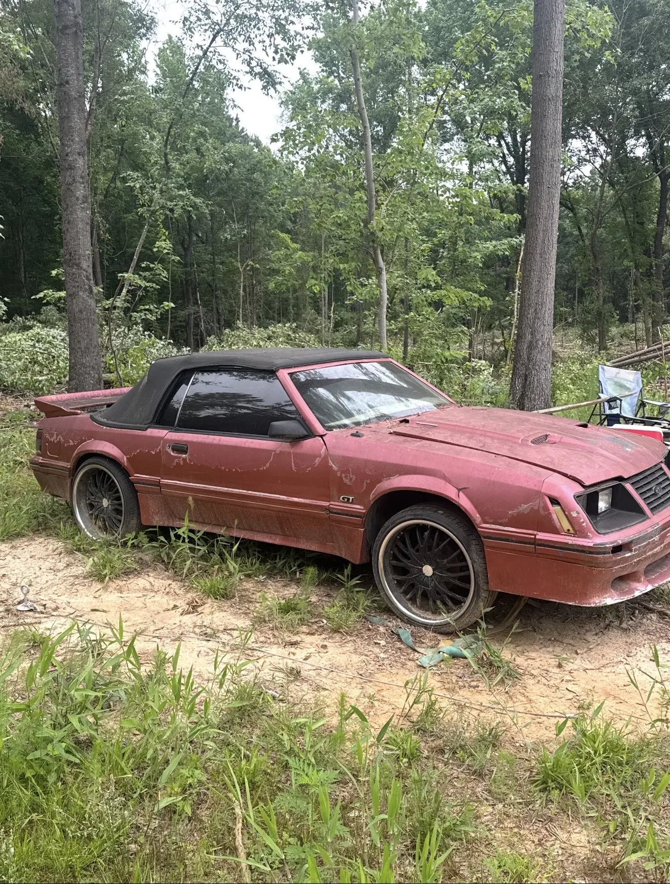

I just brought a 1984 mustang GT roller and I want to know outside of the original motor and transmission, what models from other cars make or models can I grab or what have you all swapped it with. I’m not looking to race just want a fox body

96-01 explores are good engine donors but still need some fox body parts, 351 trucks and vans, really depends on what you want, how you want to dress it out with brackets and accessories. 3.8 5sdp cars are good for donor T5's. The 79 I picked up someone swapped pretty much has 80's/90's f150 non ho 302 with a carb on it and a t5, started life as a 6cyl. LS and coyote stuff a common.
