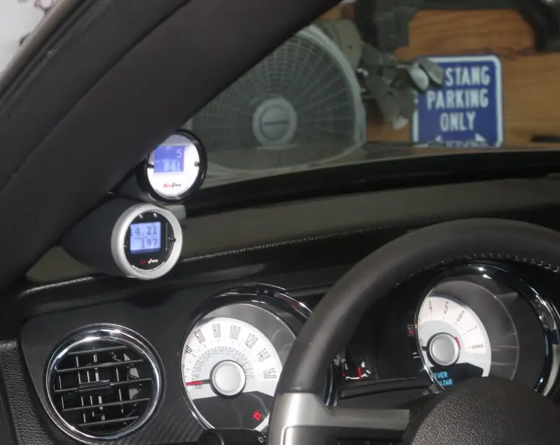

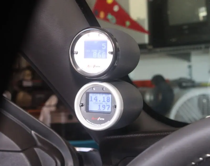

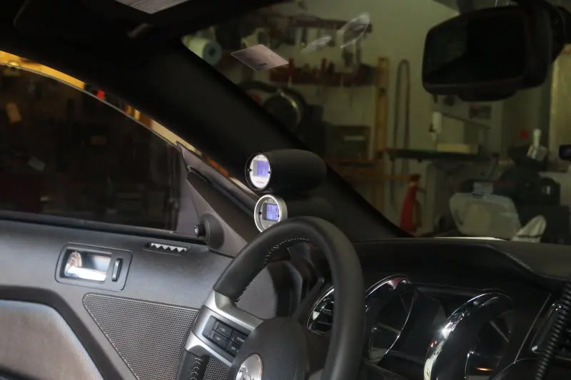

Got the gauges installed today. My comments.
1. Came with 2 faces and 2 bezels to mix and match..I wanted a chrome bezel but they didnt give me one..Steeda getting it for me...I just put pics of different combos, but Im going with the black face, white back light, black numbers and chrome bezel. The silver bezel looks white, and the stock gauges have chrome trim.
2. For being as pricey as they are, there is NO operating booklet or manual..just a 2 page, stapled "general" info sheet. :bs:
3. The Pillar is by "Speed of Sound" and matches the stock one exactly..this makes for a really neat fit of the gauges.
Here's a few pics:
Just gotta learn how to use them to scan what I want displayed.
RC
I found the blue to be really hard to see in bright daylight.
