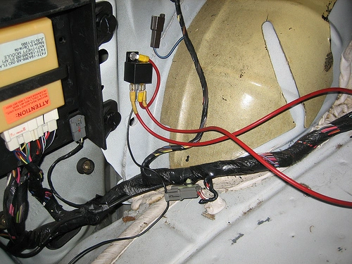

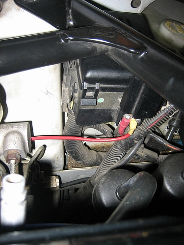

I took the route of running a 12ga wire through the inside of the car to power my pumps. I used a relay triggered from the "safe" side of the inerta switch as my trigger wire - red/purple wire if I recall. The 12ga wire was fused with an inline 20A fuse.
Here's a diagram, unsure if the colors are correct: http://www.mustang-tech.org/wiki/images/1/13/94-95-EEC-Pinout.gif
Whichever way you do it, be sure you tap in after the inerta switch so that you fuel pumps will shut off in an accident.
