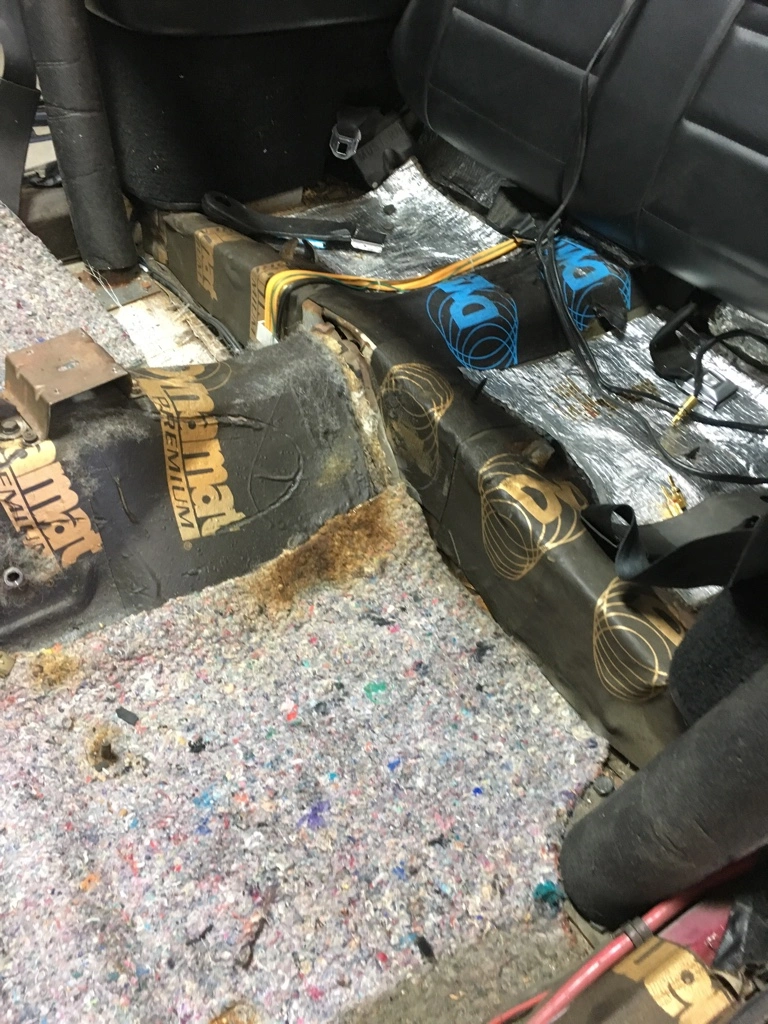

Love Putting in Dynamat, not finding Dynamat!
She has seen some power for sure!
Sent from my iPhone using Tapatalk

That's the tunnel under the back seat.
Pretty sure she was bought ready to tear herself in two!

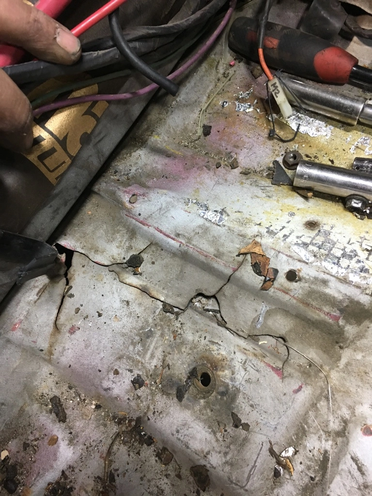

More evidence of Horsepower!
Cool!

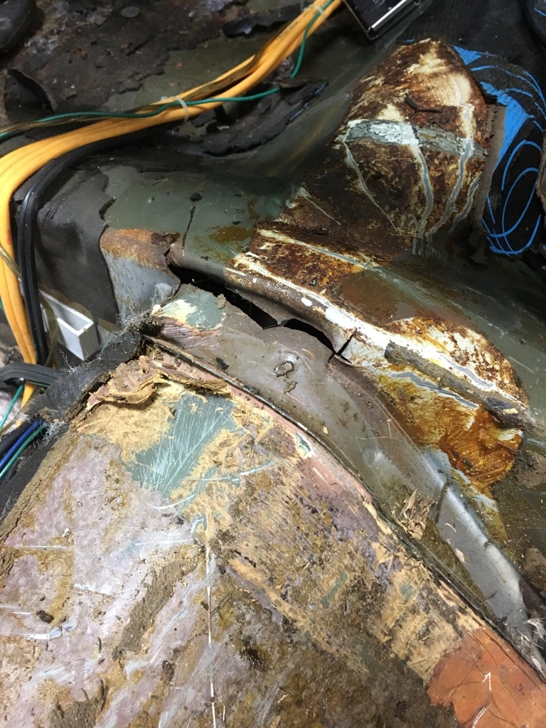

You are right to worry about those round subframe connectors, wayyyyy back my car had them, about 10 years ago, put a jack stand under the middle and it broke like it was a piece of bamboo, water gets in them and they rot from the inside out.
Don't worry about the car splitting it half, according to the pics above, the car was really folding over on itself.
It's one of those problems that makes you think even powerful street mustangs could use some type of quality roll bar.

Boy you do have some work to do.
I don't remember seeing that much stress damage before, l'll have to keep this one in my memory banks.
Have you checked the squareness of the body yet?
