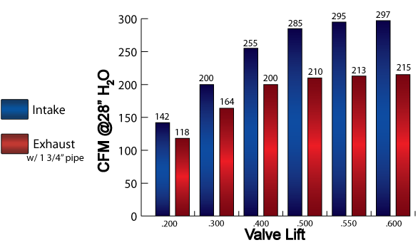

I got the numbers from the afr website not from here.
I wonder if the website is wrong then, because 277 CFM @ .600" lift is about what I've seen before for the 185s. I'm looking at their website right now and it looks like they might have accidentally posted the 195 flow numbers on the 185 page. This is what I see on their website below:
Flow numbers for the 195:
Flow numbers for the 185:
Obviously they wouldn't be the same. :shrug:

ok so just called afr and they were really no help. they just said that the website hasnt been updated but he did say that the specs on the 185cc head were correct but id like to see some independent flow numbers on both heads
found some independent testing and there stuff is wrong its basically as posted in the OP
Yea, I thought that couldn't be right. 295 CFM @ .6" is almost AFR 205 territory.
