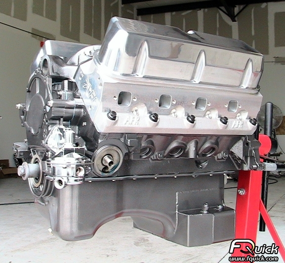

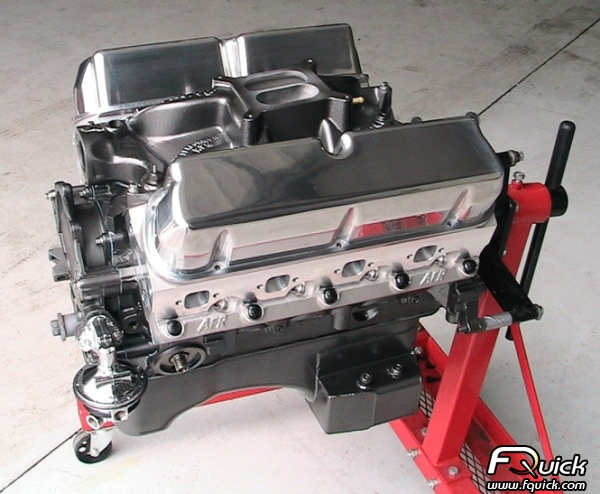

I got rid of my GT40X heads for 165 AFRs and according to Tony at AFR there will be a very noticeable difference. I also spent the extra $150 for the competition version of the 165s which has further porting, 7/16 studs and heavier duty springs since I will be swapping the Cobra cam out of the 93-95 cobra shortblock for a Lunati grind. The motor I had started out as a 320 hp FRPP crate motor with a 93-95 Cobra shortblock, GT40X heads. With the Edelbrock performer RPM intake, Holley 650 carb and long tube headers, I would make 320 hp at the flywheel. With the new AFR heads, cam, Weiand Stealth intake manifold, and high flow fuel pump I should be making anywhere from 320-340 to the wheels. I have been talking with Tony at AFR and am following fairly closely to a combo that Evan Smith at Muscle Mustangs had done on their 85 Capri and they made 317 to the wheels with the same cam, heads, intake, stock shorties and fuel pump. I'm running full length headers, a little bigger carb and I have no accessories accept an alternator. I'm even doing an electric water pump. I also bolted up a Canton deep sump pan with a crank scraper. I talked quite a bit with Evan about the combo on the Capri and he knows my coupe and I told him about the mods and he's thinkin' no problem to get 330-340 rwhp. We'll see 'cause I'm gonna dyno it at MV Performance soon. Motor is built and done just need my tubular k-member and she's in.
Here ya go 87pony - this is for inspiration...
Here's the motor, I haven't taken the Edelbrock intake off yet...
Here's the photo album of the car for more shots of the engine build up and AFR heads - they are gorgeous!
http://www.fquick.com/garages/viewgallery.php?carid=733
John
