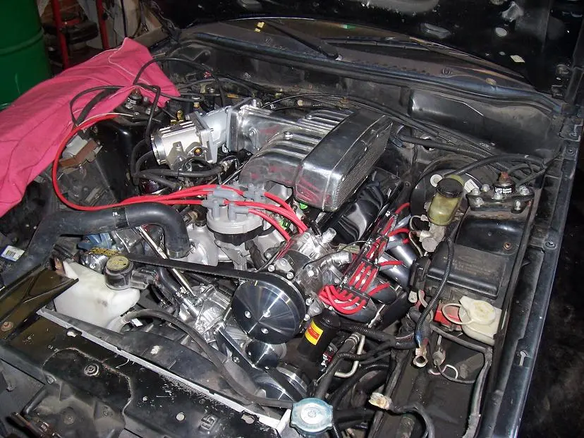

This is not exactly your combo, but it might help ... I have AFR 205s and Comp Pro Magnum roller rockers. My stock valve covers fit over them. I have chrome Holley valve covers from Summit (#HLY-241-81), stock height.
Thanks, blackvert for the reply, I don't think they will cover my roller rockers. The DSS r/r's I'm running are wider. See attached photos.

I run 165's
I run Scorpion stud rr's which are some of the largest out there
I run Fox VC's
I run no spacer
1) I removed the splash guard from the VC's
2) I removed a small amount of material from the front bolt boss
on each VC
3) I cut the filler neck in half and used a 2" section of ricer car
radiator hose to reposition the top half
4) I used one thin washer on each alternator mount location
to shim it slightly forward
It may seem like a lot of work :(
but
Items 1 - 4 were accomplished in just over an hour :)
Common sense and a die grinder was all I used for an easy fix :D

nope, no spacer.
the summit site says they are stock height, but to me they look a little taller.
the breather thingy did have a problem with the throttle body, but i have a 410 which may make a difference. my installer swapped them so that valve cover is on the driver's side

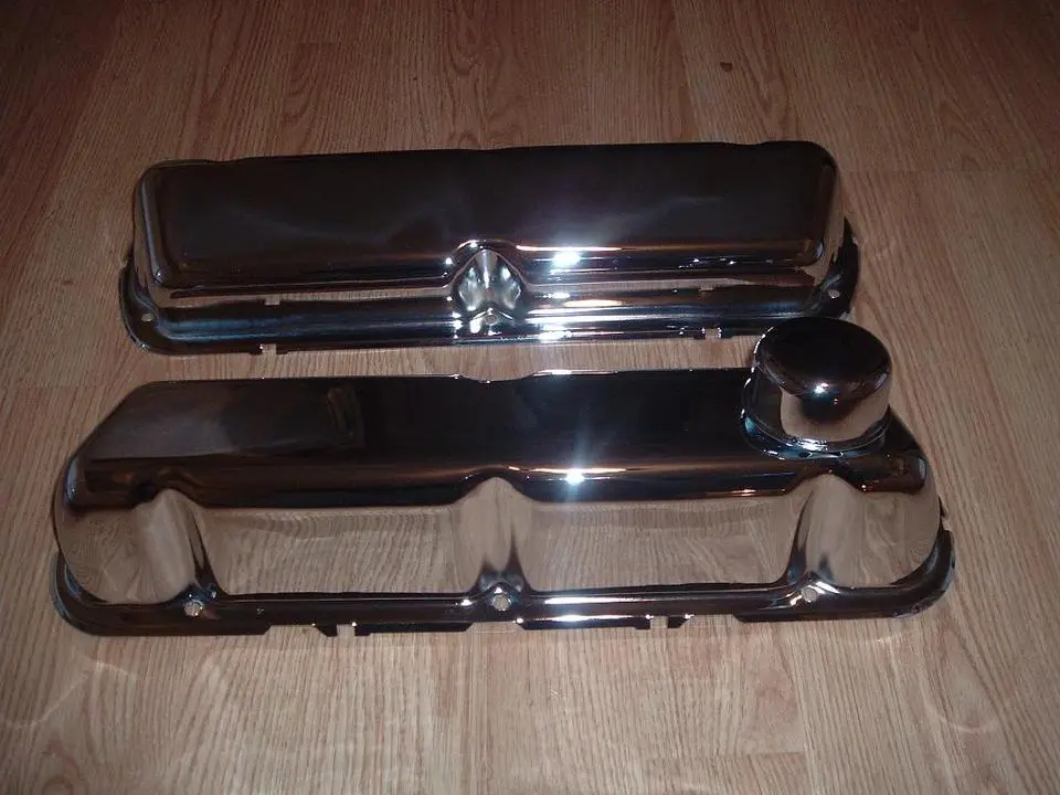

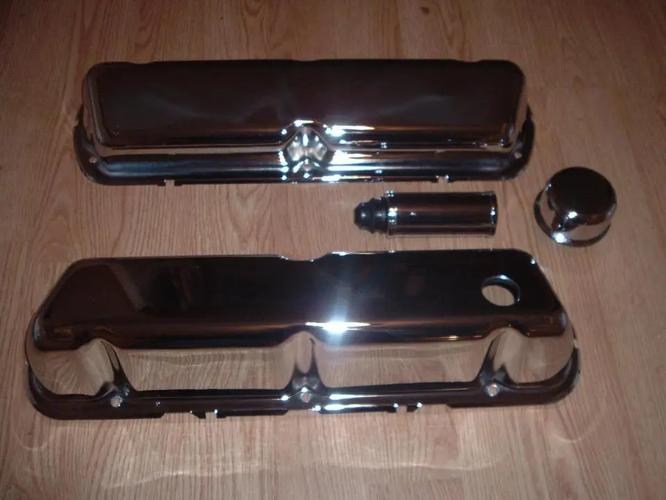

Well, I think I have purchased a set that will work...tell me what you think. I found them from JOE HECK RACING. Or should I say, found them on ebay from Joe Heck racing. They are a new product from them and are modified specificly for 94-95 mustang gt and cobra. If they cover my Alum. R/R's, then it will be a plug and play part. Meaning no modifications needed.
I know like most of you that sometimes ford doesn't make some of the parts for use 94-95 gt/cobra owners. I would love a s351 wing for my 95 cobra but its not made for my year and model. So, I wanted to pass along that this set of valve covers from JOE HECK RACING is specific to us 94 and 95 guy and gals. I purchased one of the two set available on ebay. If you are interested in the other set that was available at the time I posted this, here is the ebay item number....290125936501 ,check it out if you want. Also here a photo form the Ebay auction.
