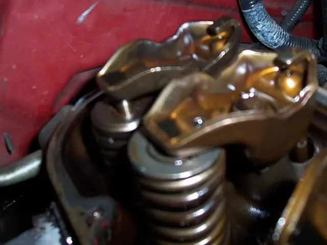

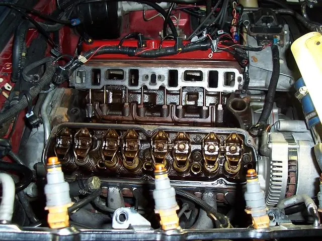

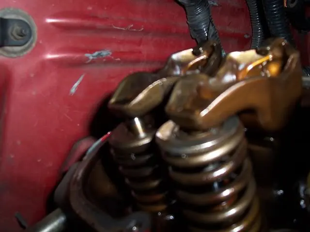

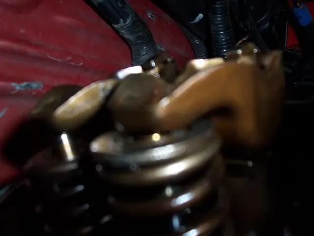

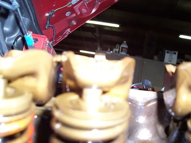

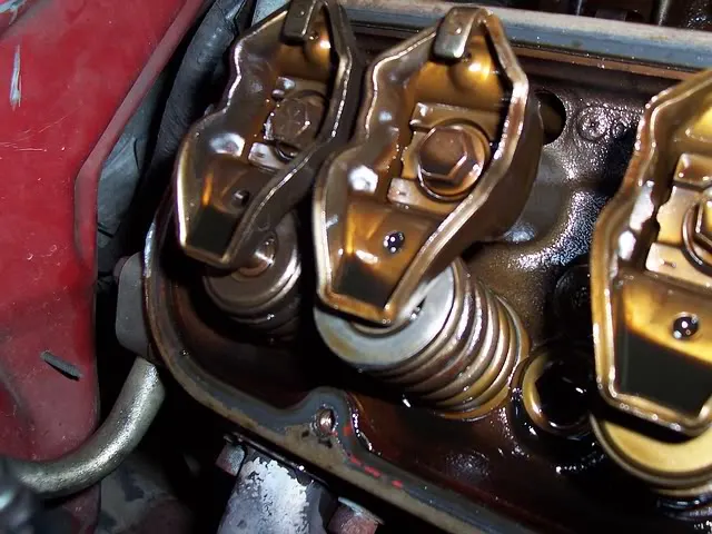

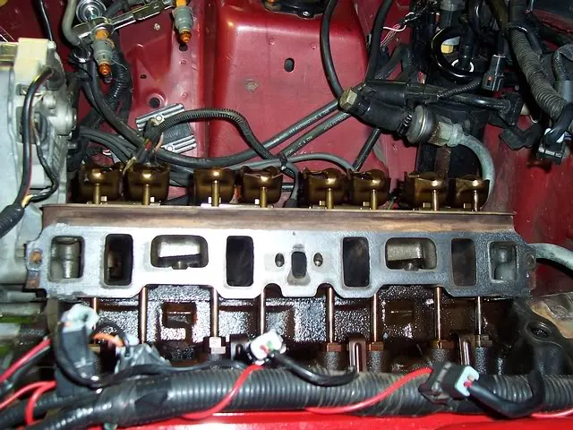

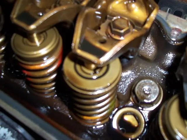

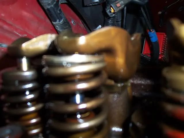

Yes thats right , take me 17 days over 50 hrs to find out that I have broken valve keeper on cylinder #4 on intake valve , I didn't pull valve cover on passenger side because I belive problem is with cylinder #8 , so I pissed off , take U/L intake again and pop the passenger valve cover and I find that valve keeper are pass retainer so I valve mover almost freely , I can push rocker arm with hand,
I have some pics and video ,
BUT I thinkin this have to be my problem because on wideband sensor (which I use last weekend ) show me right or passenger side runn TOO lean, and meybe this is why I runn too lean because intake valve over cylinder #4 never close whole way Meybe What you think guys
And here is how looks like other GOODones valve keepers

Nothing like not knowing what's wrong. Glad you know what to fix now, and good thing you didn't buy a new engine yet! A nice new set of heads, is just a little bit cheaper :rolleyes:
Glad to see you found your problem,guess you wont be needing my heads after all if you still want my roller rockers let me know.allways happy to see someone save money and get what they want at the same time.
What actually broke??? The valve???? Or did the keepers pop out....
Looks like from the pic the spring is being held in by the rocker arm. :eek:
Why would he need to pull the head to replace a keeper???? Why not compress the spring and put two new keepers in there...
Looks like your lucky you didnt drop the valve in there.
Nobody said he'd have to pull the head. We were just alluding to the nice opportunity presented to purchace new heads (I think like this because I'm lazy, and while its torn down, it'd be an easy install.) :D
Of course, he mentioned he doesn't have the finances for them, so...some other time :(
yesterday and today I order new valve springs for exhaust and intake , new retainers , new sleevs, keepers ,lifters and pushrods , tomorrow I going to change that stuff and I hope so cylinder #4 didn't smack intake valve , if is that intake valve I have brand new one , but meybe valve smack piston that I don't have :bang:
