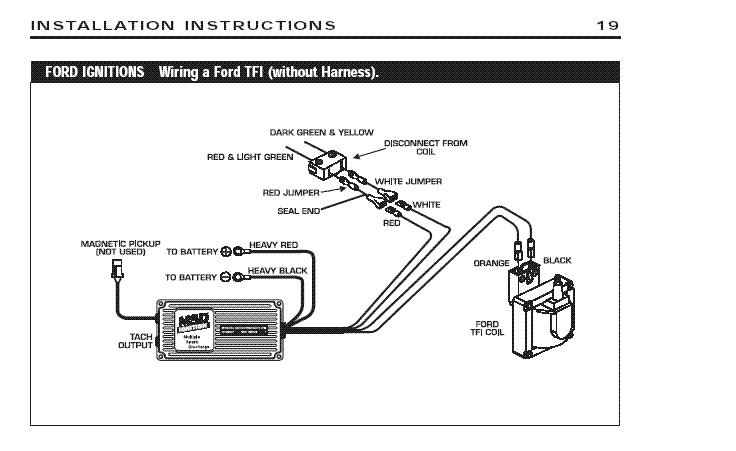

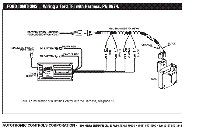

jrichker StangNet's favorite TOOL In Remembrance. Thank you for your contributions Mar 10, 2000 27,512 2,813 234 Dublin GA Dec 31, 2005 #6 Dec 31, 2005 #6 See http://www.msdignition.com/1download.htm to download installation instructions for MSD products. You will need the Adobe Acrobat viewer which is also a free download – http://www.adobe.com/products/acrobat/readstep2.html Attachments MSD Ford installation w harness.GIF 16.5 KB · Views: 1,397 MSD Ford installation wo harness.GIF 16 KB · Views: 1,912
