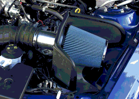

How do you find out which size is your Steeda CAI??? All I could find out was that I went to Steeda.com, entered my part number which was: 555-3120 and all I got was:

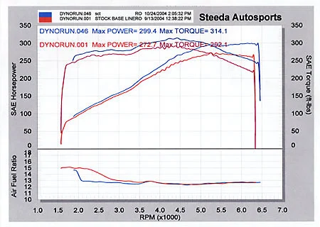

Attached is a picture of both the CAI and a Dyno Sheet they had on their site of the one that I have.
That is all the info I know about it.
