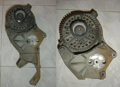

There aren't any aftermarket brackets for our 94-95 models. You can either swap in the Fox timing cover, water pump, and brackets, or just trim your existing 94-95 brackets instead. This is what I did to my alternator/smog pump bracket after I'd deleted the smog pump:
