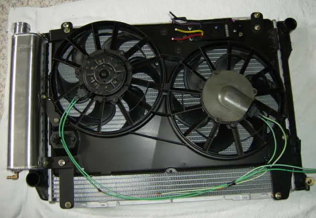

Here is how I mounted that catch can, I was able to keep it in the stock location so I wont have to extend the coolant sensor wires.
I remember why I didnt have a coolant can... The valve cover vent can lived there ( too tall to move the the rear passenger side ) I had the can cut down so now I can mount it in the rear passenger corner of the bay. Few days and 65 bucks later I have this..
The shop did pretty nice work, cut out just over 6" and now it should fit just fine. I dont think I want to polish it, maybe scuff it all so it matches?
