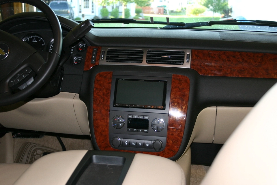

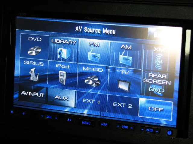

I have the Avic z-1 in my Avalanche, sorry that's a chevy and all, but I love the truck and it's styling. Anyway, I agree the Z-1 has the aftermarket nav world in it's pocket. You mentioned two key sellers in the blue tooth and XM, lets not forget you can run sirius as well, Ipod inputs are available, you can download CD's to the hard drive and play directly from it, numerous other auxilary inputs for things like game stations, secondary dvd players and the like. Also rear camera input, TV tuner connectivity, stock ticker and sports scores over your satellite service, and downloading of map and music notes are as easy as making a cdr.
It's got endless possibilities.
Here's a pic of it in my avalanche.. Really comes off as factory, I think it would look real nice in the stang.

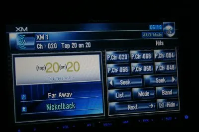

A few shots of it in action:

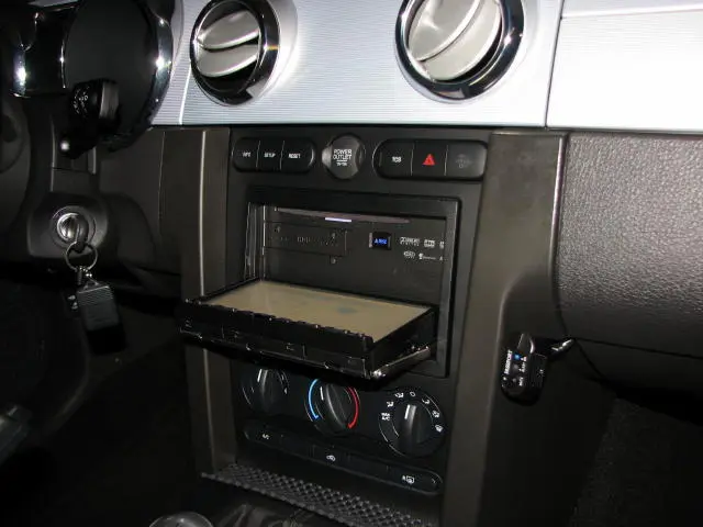

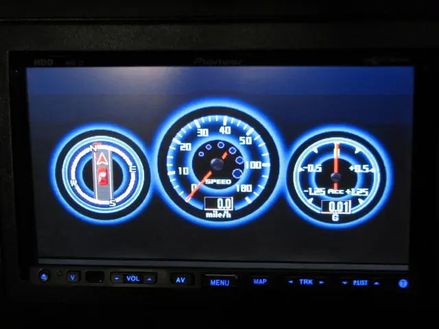

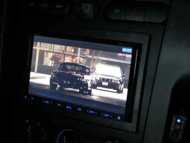

Sorry...been out of town. One great feature of the device is the ability to display fore / aft and side / side g forces. The unit has accelerometers that let it track g's as well as a center speedometer. Here are the pics of the install. See if you can guess the movie...
