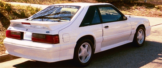

When I was 18 (1999), fresh out of high school, I needed a car. A buddy of mine had a '92 4-cyl LX 5-speed. So he let me drive it. And promptly, I told him, "I wan't this....with 3 times the power." And thus my obsession with the Fox Body was born. First was an '89 GT. Picked it up for about $3k. Oxford white w/ Grey interior. 5-speed, of course. A beautiful car. Something else was born that day. The mod bug.
Here it was in its heyday. Brand new cammed 306 crate motor, CAI, braces, LX tail lights, & Pony wheels. I did a lot of the work myself. This car is really what I cut my teeth on for wiring, mechanical issues, motors, transmissions. Sure there were a few things I couldn't do because of a lack of tools. BUT. This was the first car that I REALLY got into. Had well over 10k in that car. Had it for only 2 years.

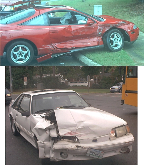

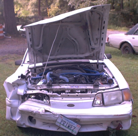

Guy cut in front of me on a 45mph road. Had no choice but to hit him. His fault, he got a ticket, and a broken arm. I learned the value of seat belts. I still have that smashed up PRIMEZ license plate on my wall in the garage.

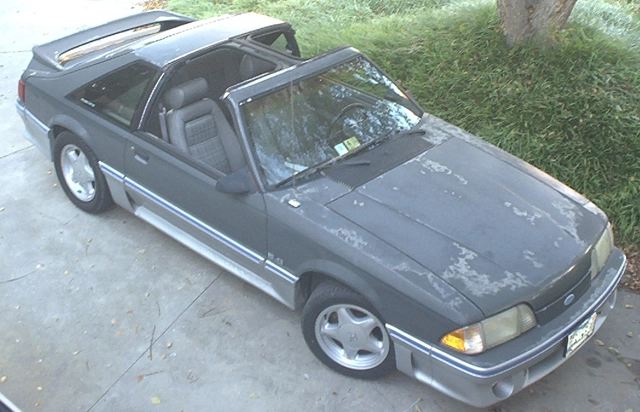

The never ending mustang project to end all mustang projects. For me at least. I had plans. Big ones. And with the car only costing me $2k. I figured what the hell. It looked like garbage, it had almost 200,000 miles on it, it leaked from every orifice possible, the headliner was falling down, and it needed a new clutch just to move. I didn't care. IT HAS T-TOPS! They only made the T-Top cars in this body style for a year and a half! This was the king of Fox Body Mustangs in my eyes. I had to have it.

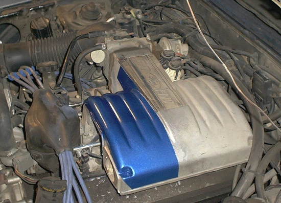

I did experiment a little...on random things

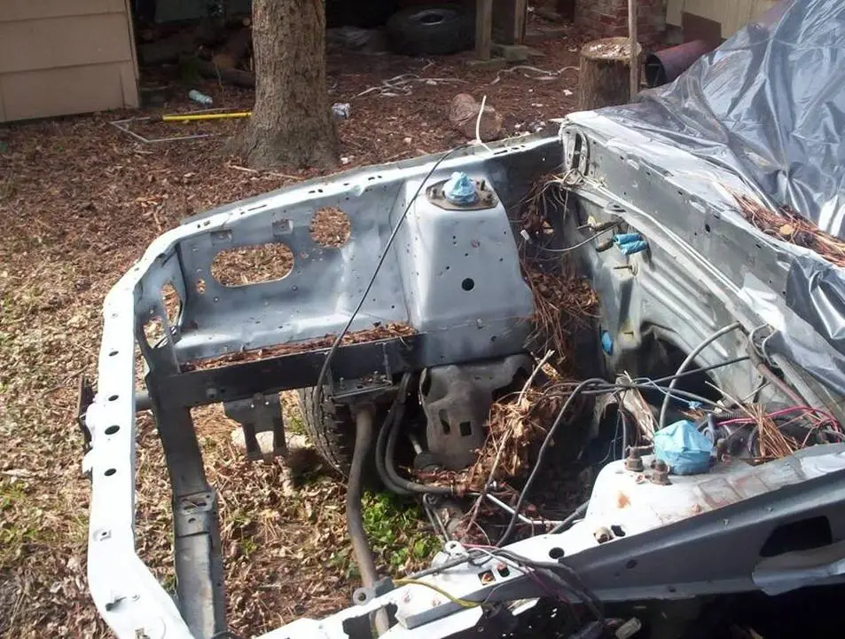

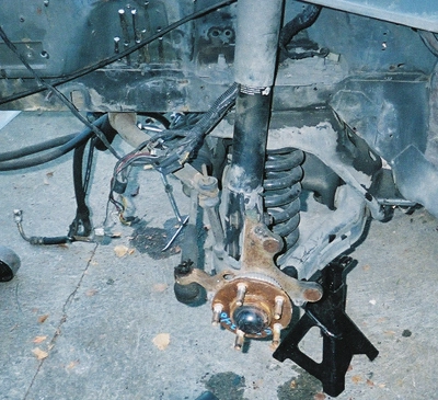

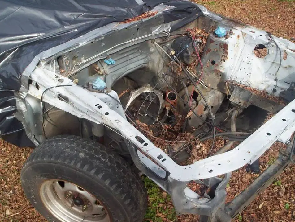

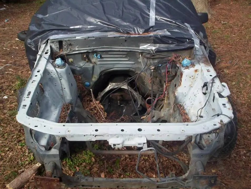

I pulled the engine and EVERYTHING out of the engine bay in 2004.

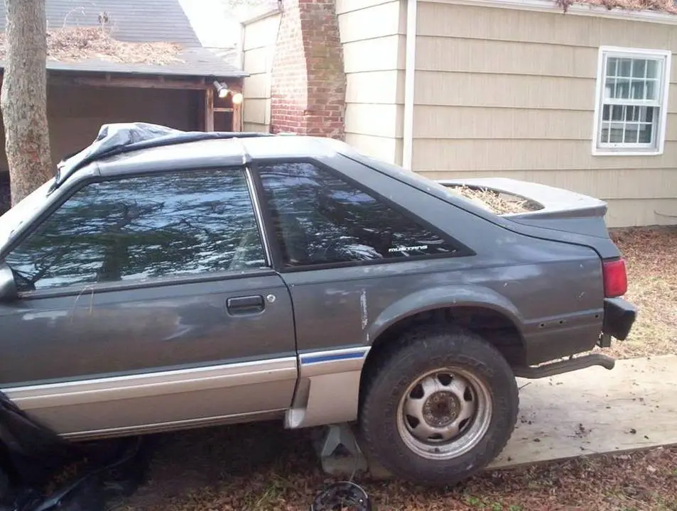

While I was at it, I did a junk yard swap to 5-Lugs on the wheels. Fortunately, the Heep got new meats, so I had wheels to put on the car to roll it around the yard. It sat in this condition for WELL over a year.

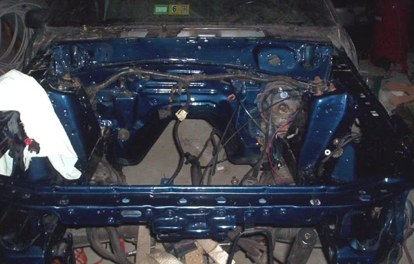

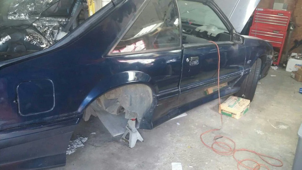

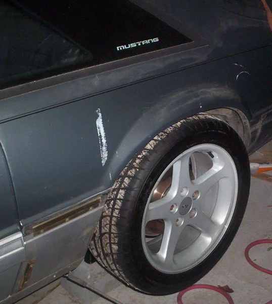

About the same time, I finally started on the body work. Full color conversion (Chrysler Patriot Blue....yes....I know its a Chrysler color. But it looks awsome)
There was a shop around the corner form my house, so some buddies and I pushed the car like 4 blocks to get it there. It started with the engine bay. I wanted that done so that I could start putting the engine back in it and get it functional again.

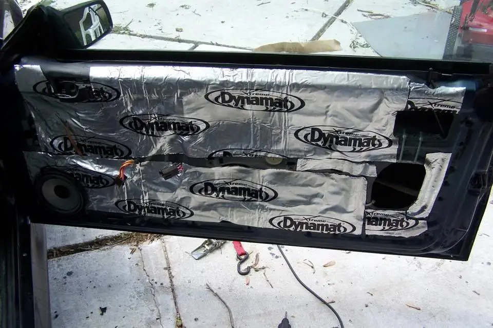

I covered the entire inside of the vehicle with Dynamat.

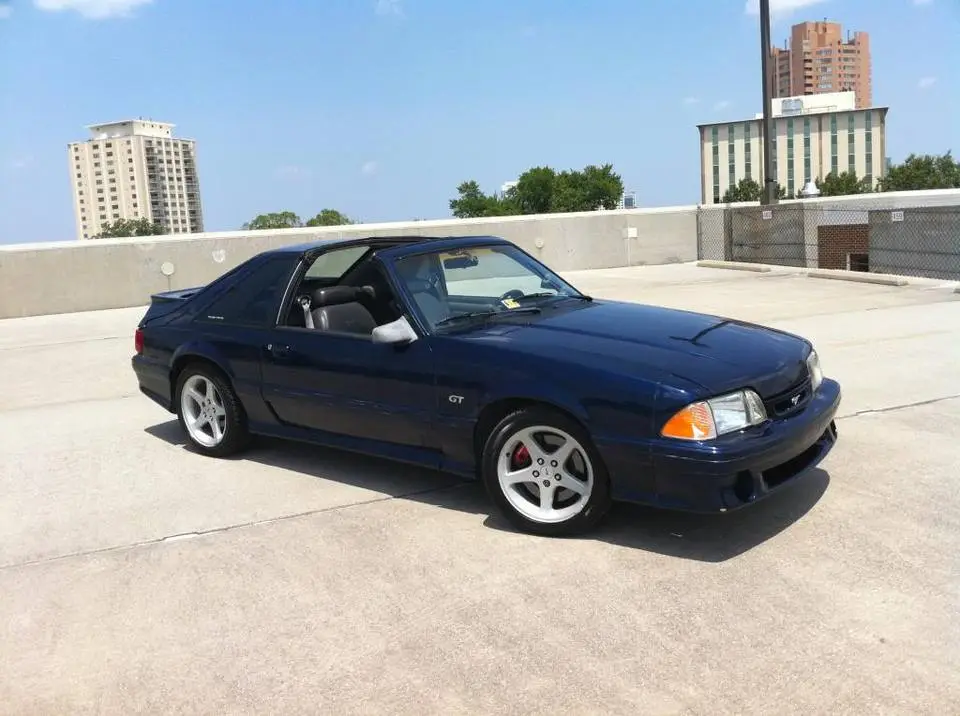

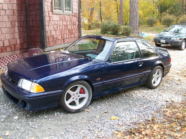

SHE WAS BACK!

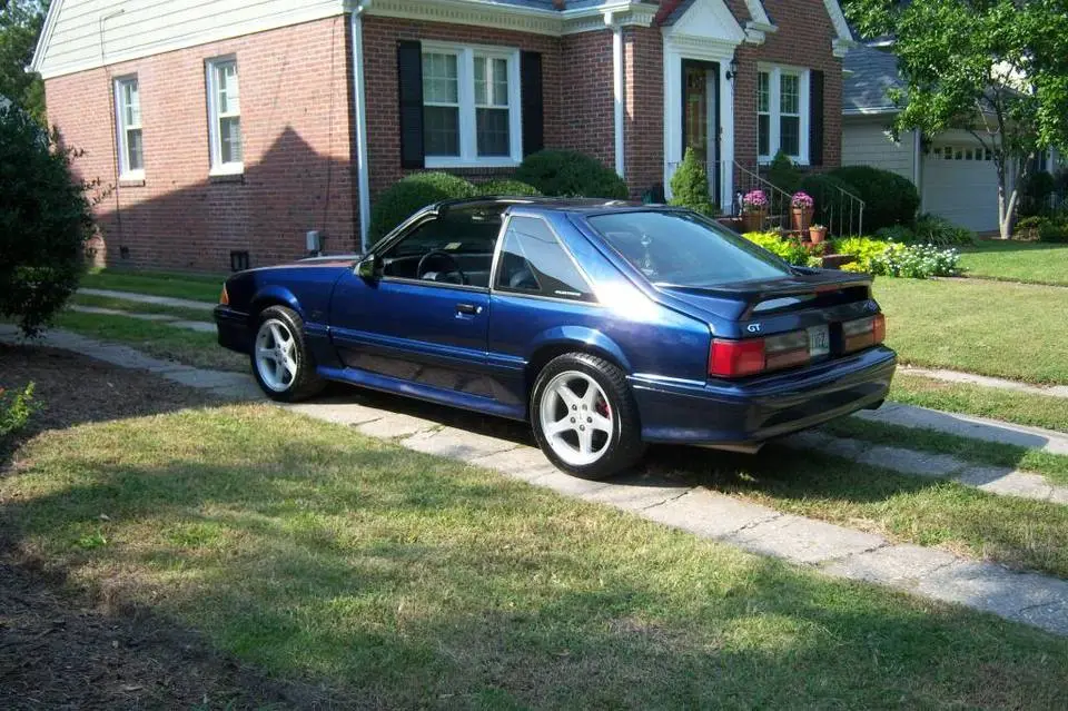

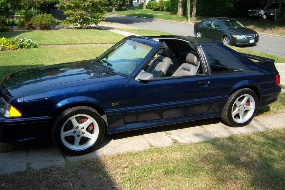

Even for me, and my wallet, it was hard to believe that it was the same car. But it was. While the body work was being done I had the door lock on the hatch and the factory antenna shaved. I figure if the trunk release ever fails, I can always climb through the back seats to pop it and replace the actuator. And I never listen to terrestrial radio. So why did I need an arial?? New carpets, dynamat, brand new T5z transmission. Everything was awesome. This was also the point when I started swapping in LED bulbs into the car. Started with the turn signals, and worked my way around. Today, the exterior is ALL LED. Plus the dome lights. Dash is next.
Then, tragedy. In 2009, we got a TERRIBLE nor'easter. The entire area where my wife and I lived flooded. Her car was a TOTAL loss. I managed to get the Stang out of the flooded parking lot before the salt water reached the computer. It got into the interior, into the exhaust, into the wheel bearings, the axle, the transmission, but the car still drove. I managed to drive it out to a buddies house 25 minutes away. It lived in his garage for several months. Insurance finally coughed up over $2k for repairs. They didn't total it!

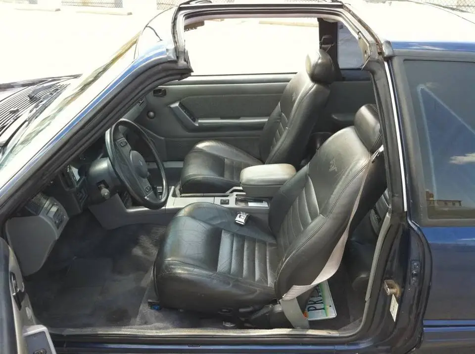

So, I went to town. Changed out the interior for 2003 GT Leather, replaced the carpet (again), some of the wiring, got it back up and going. AGAIN.

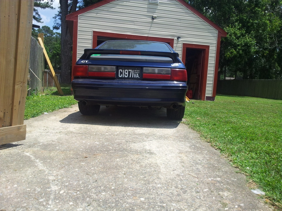

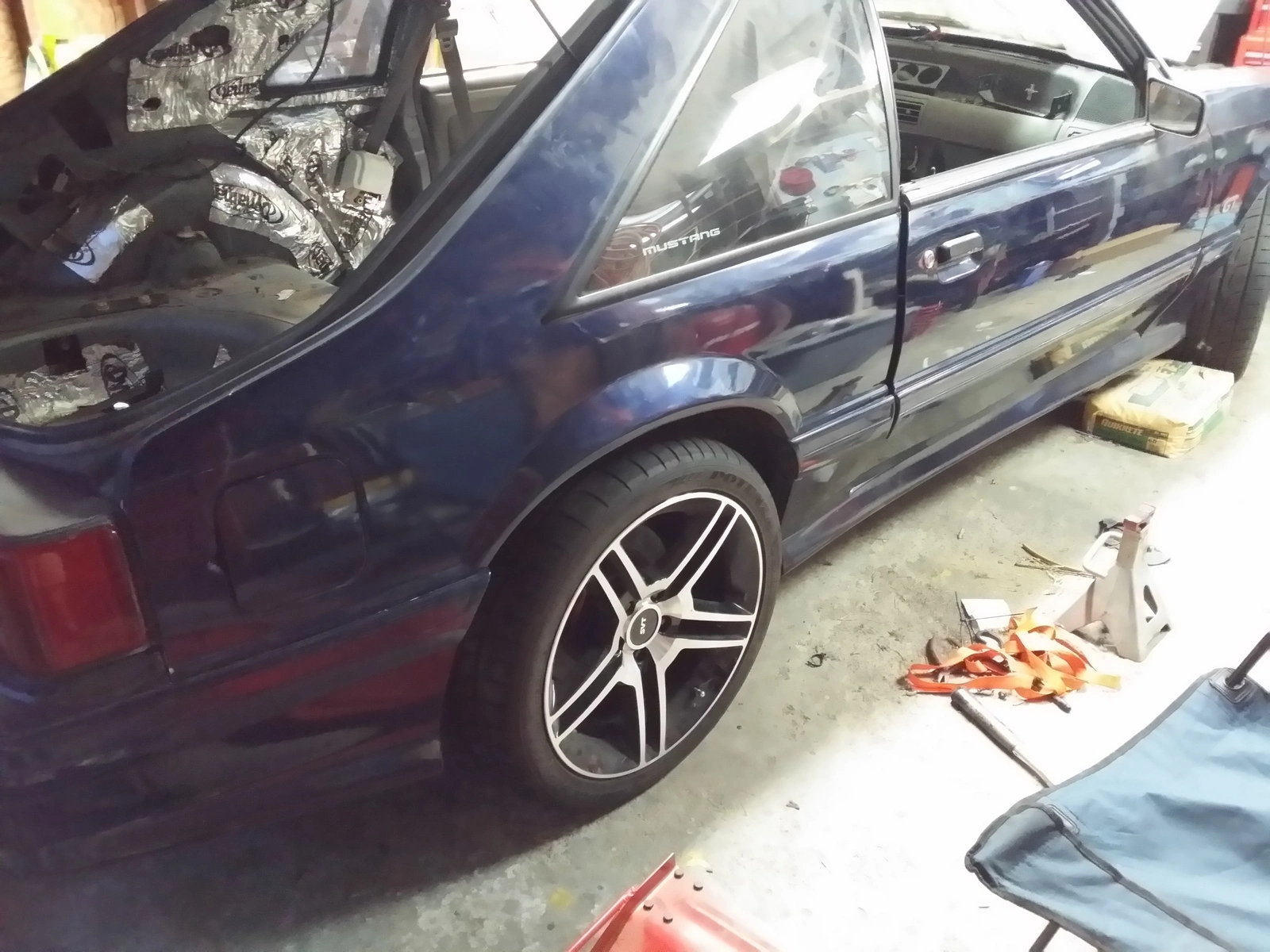

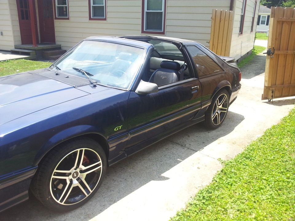

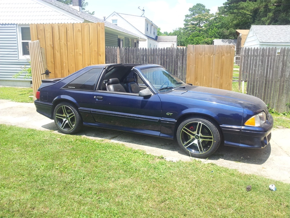

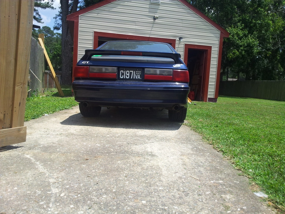

I tinkered here and there. Upgrading the GT discs in the back to Cobra discs. Also swapped the wheels for 2012 GT500 wheels. 2012 marked 25 years for the car making it possible to put antique plates on it. $50 one time registration, no other registration costs EVER, plus no more state inspection.

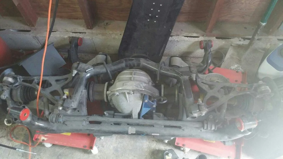

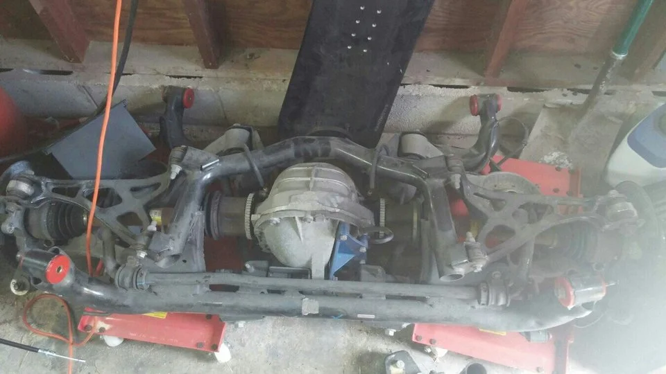

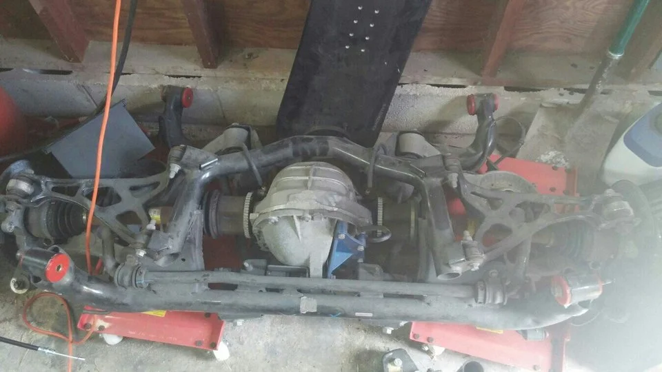

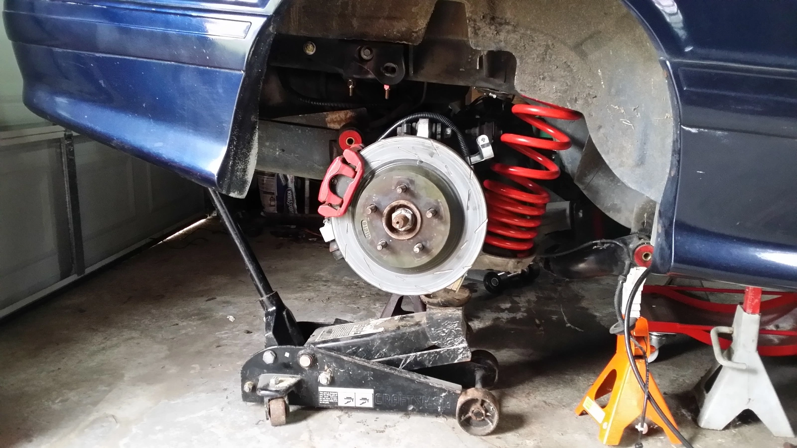

The last few months I've been swapping in an IRS unit from an '04 Cobra. Good bye live axle, hello modern cornering & 3.55 gears!

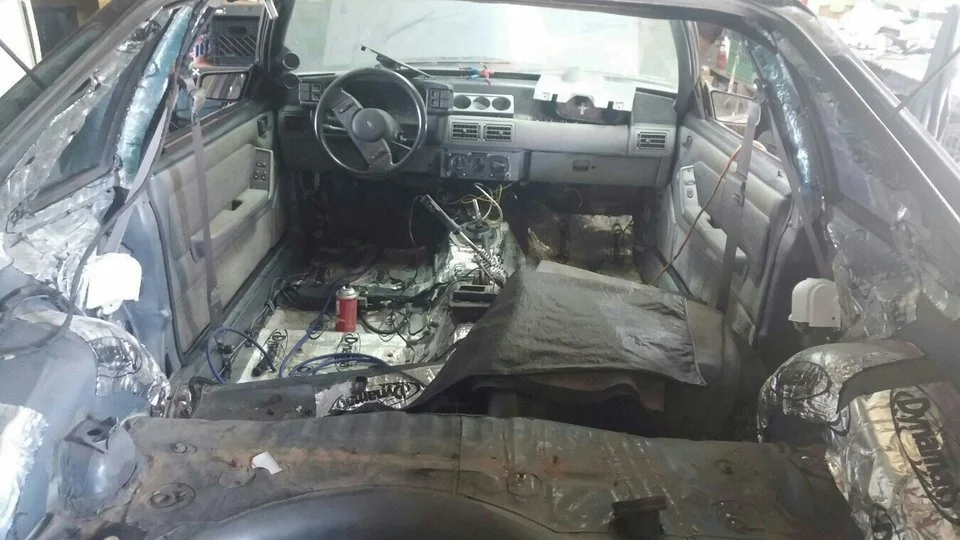

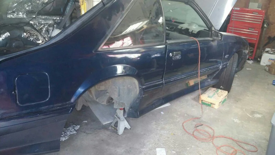

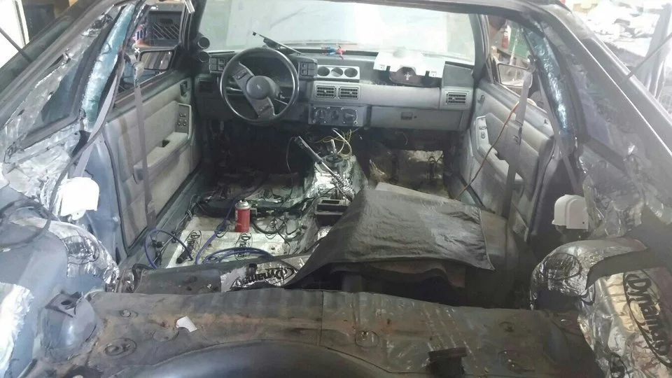

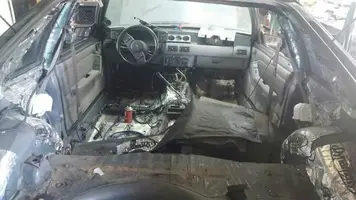

The other thing I've done is completely ripped out the interior.............again........for the 3rd time
Here's how she sits this very moment.

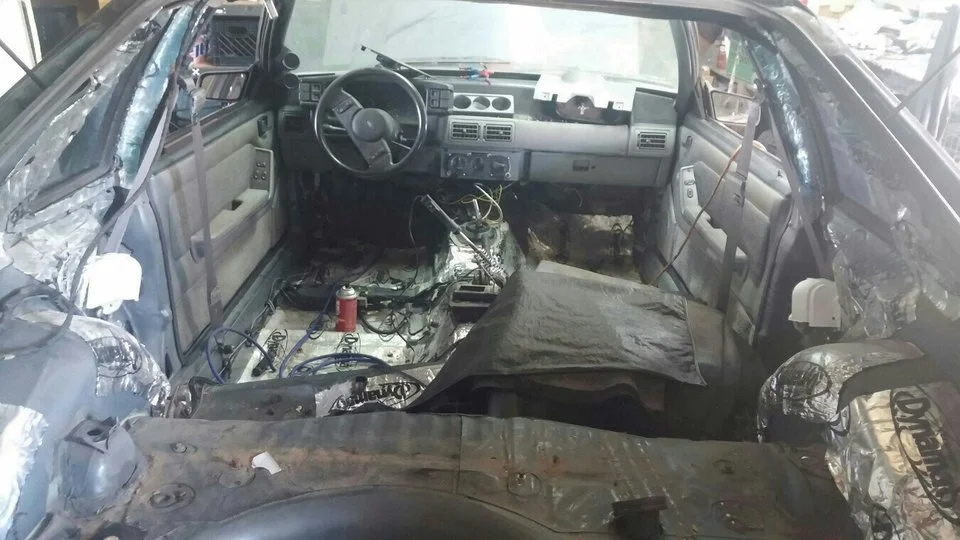

Basically, the salt water corrosion is still wreaking havoc on my electrical system. So I've replaced the ENTIRE body harness from the drivers side kick panel back to the tail lights.
At the same time I'll also be wiring for a 5-channel amp to run off of the Pioneer Premiere head unit and push the Infinity Component speakers that exist in all 4 corners. Once all the wiring is done, and the axle installed, its off to get a new catback installed (Thinking Borla) and have the carpet professionally fitted. Because the last time when I did it......uhm......no......
I want this to be the LAST time I pull the interior from this car. When it goes back together this time, thats it. It's done.

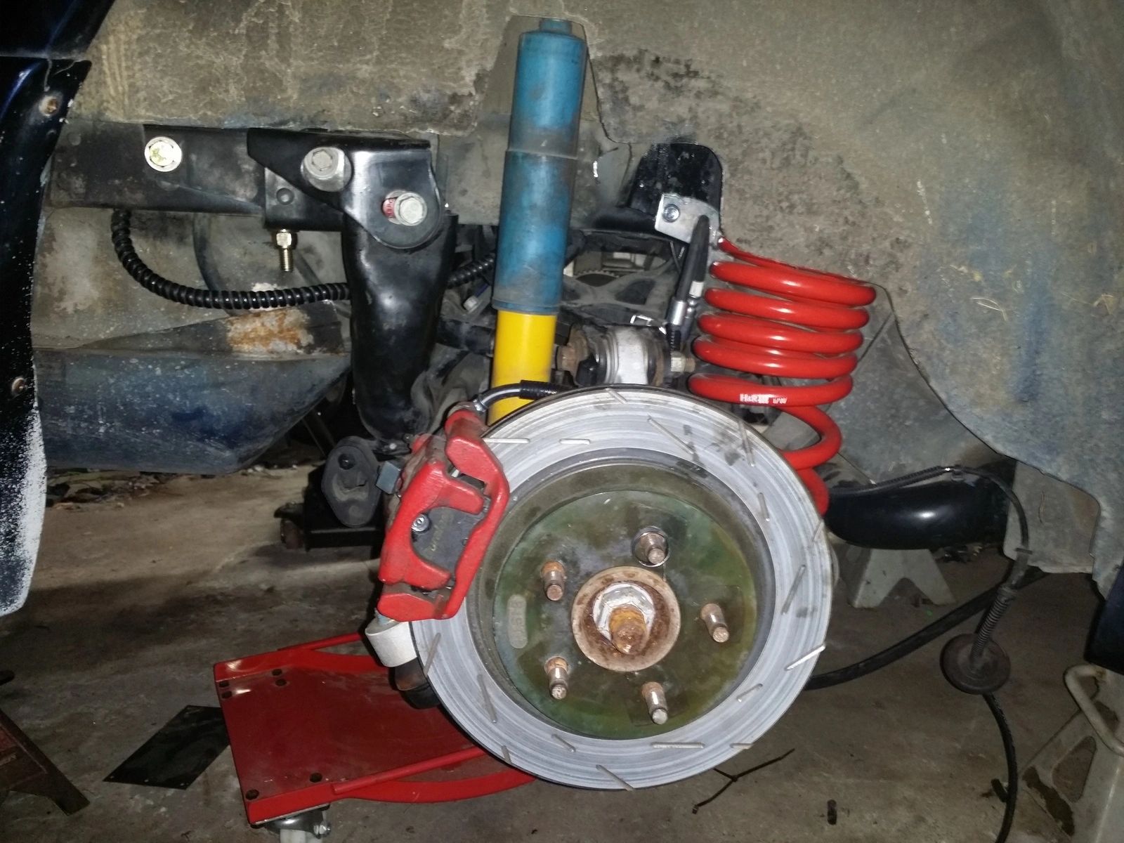

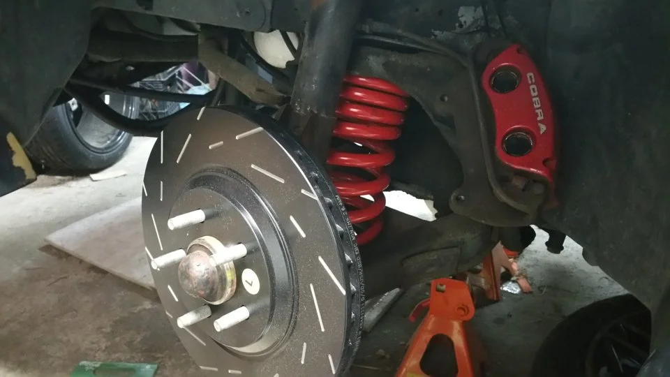

The FMS AL Driveshaft came in today, and I swapped on the correct flange for the IRS rear. Springs should be here by weeks end. I'm ready to put this thing on the ground.

I've got brand new H&R Race Springs that just came in today. So I'm staying w/ conventional springs for the time being. I want to do coilovers, but it's just not in the wallet right now.

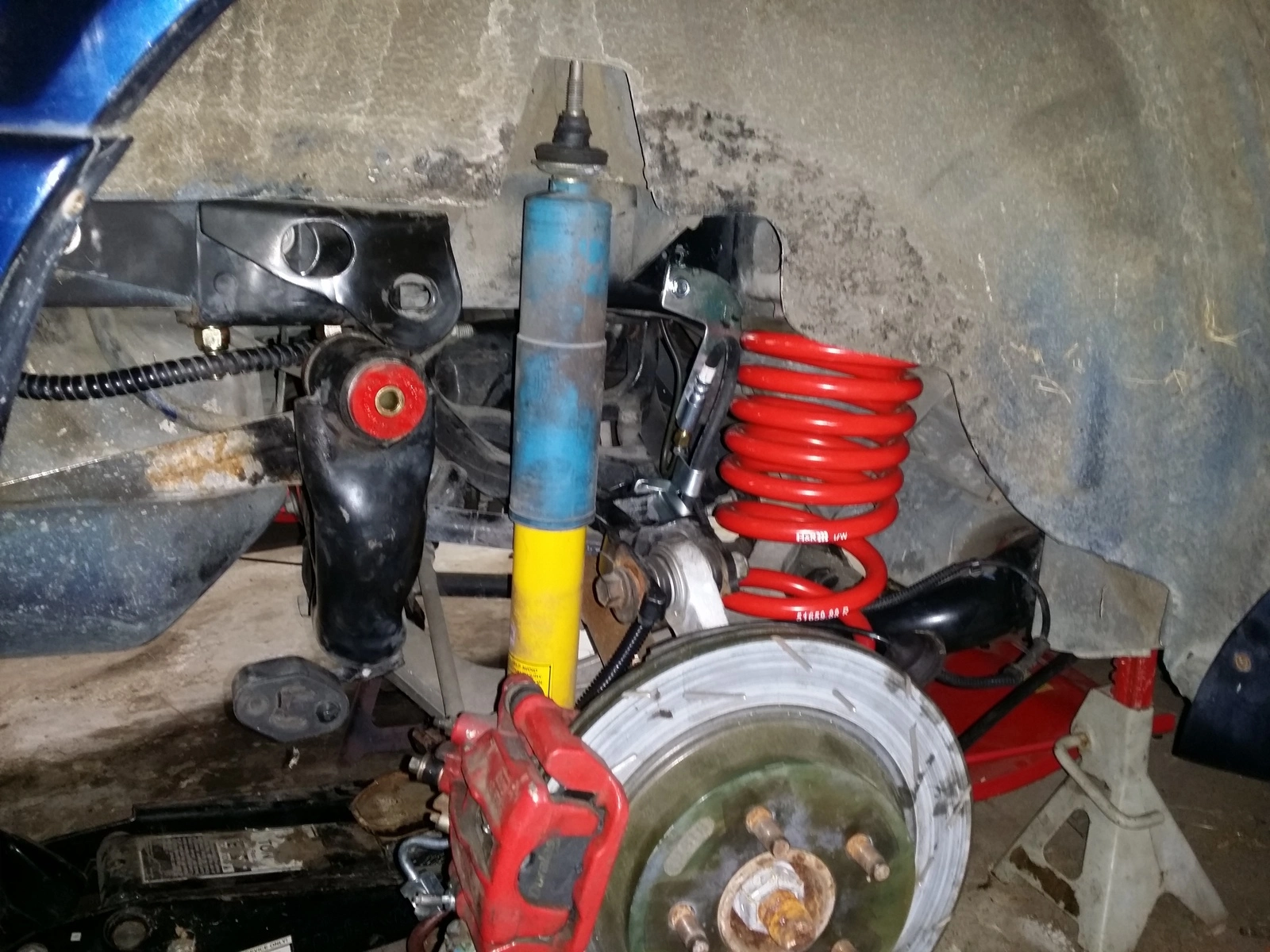

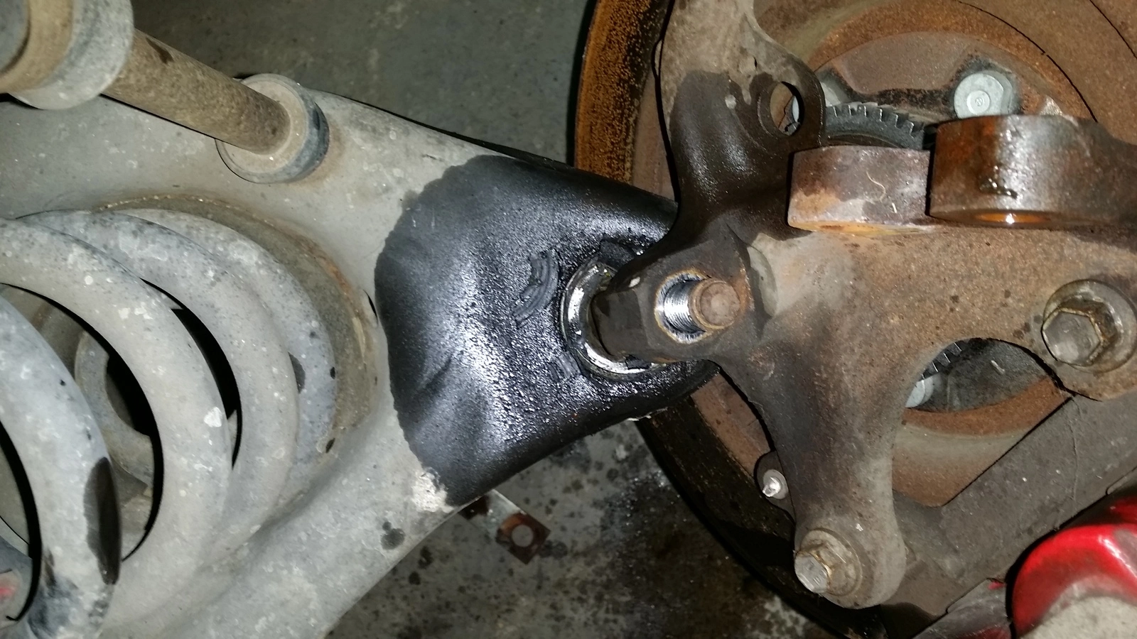

I started getting the brake lines sorted this past weekend. It took me forever to figure out how the factory Cobra lines were routed and attached. Now that I have it, it's time to drill some holes and bend some brake line. Hope to have those done and mounted this week. Then I can start to fit the axle underneath the car.
I have all the parts now. I just need the time.

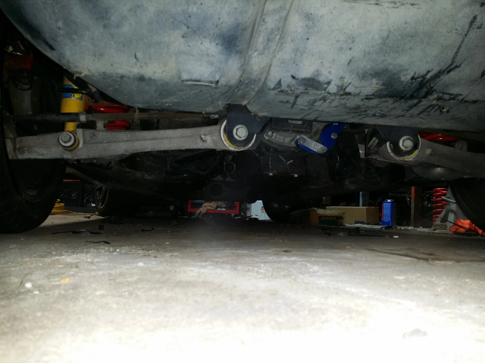

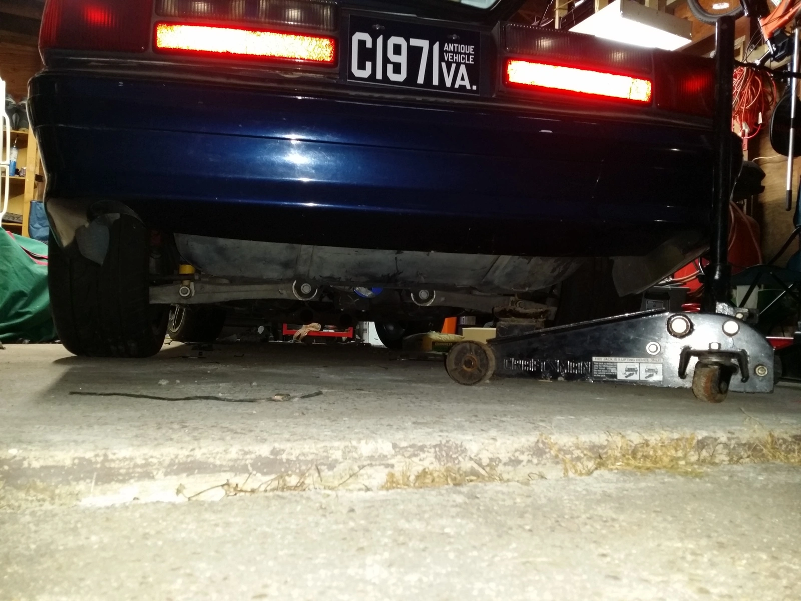

It's half way in. Got the front side bolted in. Got a slight problem. The fuel lines are in the way on the passenger side. I may have to drop it again and rearrange things. I'm hoping that I can get it sorted by leaving the front side bolted in and angling the whole thing down.
And yeah, I realized that I had the springs upside down the first time.
