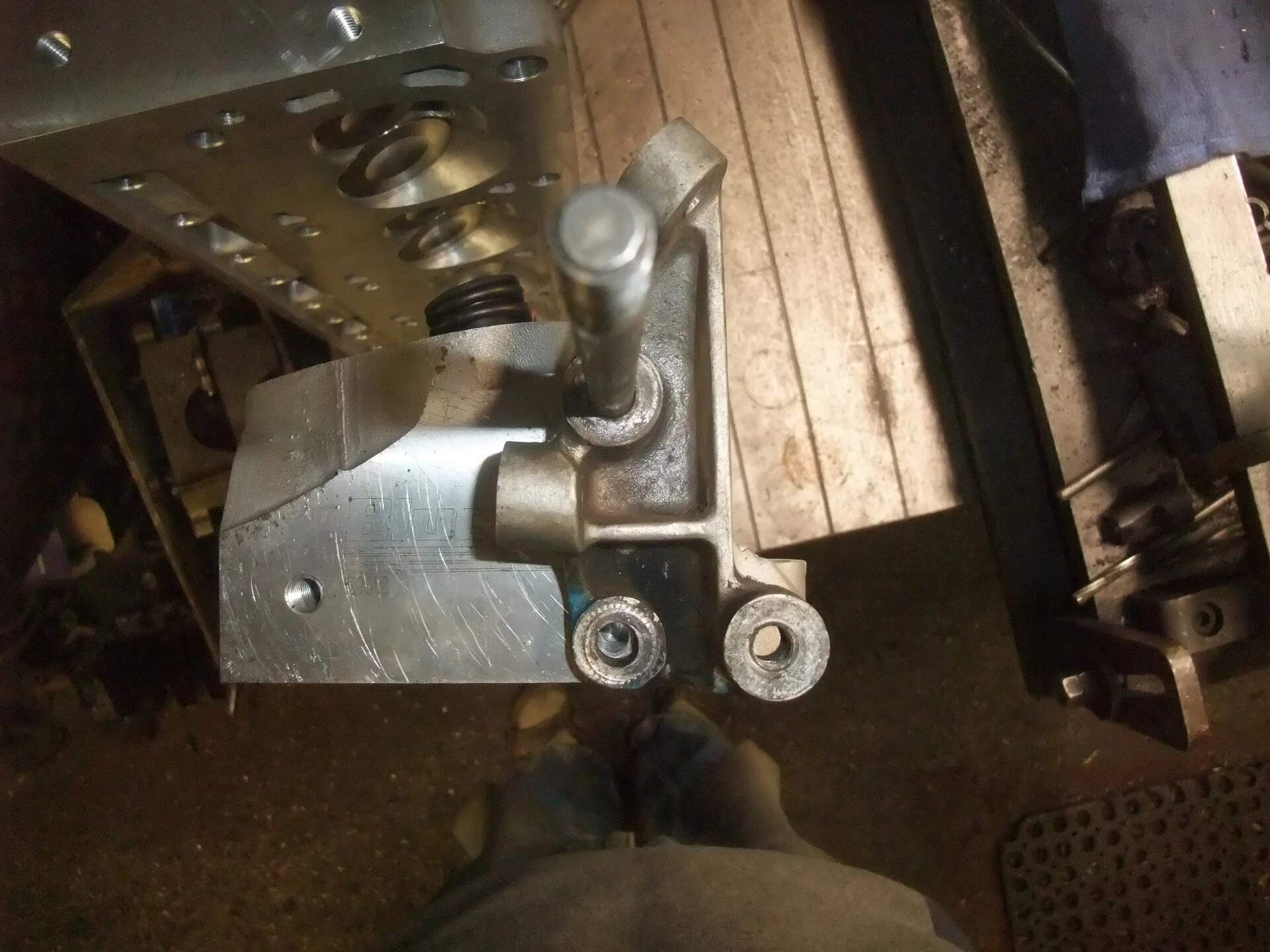

I think the bolt pattern maybe diff on the ends of one of the heads as soon as I get them back from the machine shop I will check. This seems to be the only reasonable solution.
maybe I called the machine shop and they say the bolt patterns are the same on the front of both heads if they were mounted on the drivers side. I'm going to take a bracket to them tomm, to get the bottom of this. If we need to drill a hole so be it.

Problem solved as there is no problem. The 1 hole in the upper right of the head is the needed hole, in the thermactor port location. The missing hole is the unneeded one. Sorry for the confusion.
