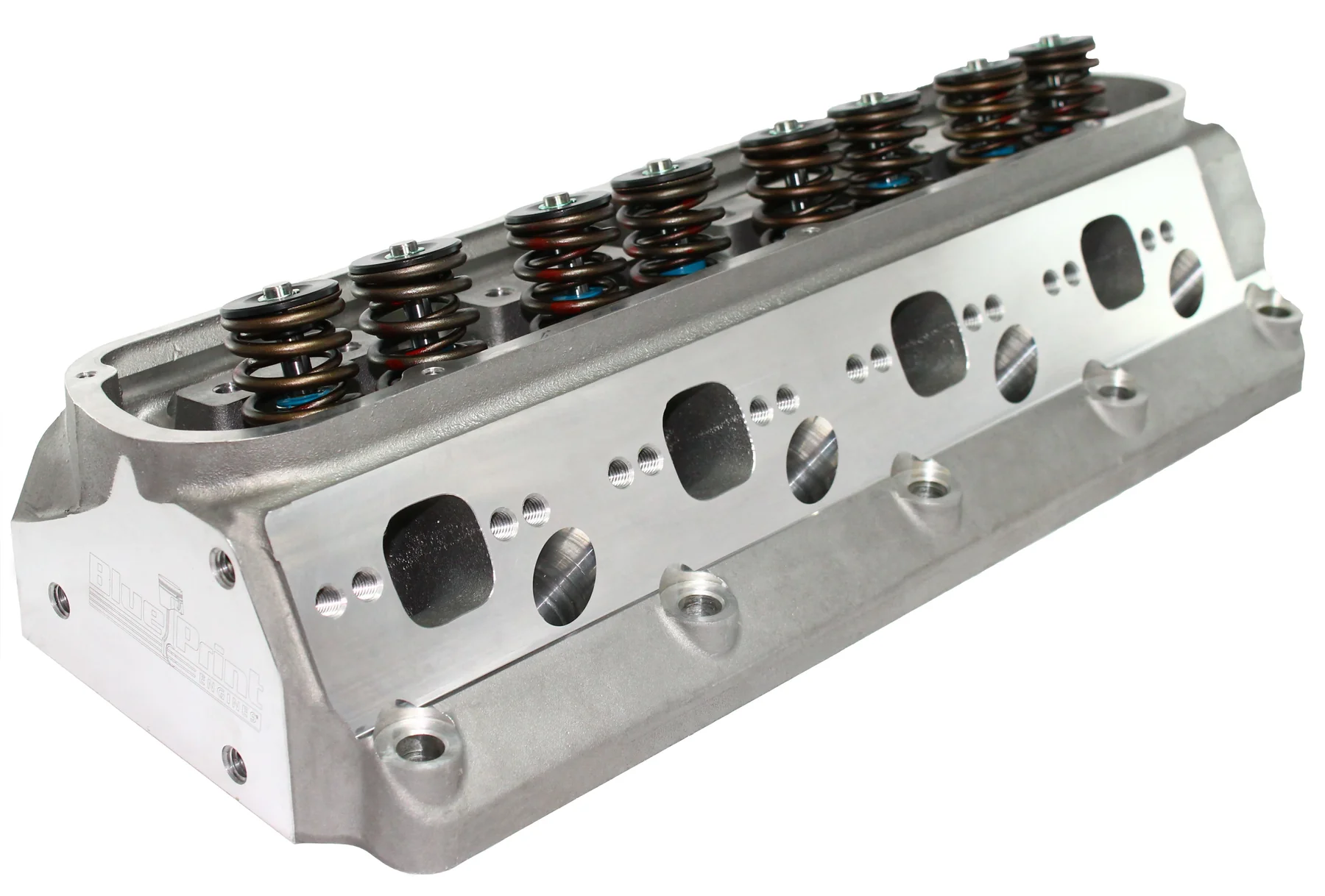

Make the Hole. I have done many things on cars and YES I do think that it sucks ass that it is missing the right hole, but in this case, you can create that hole yourself. I am far from the guy to get in there and make it look professional, but what I do is always functional. In the end it may not be pretty, but as long as it serves the purpose, then its all good.
If rick would have posted this dilemma in his engine build thread we would not be having most if not all these questions asked.
They are blue print engines heads, what actual castings they are I don't know.
Reactions: Potomus Pete
If the hole isn't there then drill and tap it. I haven't seen heads that don't have the hole for the factory brackets in 20yrs. Take the bracket, sit the head on the head gasket, and mark the hole with a punch. Only one chance to get it right and straight. If marked correctly, with a punch, a machine shop can easily drill and tap the hole.
Could even use the old heads to make a template. If you are confident drilling a straight hole you could do it yourself. There used to be a drill bracket out that guaranteed a 90° hole. Haven't seen one for years though.
Yes pics of a car assembled w/o using the air holes for the PS....not of my stock style Blueprint heads, that just dont have a thermactor/air injection ports. Head pic is posted further up and which hole I'm missing is described at least twice in great detail. Why is it so difficult to get a straight answer. I have NOT tried to reassemble the brackets w/o this hole, the solution maybe obvious. I just dont know and am asking a simple question....Why is so hard to get a simple answer?

OK Kid you stated earlier in this thread you have never done or have any 1st hand knowledge. Why should I trust you? I have all the stuff to drill and tap a hole....I just find it hard to believe this is the only cure.

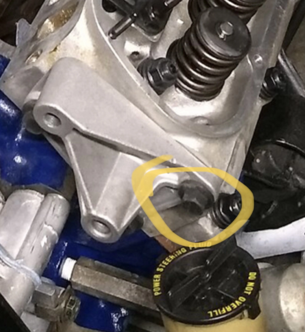

Are you saying this hole right here does not exist on the heads that you have? There’s nothing for this bolt/stud to thread into?
Even the responses you are getting on FB are the same replies everyone here has said.
That hole exists. I have the standard 3 holes just not a thermactor hole. The thermactor hole would be right next to it and slightly above it.....it is clearly pictured above in this thread.....that is a AC delete bracket.....no help to me.
