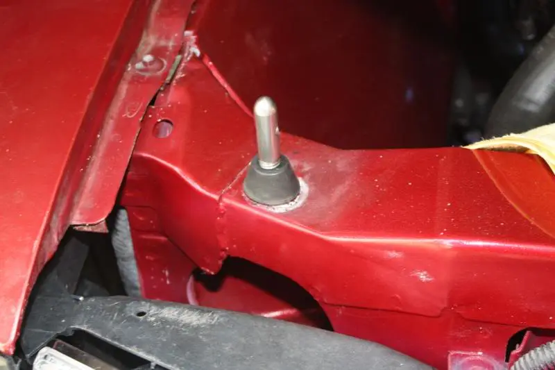

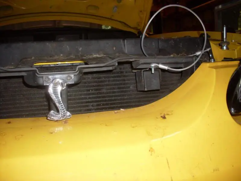

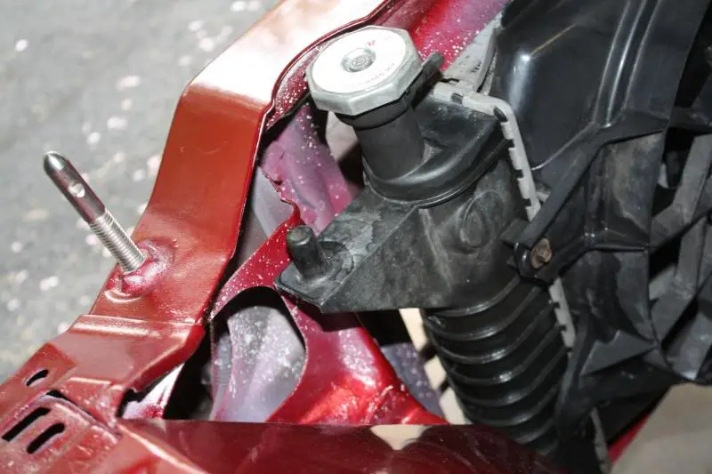

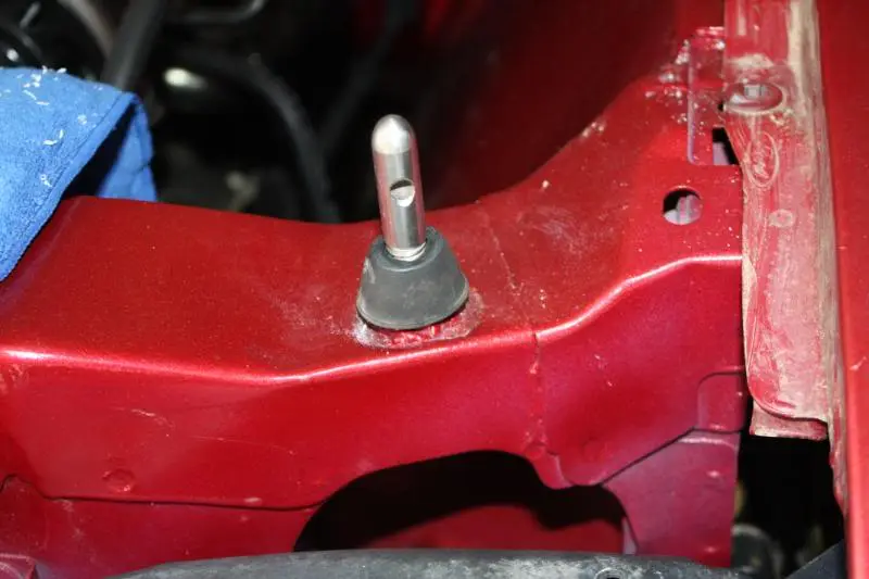

  • #22
Venom351R said:
Yeah I was wondering about the fogging in the cooler temps. I'll deal w/ that when the time comes. I'll give you a call tomorrow after I get out of work about saturday.
I assume you can still use the latch, I intended on it.
Do you have any of under the hood where you mounted the pins?

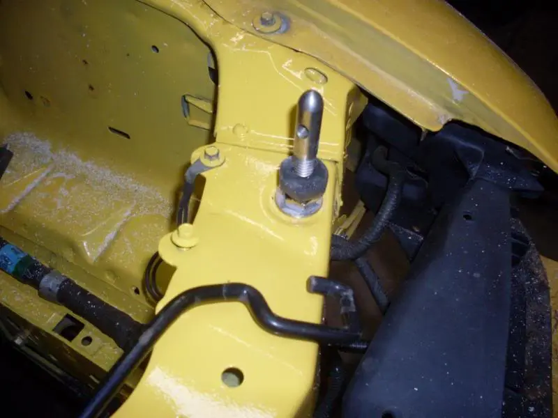

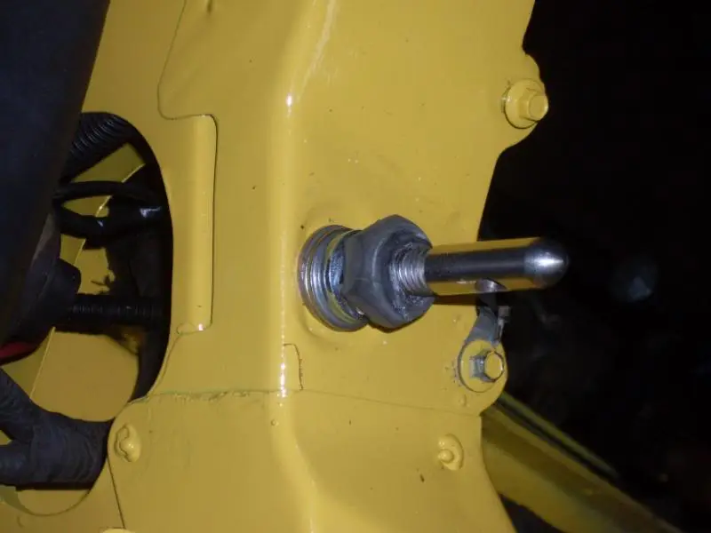

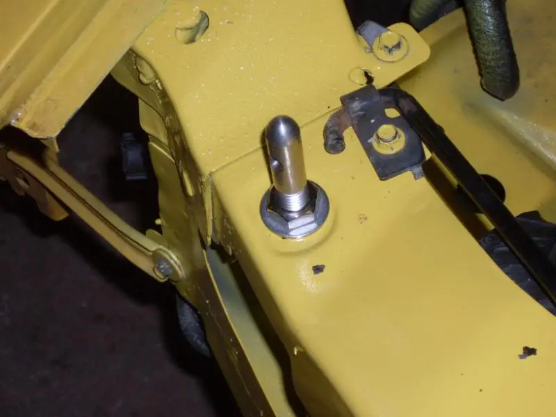

My latch was nasty looking... i deemed it unfit to go with the rest of my engine bay.
I welded my top nut to the metal... just tapped them lightly with a rubber mallet to straiten them out.
i lost my stops so i used ones from a FC rx7 we had in the yard.
i cut a small slit in the underside of the hood to get the striker plates inside. then riveted the top plates in place
You can see the holes i had to cut in the underside to get the striker plates up and in.
The yellow car is my best friends cobra.

oh so you put them through the factory holes where the hood stops were?
From what Ive been reading your are suppose to use the hood latch unless you are running a total of 4 pins, 2 more in the back.
Adam95GT
Aug 14, 2006
2,564
Burlington, NJ
Mar 30, 2010
#24
  • Mar 30, 2010
  • #24
yea turned the pins in to stops.

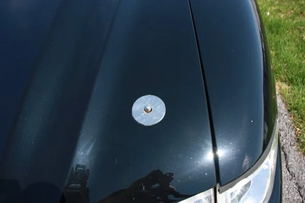

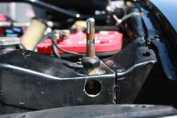

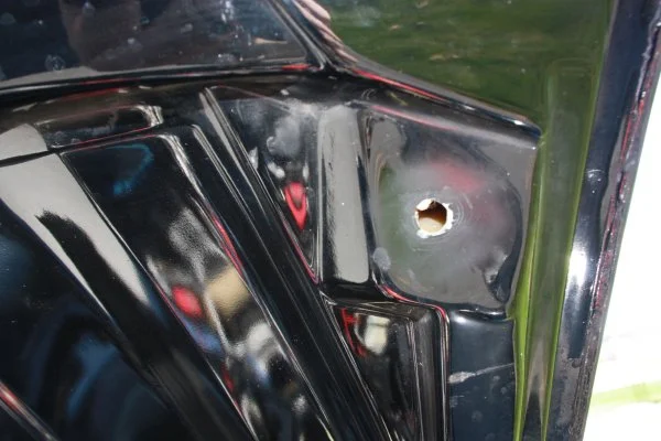

i still use my latch. If not, then anyone can walk right up and pop your hood. at least the stock latch has a locking feature. i can get pics similar to Adams if you want them.
you can see they are also mounted in the stock bumper stop location. i think the bumpers are the stock ones drilled out actually.

underside of hood
the back of the rail hasn't been touched.
