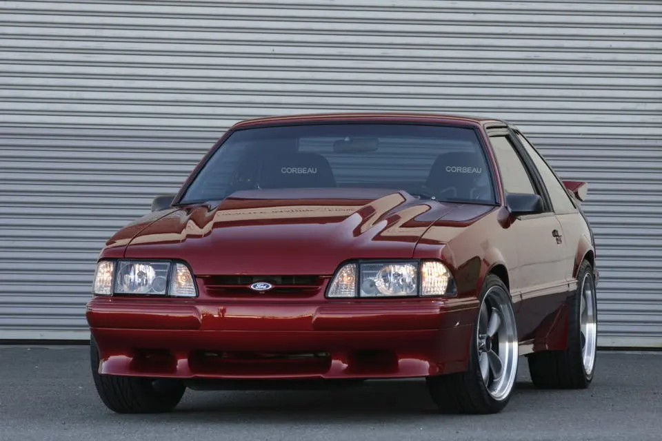

I personally have a cobra R replica hood from cervinis, that thing fits so well. I have gone over 130mph multiple times and had zero issues.
thats one sexy fox

matador91, thats one of the hottest Foxes I have ever seen! love the color, love the hood, and I am really leaning towards a Cervini hood. The fit and finish of their hoods seem to be far and above the rest on a CONSISTENT basis.
