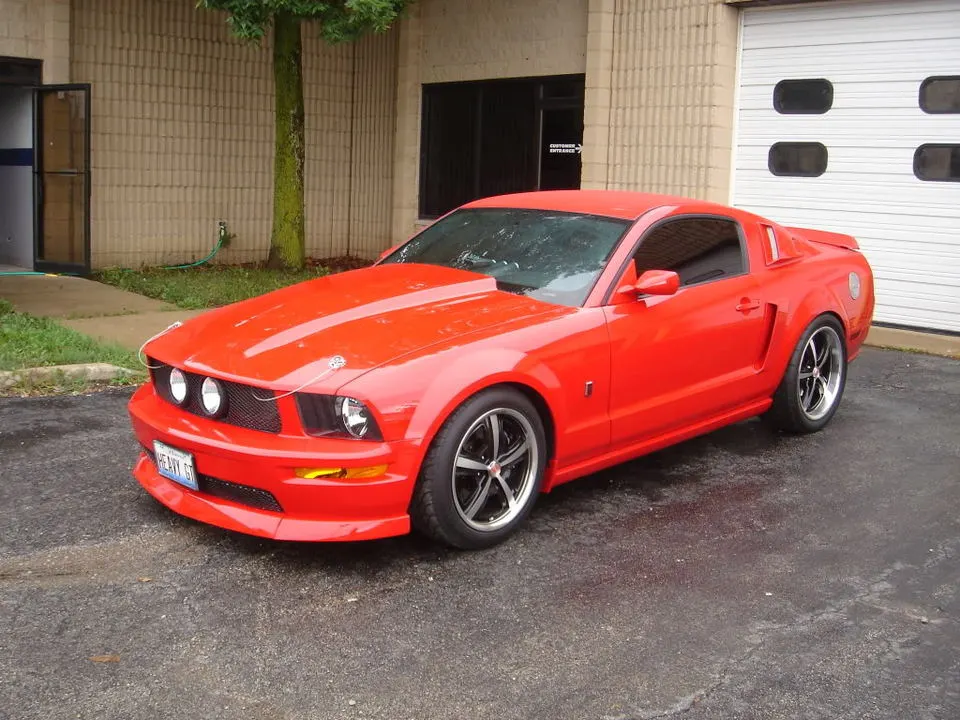

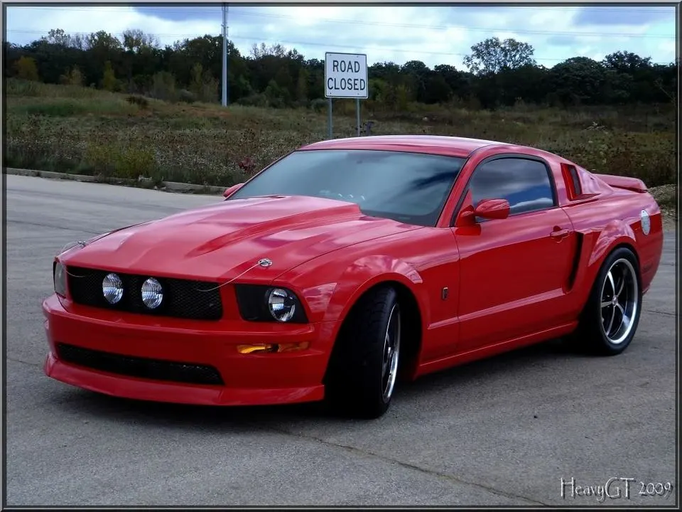

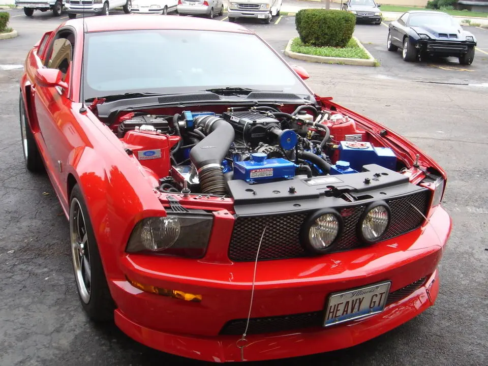

fyi...love my BBR 3" cowl hood by Kaenan...best fit and finish and I had a cervini hood previous...

I don't think that hood is going to work with a supercharger. I've heard fitment issues with them since it's actually lower than the factory hood in the middle.

As far as fitment with the Roushcharger, I had the stock hood when i put the R2300 on, no problems. I wouldnt see the heat extractor hood having any issues. I agree with everyone about Cervini's. Had a 94 with Cervinis hood, and the 06 has one. No issues at all.
