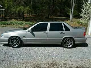

if your volvo was anything like my S70 you wouldnt hear anything inside of it anyway... i loved that car till the timing belt came off.
