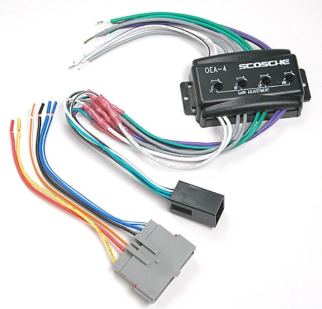

You don't have to replace everything if you just replace the Head Unit. You can buy an adaptor from Crutchfield that will let you adjust the outputs to your amps. I did that and it works perfectly. And Crutchfield gives you instructions with it. I'm running an Alpine CDA-9855 with the rest of my stock Mach 460 system and it sounds great.
http://www.crutchfield.com/S-3NjZU3JrAFl/cgi-bin/prodview.asp?i=142C4FDK5
This before I "plug" the lower hole in my car from the '98 Mach 460. I'm more than willing to help anyone with the wiring I had to go through. If you post and I don't reply, PM me cause I'm don't always frequent this forum.

You don't need that massive adapter from crutchfield if you get a headunit with enough preouts, You can just get a ford premium wiring harness and solder some rca's jacks to it and plug it into your preouts. I think there is a harness out there with the rca's already prewired but I can't remember the make and model. Plus, this way you will get a purer signal bypassing the distorted head unit's amp. I've had mine hooked up this way since 97. do a search, this has been posted a few times.

you cant connect speakers to preouts. and the "solution" that you offer sounds a bit complicated. Why would anyone want to do it the hardway when they can just get the crutchfield harness?

Unless you're going to bypass your amps you'll most likely over drive them with the method you're suggesting. That's why this isn't just a harness it's a set of potentiometers so that you can adjust your head units output to best match your amps. Plus, no soldering and rca fittings required. Just my $0.02...

nope, Never had a problem. The output levels seem to work perfect. like I said I have been using this setup with Hi voltage preouts since 97 with different head units (clarion, kenwood, jvc, rockford) with not one problem using the factory amps. If you get the harness with the rca's, you wouldn't need to solder or crimp, just plug in the rcas from the back of your headunit. Gdawgs method works fine also but I would rather use the cleaner signal from the headunit's preouts.

you aren't connecting it to the speakers, you are connecting it to the factory mach amps. anyone who has a decent knowledge with electronics can solder 2 pairs of rca's to a harness. nothing hard about it. I choose this method because I prefer the cleaner signal from the preouts rather than using the generic head unit's amp's signal which feeds to another amp amplifying more distortion. Just my opinion though
