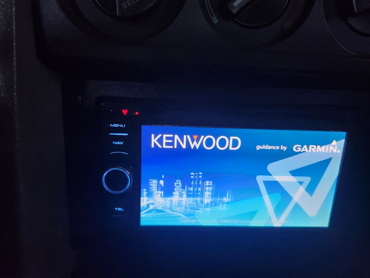

The P.O. has already updated the stereo, but some parts have been removed.

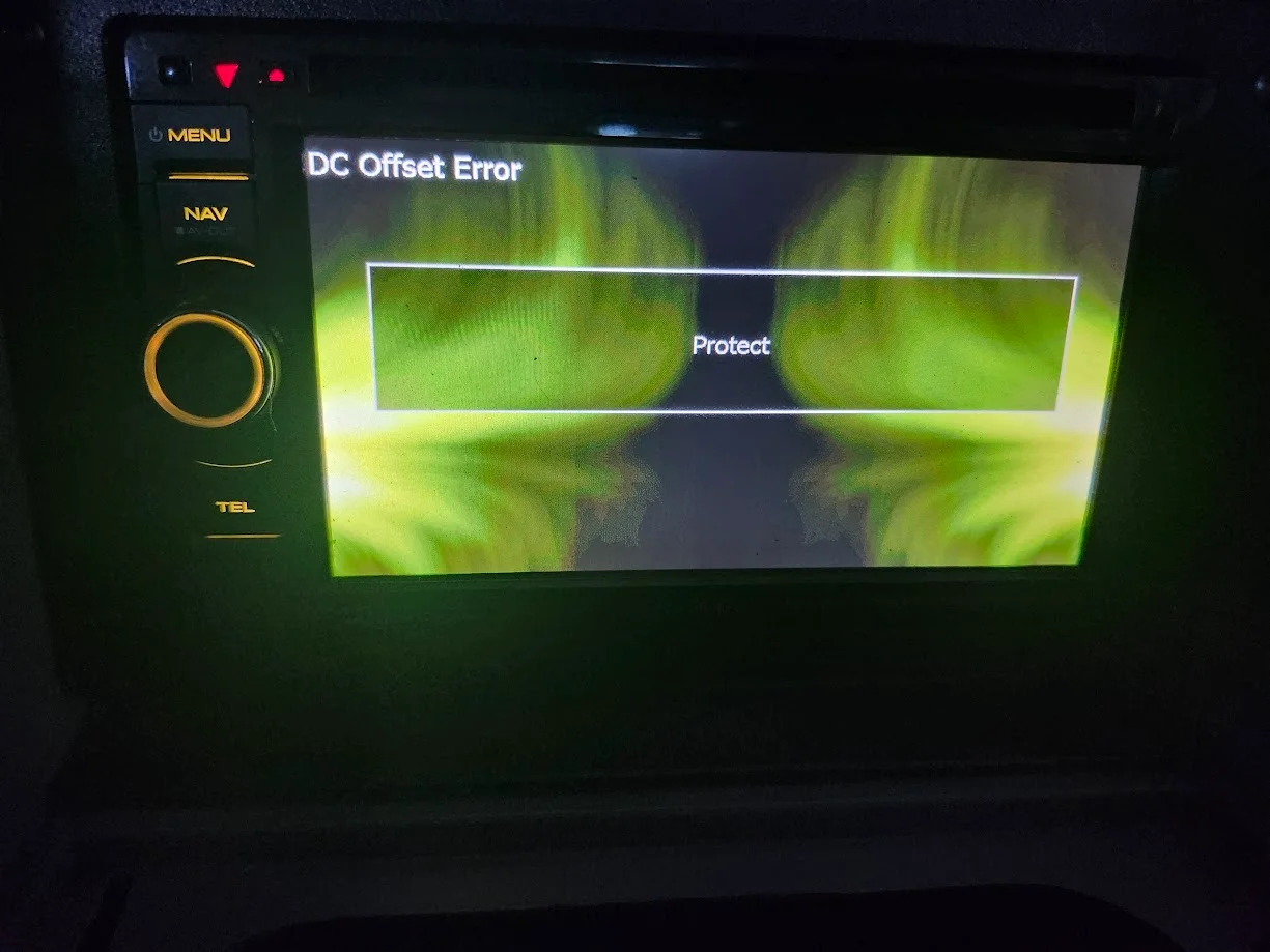

I know it has satellite tweeters in the dash, replacement door speakers, and rear quarter speakers. There's a Kenwood head unit in the dash that is in protection mode. Probably because there is some equipment missing from the trunk area.

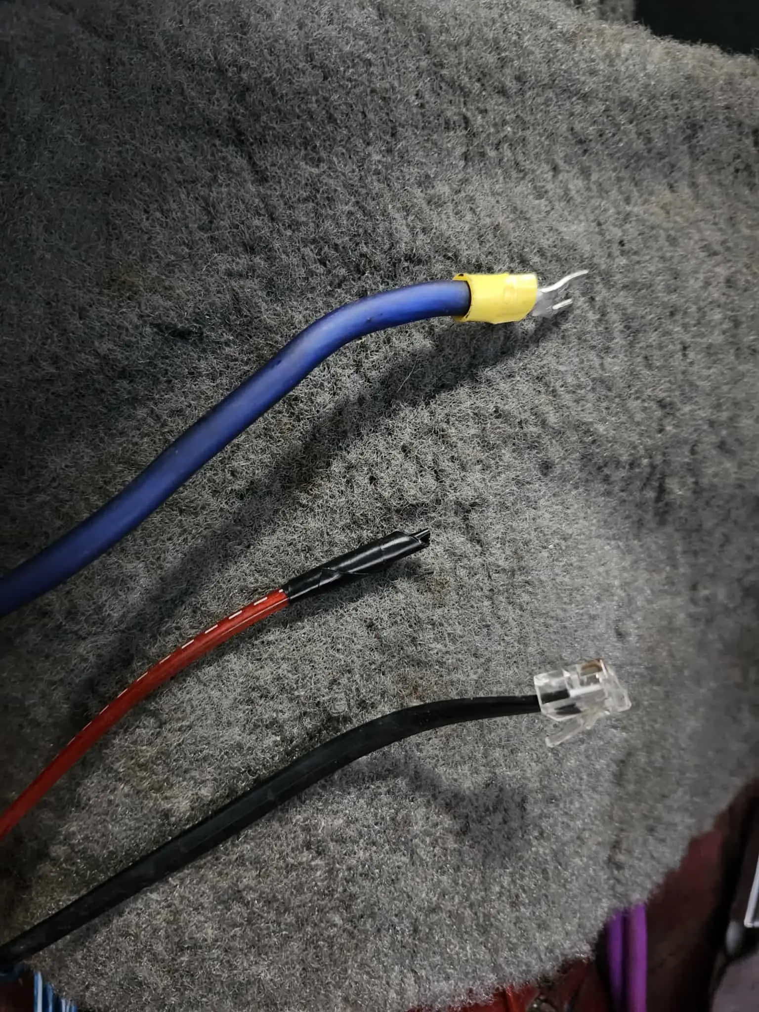

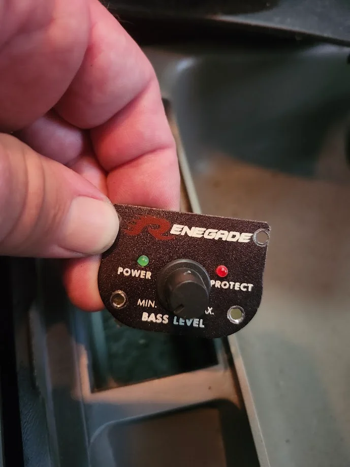

I know there was a subwoofer, because there's a knob by the console and I can see the remote wire (the one that looks like a phone plug). Was there also an external amp?

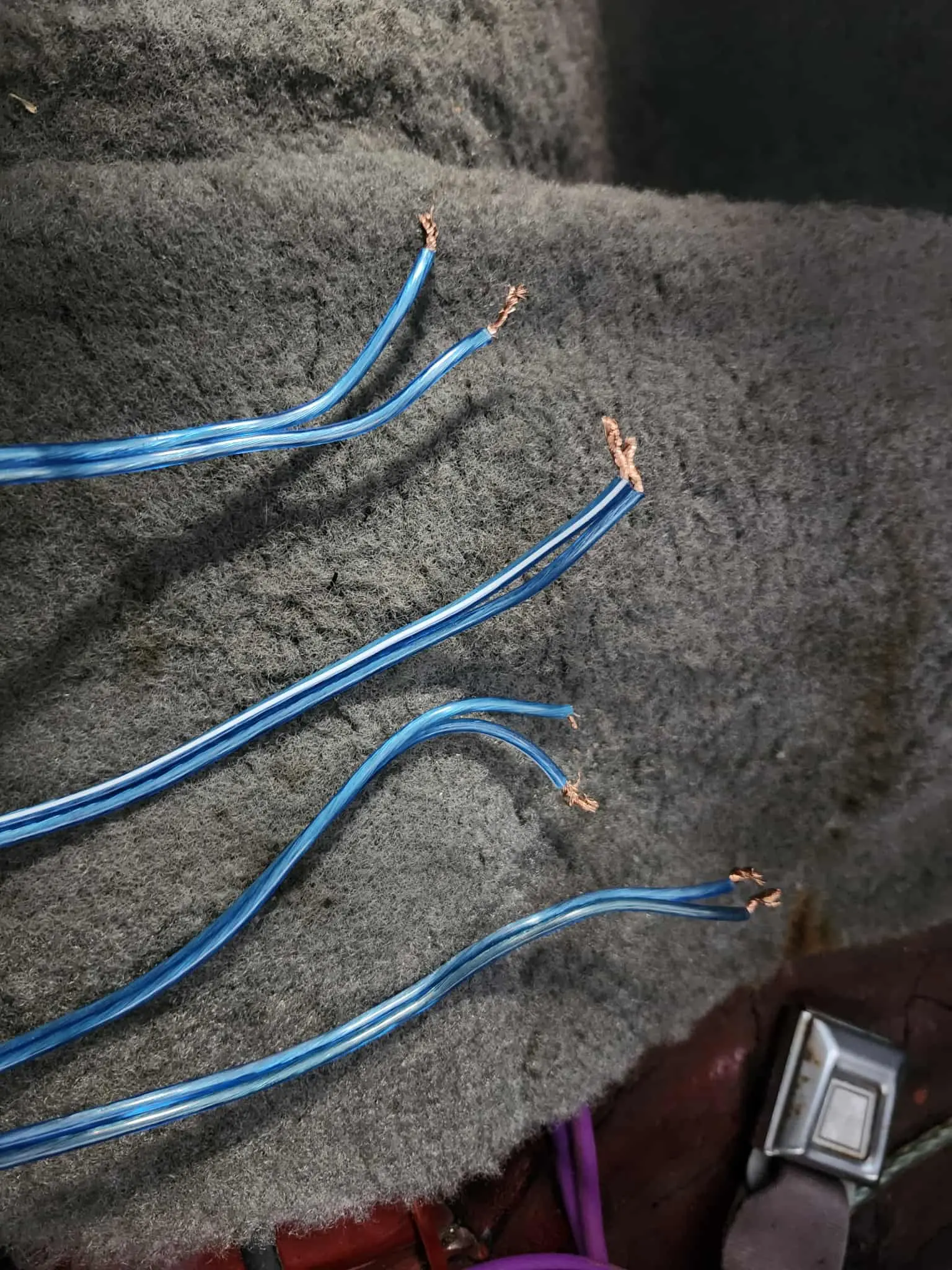

- 4 speaker wires

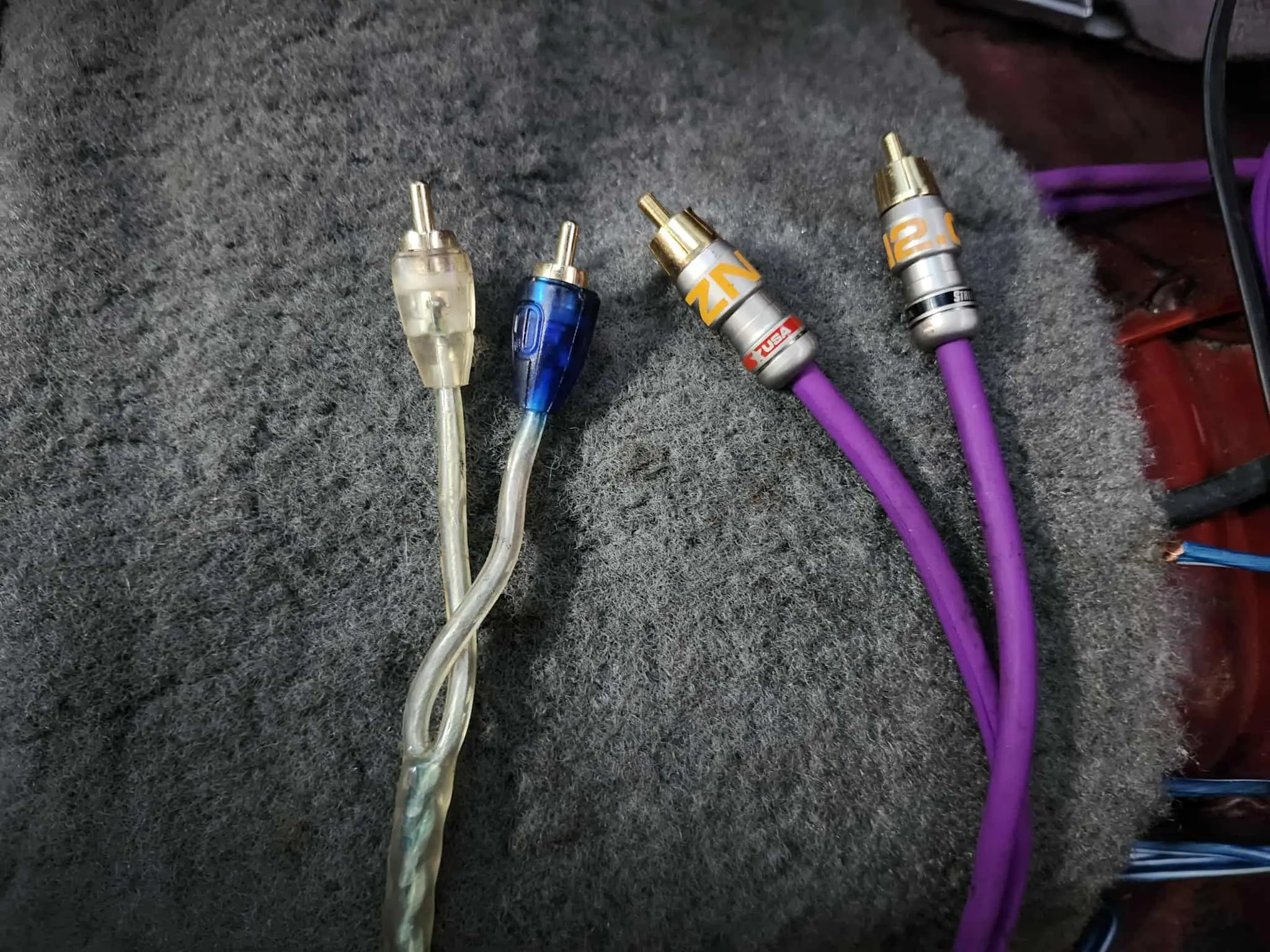

- Two RCA wires
- the subwoofer remote and two other wires; power and ground, maybe?

I’m gonna go out on a limb here and say that what was in the rear hatch area will have no effect on the head unit being in protect mode.
I would pull the head unit from the dash and see if it has the ability to power speakers and if so make sure none of the wires are grounding out.
I talked to the stereo shop. He said it had a subwoofer and amp(s). He said that if any of the bare wires touched, that could cause the head unit to go into protect mode.
