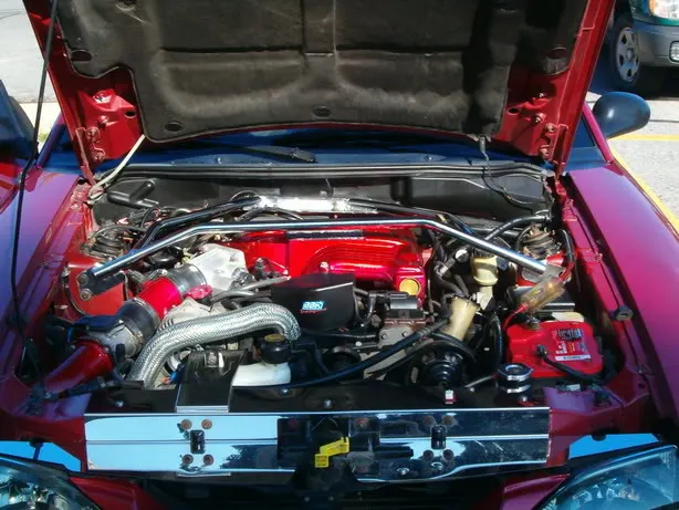

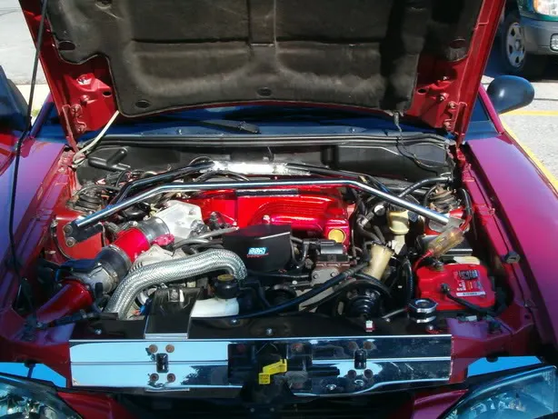

Let's get some pictures of my BBK Gripp Series STB up...
This STB seems to be about the same height as my stocker, but it's on an angle, giving more room for height on the driver side of the engine bay than the passenger side, but still a solid 2 inches on the passenger side to boot. If you're going to increase clearance by 2 inches, then you'd have a problem, but if not, you're good to go
:nice: that one looks like it might clear a k/b, hmmmmmm

I agree urban, but how much further does the stock manifold differ from from a GT40 intake? Anyone have any distinct measurements? I'm not sure exactly how much bigger my BBK strut tower brace is compared to my stock peice, but it doesn't look like much

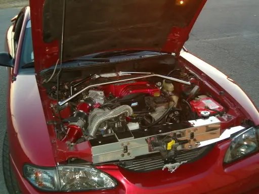

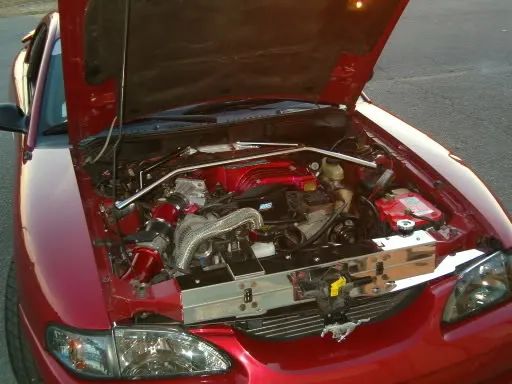

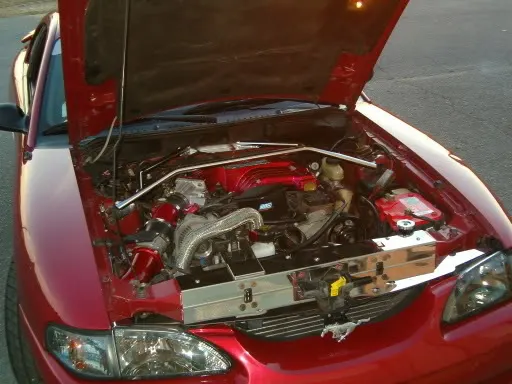

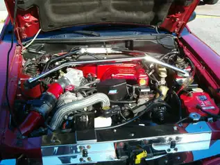

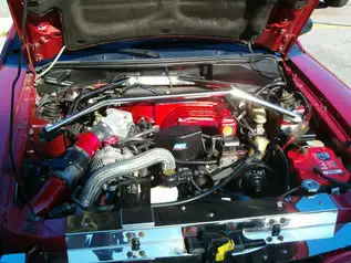

Here's some more pics that might show some more clearance, don't mind the dirty engine bay

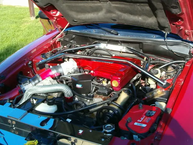

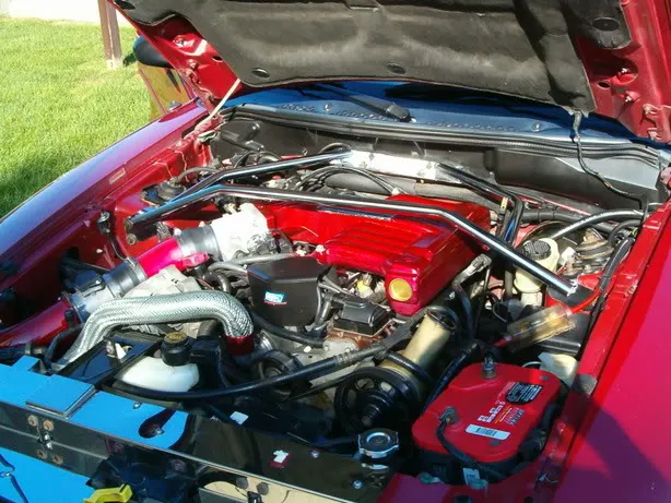

as far as the strut brace goes, i got mine from steeda. it goes around the intake. here is a pic.....
