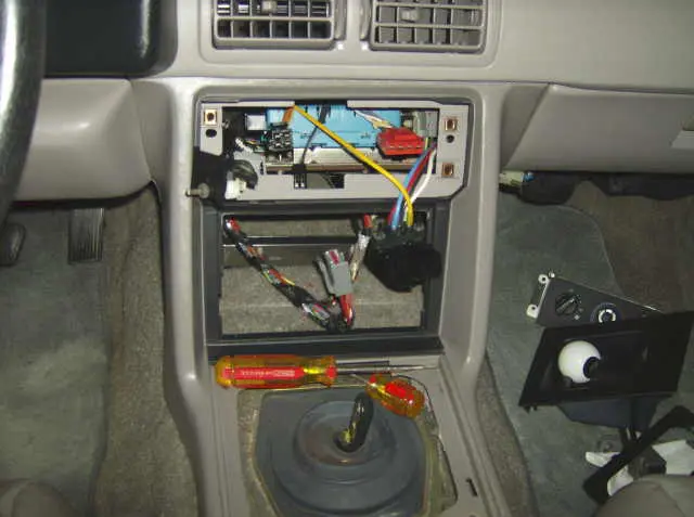

I am having a similar problem with my 92. That website is very helpful, thanks StangGT. Here are a few things that I have found that helped. The airbag control module is located behind the AC controls. It is a small teal box, I removed the AC controls, radio and center console to reach it. From what I have read there is a thermal fuse inside that might have gone bad and needs to be replaced. This can be done by soldering a new fuse in. I am going to try this and will keep you up to date.
Here is a link to a Ford Probe forum that a guy has replaced the fuse. It has very good pictures and steps showing replacement. http://www.ukpoc.co.uk/forum/viewtopic.php?f=2&t=46185&start=0
Picture of Airbag control module location
Hope this helps
