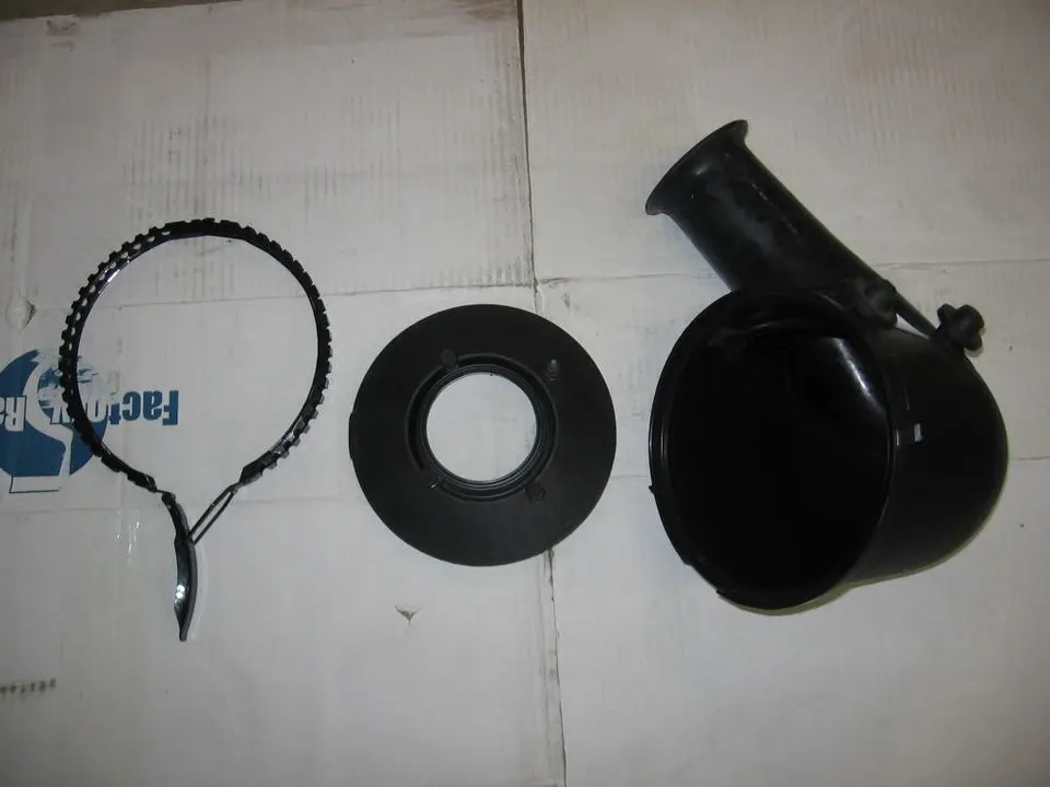

The OE setup looks like this in parts:
The center part is attached to the MAF housing with 4 screws. The filter is fitted to it. The large housing then slides over top of the assembly (sandwiching the filter rim in place) and the large "snap ring" fits over the plastic parts to hold them -- and the filter -- together.
And yes, there is a screen in the OE assembly. It fits between the MAF and the center piece before the 4 screws are installed.

That would be the clip I was referring to. All of the diagrams I've seen leave it out. It explains why it fits so loose since it's intended to go around the housing and not the filter itself.
