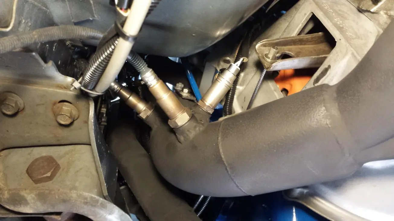

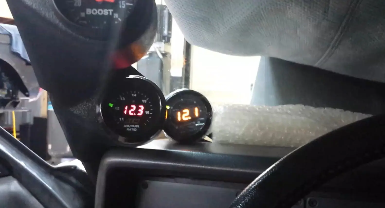

How I mounted mine in a single turbo, 3" downpipe on my Capri.
I was always curious how accurate widebands are, so I bought
two different brand kits, and ran them next to each other.
Pretty close (cold start)
http://luxjo.supermotors.net/CAPRI/EEC%20QUARTER%20HORSE%20TUNER/WIDEBANDS/20190721_121127.mp4

Thank you so much for those pictures OX1!
Reactions: OX1 and GOvert

I've been told the Innovate controls/monitors the heater circuit better than the AEM.
I know the AEM starts working faster than the Innovate. Not sure if the Innovate does not want to
display until it thinks heater circuit is warmed up enough??
The Innovate digital display is larger, but I still think AEM is easier to read (crisper, maybe)
They are both about the same price and as I posted, read pretty much the same A/F.

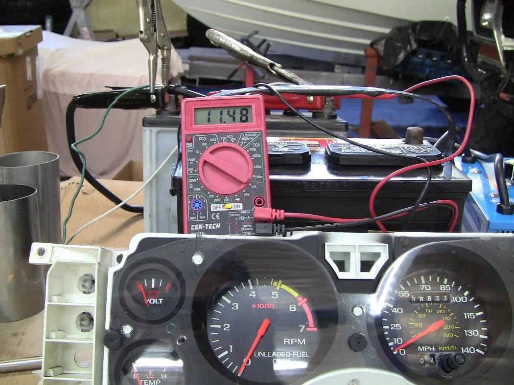

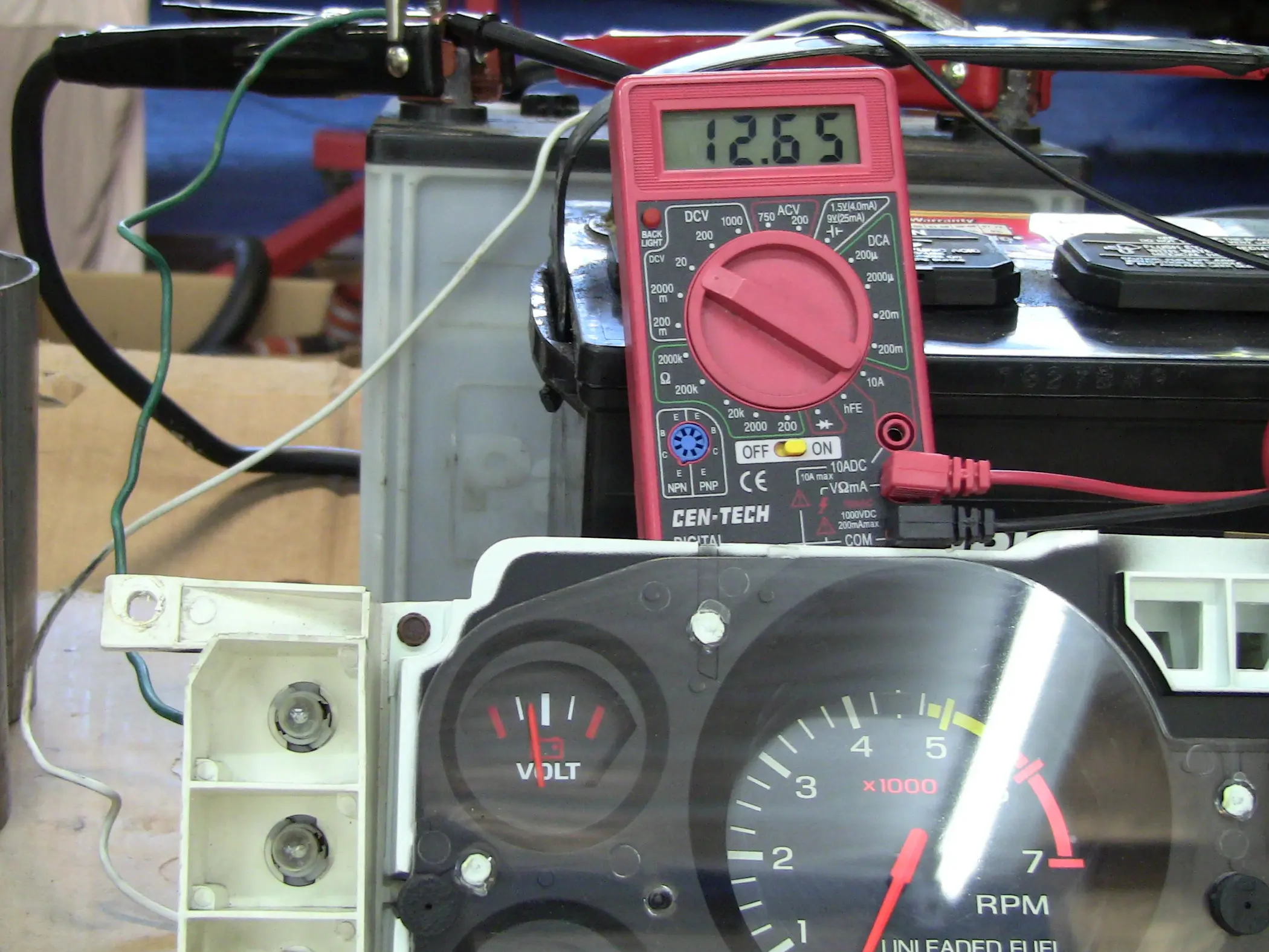

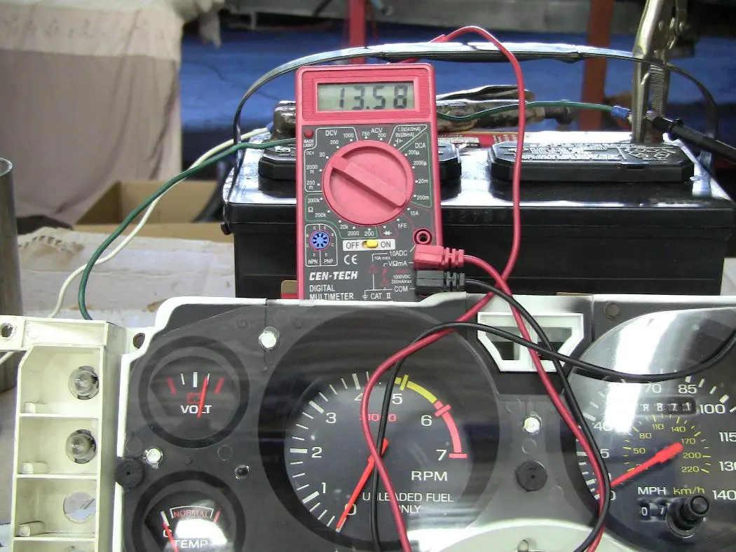

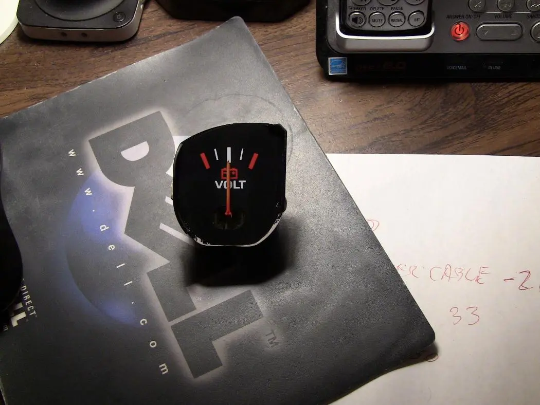

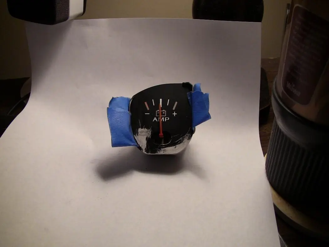

Normally I agree, but A/F just seems harder to read analog to me, especially idle/part throttle when it is bouncing around a lot.
That said, I did put a lot of work into my factory looking "analog" voltmeter, for 86 guage setup.
(in addition to stick on face I designed, I had guts replaced with an actual voltmeter with the correct sweep)
Reactions: GOvert, Blackhawkxx and DadLife0724
