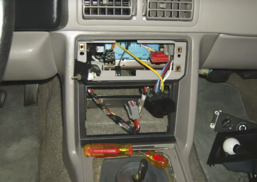

I hadn't started my 1990 GT in about a couple of months and yesterday after charging up the battery I fired it up. Everything seemed good other than my Airbag light was blinking. What are the most common issues that cause the light to blink? Is it anything to worry about it something I should address quickly?

The airbag blinks are actually a code. You can look the code up here based on the blink pattern you see. That will help narrow down the cause.
Mustang 90-91 Air Bag Diagnostic Codes
Unfortunately one of the most common failure points these days is the power supply module failing. I believe there are folks that can repair them

The power supply module, is that just for the airbag or the car? Basically wondering if this will cause my car to be down in the near future.

Airbag only. Blue box mounted behind the HVAC controls. Won't affect the ability to drive.
