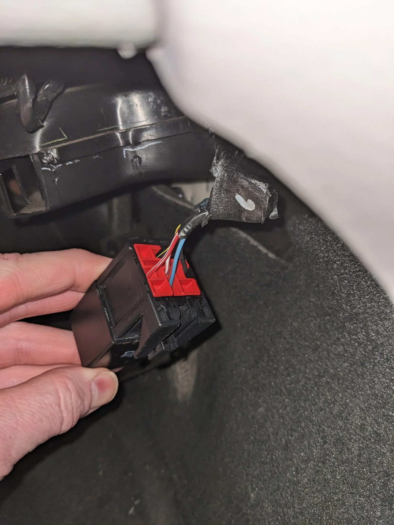

I noticed the same when I replaced mine with an EP27 to prevent hyperblink with LED bulbs. Seen other forums with the same question on other Ford's like Ranger. I assume it is a no connect or extra ground/pin on the stock one, since there are only 5 wires going into the connector (Blk, Blk/Y, Blue, Red/Wh, White/Red). Mine has worked fine, Haynes manual also shows only five wires into it.

Yes so it didn't really matter the 6th prong, I just got a replacement from rockauto and installed it and it works like a charm, thank you so much for the help and info, im new to all this forum stuff so my apologies for the super late replies and for my lack of knowledge about this, new to the mustang community hehehe. Thank You very much tho dude, helped me alot with my doubts and second guesses!
