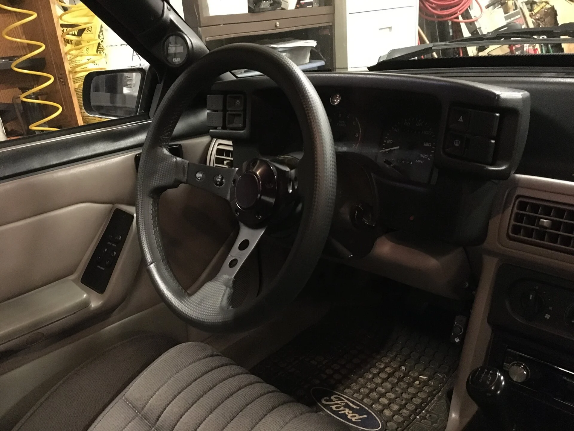

Seats might have something to do with it. In my 93 Convertible with the fake leather seats and airbag wheel I don’t have the problem. However it was different in the 92 LX with cloth seats. Solved that with a tilt column from an 89 and an aftermarket wheel.
