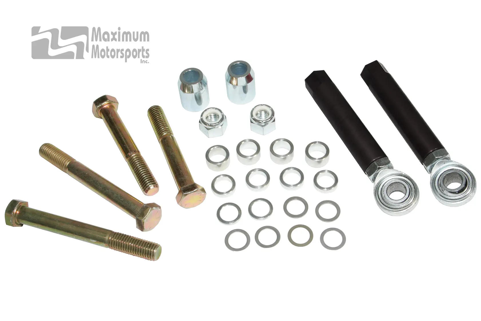

What about a through bolt bump steer kit and putting the tie rod ends on top of the spindle attachment point?
I don't know if that can be done. I would think Max Motorsports would have thought of that if that was able to be done safely.
Flipping that around and mounting the tie rod on top? Would need to be mocked up to see what potential interference issues there would be.
:shrug:

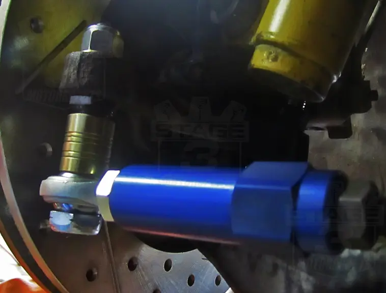

Was just thinking that if a person put the 96+ spindles on a factory k-member Fox it might work on the top as it appears it would be correct by this picture:
I don't think it would work with factory tie rods but with the heim joints on the bump steer kits it might work but you would have to have the bolt through bumpsteer kit like this:

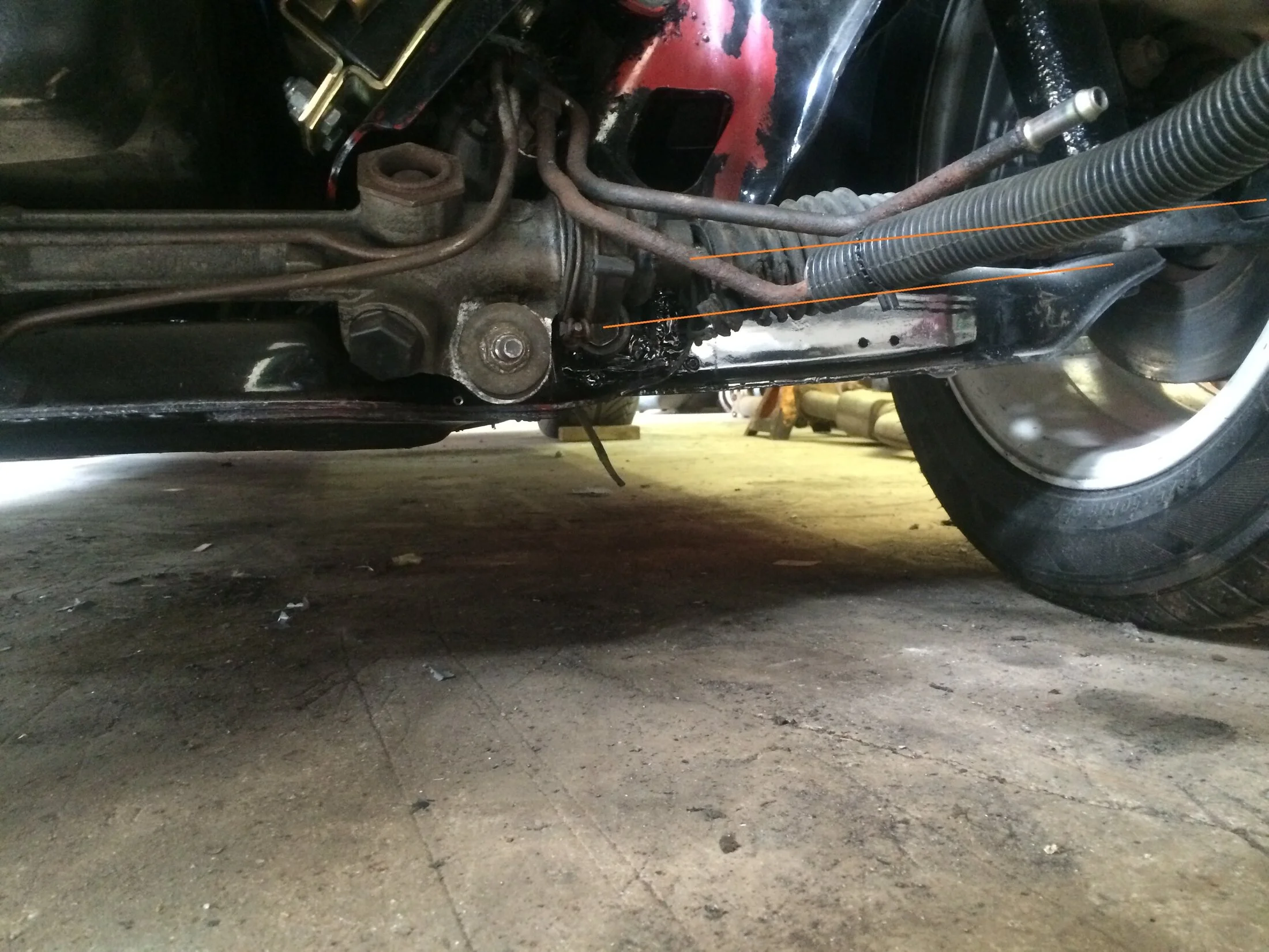

When thinking bumpsteer you are shooting for two parallel lines. Pic shows the two lines you are looking for. One from pivot point of LCA to pivot center of the ball joint. The second from pivot point of the inner tie rod to pivot point of the outer tie rod. Theoretically perfect bumpsteer would have these lines perfectly parallel and the distances exactly the same between the pivot points (something I think is not possible on a fox without building a completely custom setup).
Moving my control arm mount points up (away from the ground) 0.5" and using offset rack bushings to lower rack (closer to the ground) about 0.5" gives me the 1" change that is needed to run 96+ spindles. I have stock fox rack, inner and outer tie rods and lower control arms (don't remember if I have stock ball joint or SN95).
If you can't relocate the control arms up, doing just the offset rack bushings will help versus stock rack bushings and 96+ spindles.
