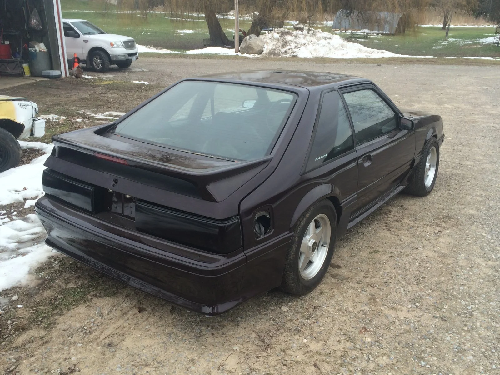

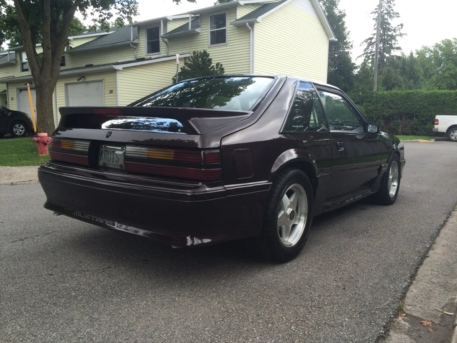

I tried SN95 tubular lca's on a fox modified OEM k-member (I did the Mathis lca relocation mod) and found they were too long. My rims are 16x8 with a 0 or +8 offset. It is a little hard to see in these pics, but if you look at tire to fender lip clearance you can see the difference.
IMG_1063.webp SN95 lca's
IMG_1447.webp fox lca's
